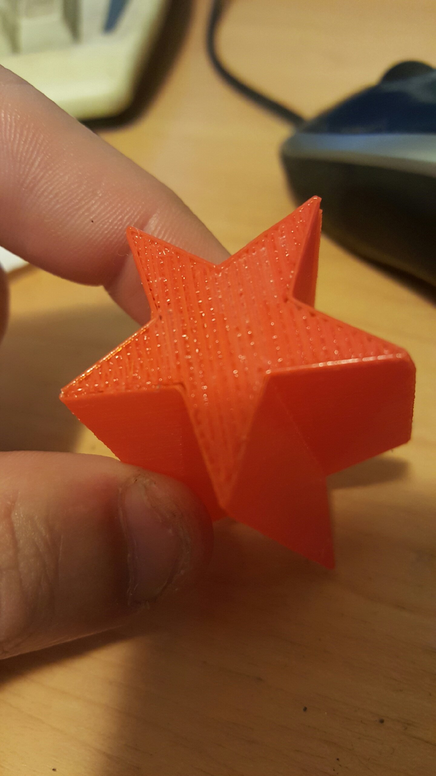

The printer i am using is a Prusa i3, sorry i should have mentioned this in my original post. i think i have found the problem, i took a straight edge and started checking to see if the bed was warped, because the issue always fell around the same area of the print, well it indeed was. There was a high spot in that area which caused each layer to “thin” out. I ended up putting a piece of glass on the bed to level it. On a side note i would still like to get the top layer looking a little better, maybe it is just me, but i dont like the way they are turning out. I have changed infill amounts, top layer amounts, tried line, rectilinear, concentric, just about everything i can think of. Here is a picture of a different print, but you can kind of see how there are gaps in the top layer, no matter what fill % i set it at the lines are never close enough to create a solid layer.
For large flat bottoms, the problem usually is that the first layer does not stick to the printbed properly and/or gets warped during the print.
That is one of the most frustrating parts of 3D printing! I feel your pain- we’ve had that happen to us. When it comes to printing larger parts, the chance for warping or uneven layers increases when more of the print’s surface touches the print plate. If you can orient the product so that it can be printed with as little surface area touching the build plate as possible that will help immensely.

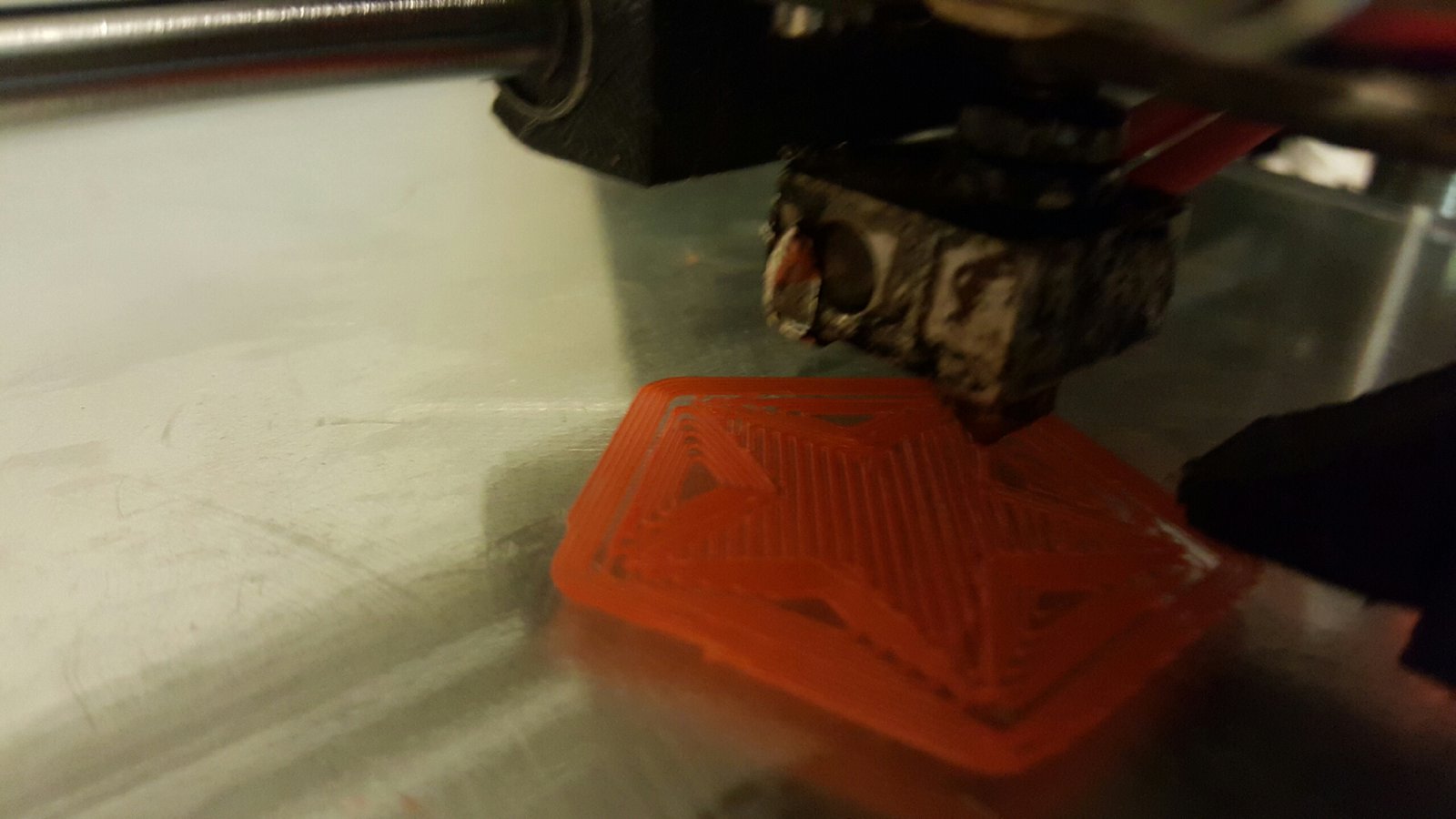

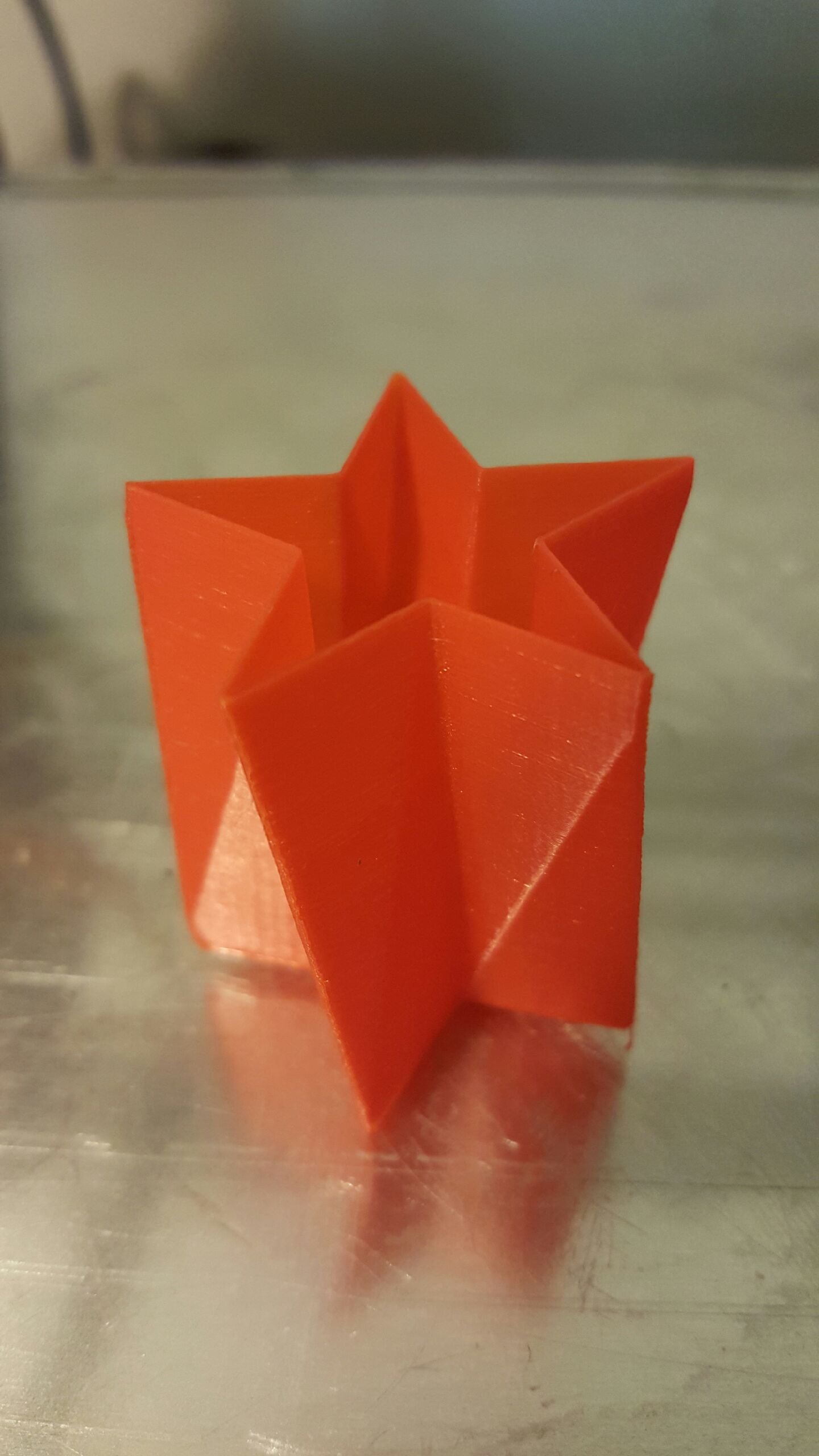

Ok so another question, is it possible to print a single wall object, like a vase, with a 100% infill base? I am using slic3r and pronterface
yeah, for an object like a vase you should use infill 0% and num loops 1
