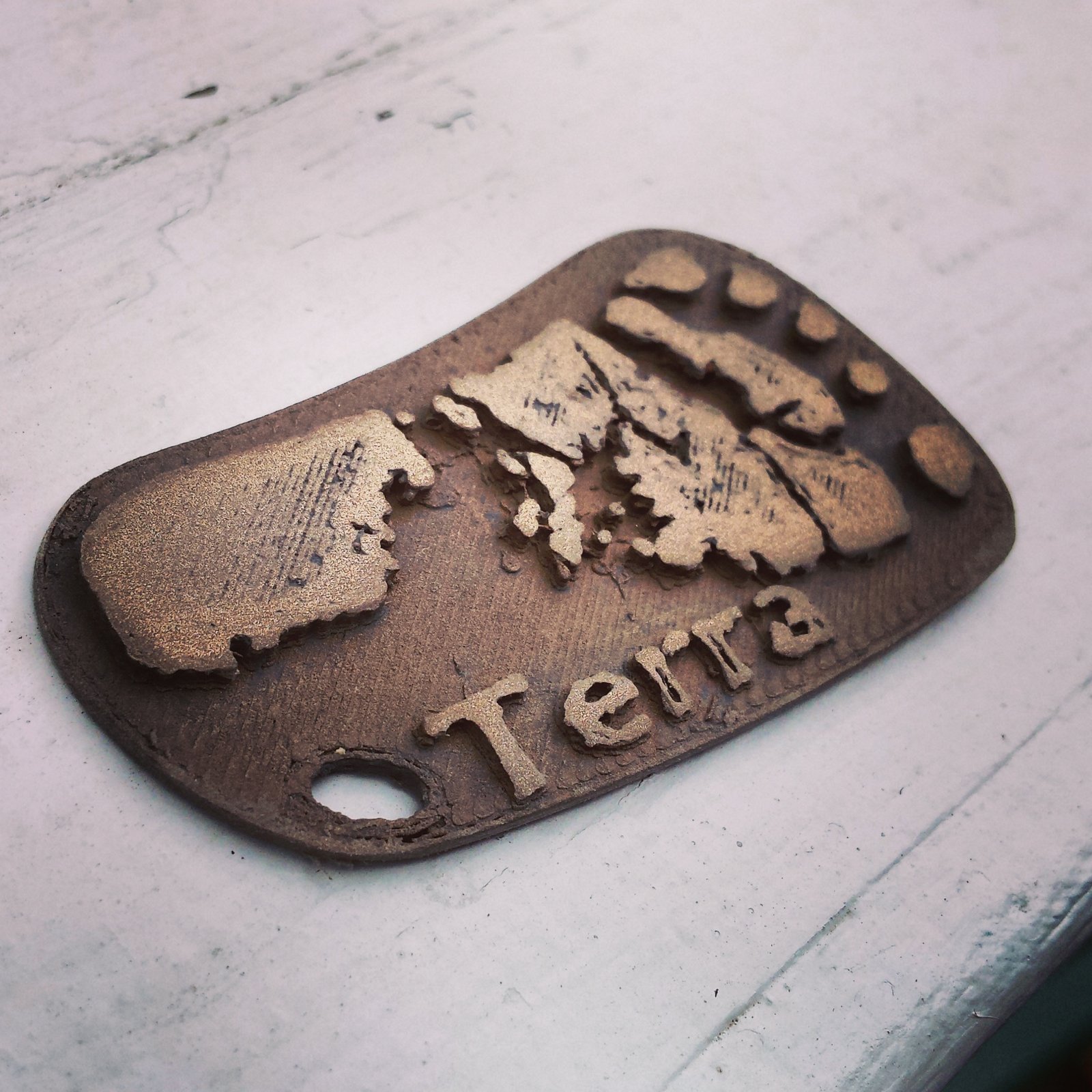

So you can try and do something following tutorial, or contact AtomJaay to help you out if you like, or you can drop by my HUB and we can talk some more. I can make you lovely keepsake wall 3D picture of baby’s foot printed and polished in bronzefill or copperfill.

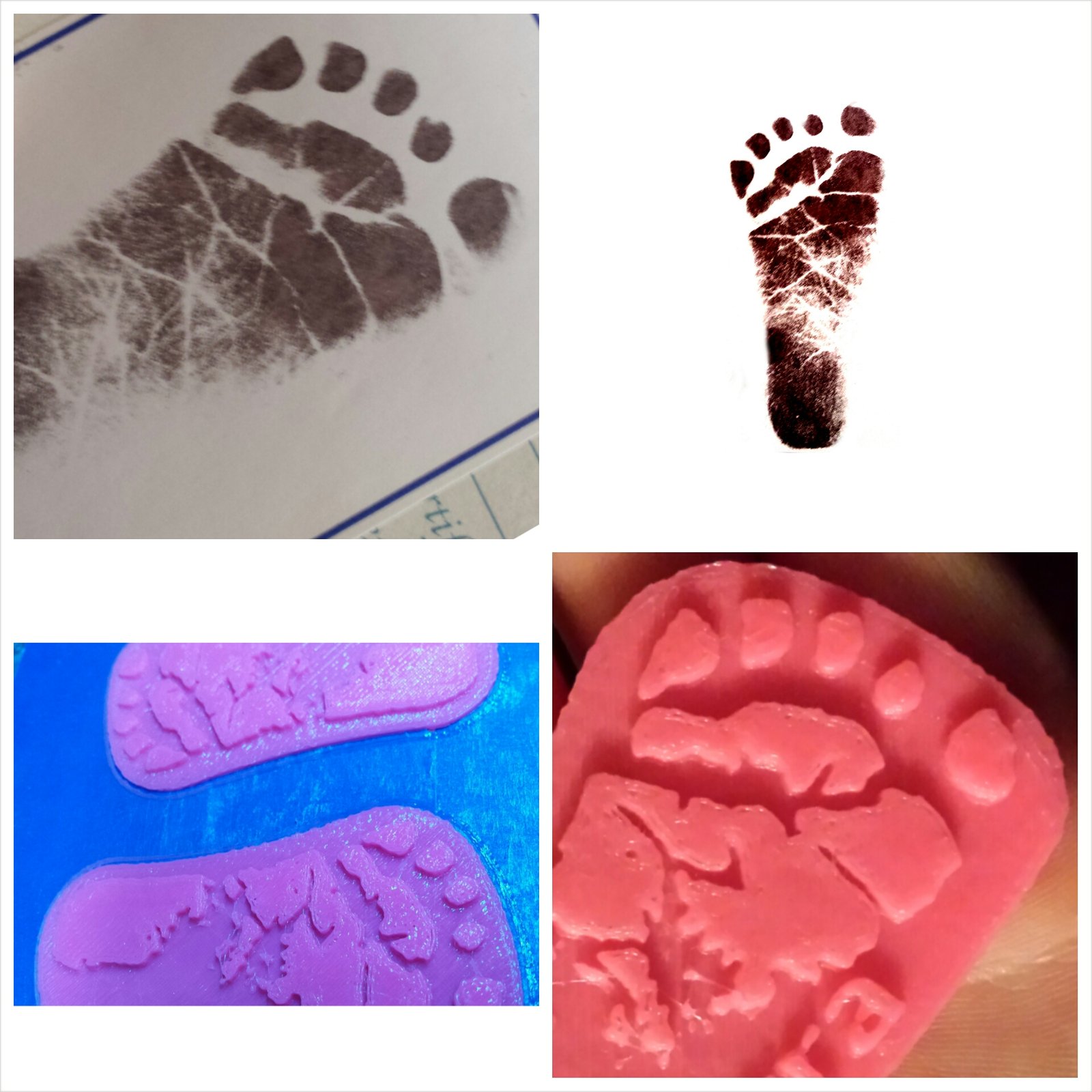

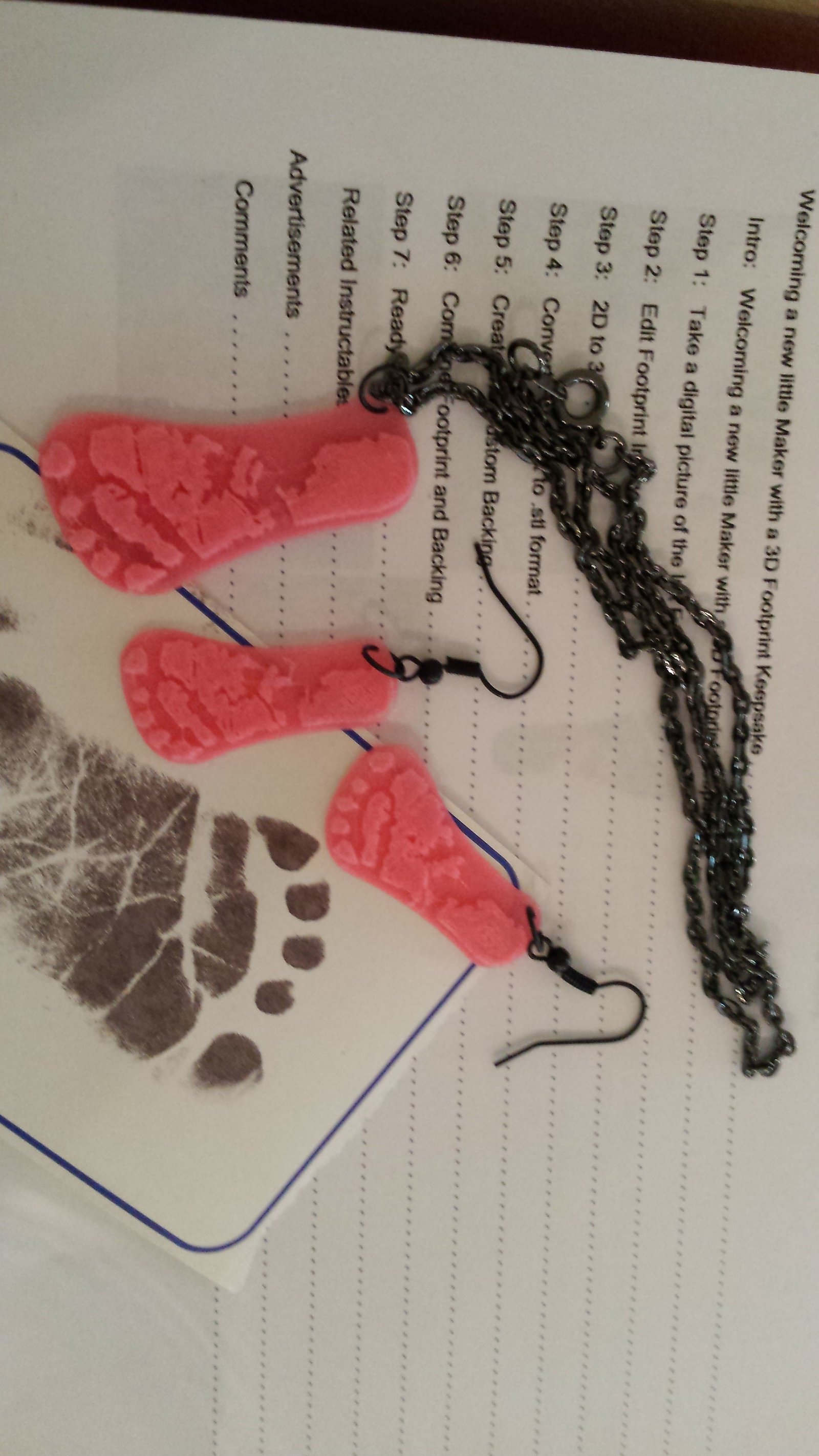

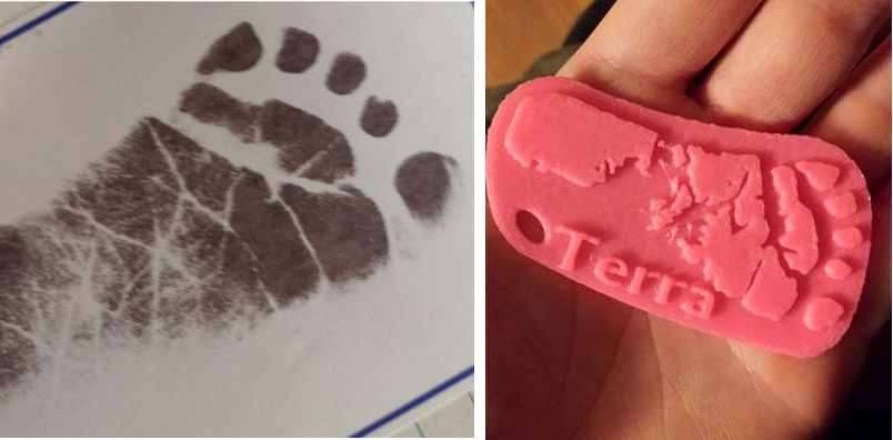

I can absolutely help. http://www.instructables.com/id/Welcoming-a-new-little-Maker-with-a-3D-Footprint-K/
I made this when my daughter was born and I’ve been trying to start a dedicated service based on the process.
The files of the backing can be found here https://www.myminifactory.com/object/backing-for-3d-baby-footprint-keepsake-instructables-included-6497

The online shapeways tool I used in the instructable has an option for height based on contrast intensities.
