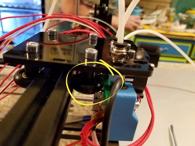

Anyone built a DIY Flsun 300x300x420mm Plus I3 3D Printer Kit with Heated Bed and Dual Extruder w\Touch screen? I am in the process and have a problem with the chimera extruder setup. In short There is no clearance for one of the guide wheels and I am still waiting to hear from Flsun. Any advise is appreciated

FLSUN sent me an stl of the mount that was supposed to (but did not) fit. I ended up using Sketchup to draw a mount and printed it on my other printer. I can send the stl to you if you have access to another printer. I have since changed to a capacatince sensor and a glass bed which i also had to draw and print the mount for.

I moved the extruded platform to the bottom of the bar.
image|500x500
I also used some plastic sheet stock to make a auto level sensor mount. But it will still work with the printed sensor mount.
