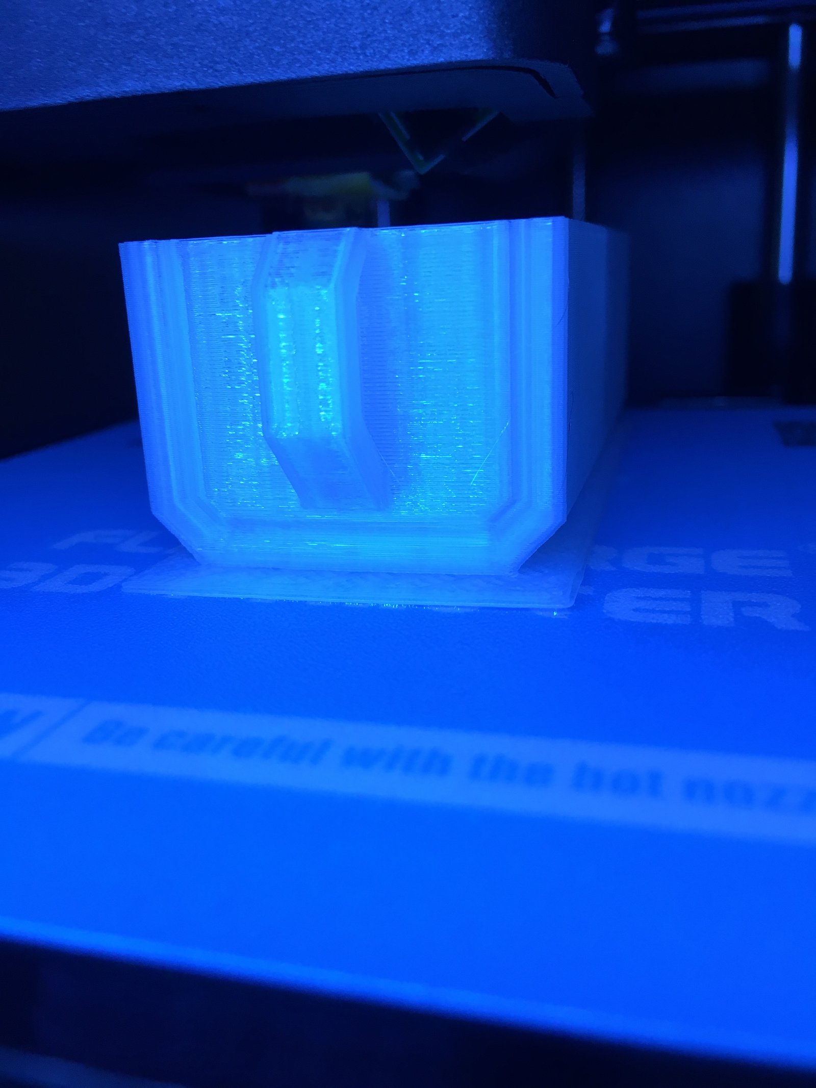

Been printing for a few years now and I just upgraded my i3 with a Flexion HT extruder to print flexible filaments. I have a picture below of a recent print, overall not bad. I’ve got 220C at 35mm/s for Ninjatek Semi-Flex filament. The print is juicy on the edges with some stringiness. I’m wondering what everyone else has for temp, speed, retraction, ooze and other settings. The top layer also doesn’t fill out all the way to the perimeter of the print … anyone have ideas???
To hot. I think I printed Semi at 210 or so but it has been a while.
Thanks, I will try to print at 210.
