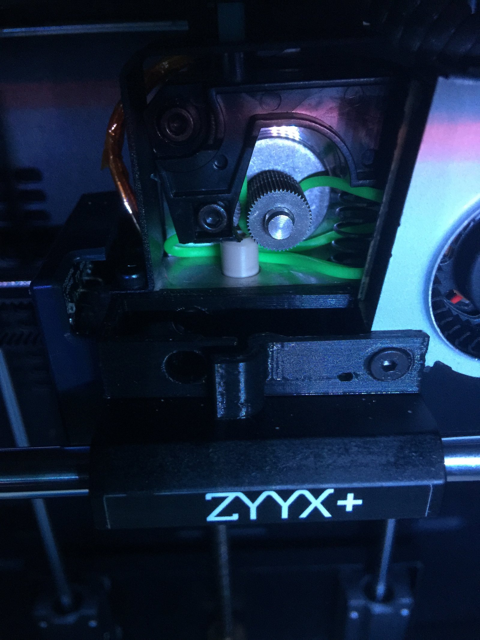

For the second print, I tried a larger 4cm ball with my website written on it (engraved). First layer was okay, but from the second or third not anymore…
The filament is curling up into the extruder, henceforth not extruding anymore… (see picture).

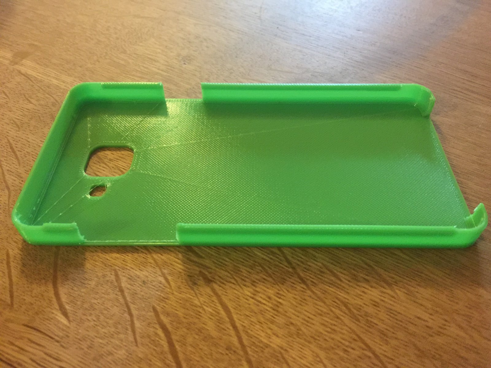

I’ve currently a print with some new settings running : no more retraction and a slightly higher temperature at 235 C (I used the base TPE settings for the ZYYX+). More than one hour in the print and so far no issues.
As it’s a smartphone case not having retraction doesn’t cause a lot of trouble, but for some other objects it might get very stringy…
Do you guys have already printed with ninjaflex on the ZYYX+ ?
I print a lot with flexible filament. For the really soft types you need the ‘soft sprint’ on your extruder.
Yes, already using it! :slight_smile:
Working quite good with the retraction turned off! Quite a lot of stringing, but easy to remove.
That’s weird. I use the normal spring without any problems with flexible materials from Shore A 45. I have the best results with Polyflex from Polymaker.
What temperature/speed/retraction are you printing ?
It worked better at higher temp without retraction but then it’s too stringy.
Will try with the higher temp but with a little retraction next week.
I use the standard TPE settings (230) and even the ‘normal’ PLA settings (210) work.
Ok, thanks, will try again with these standard settings.
