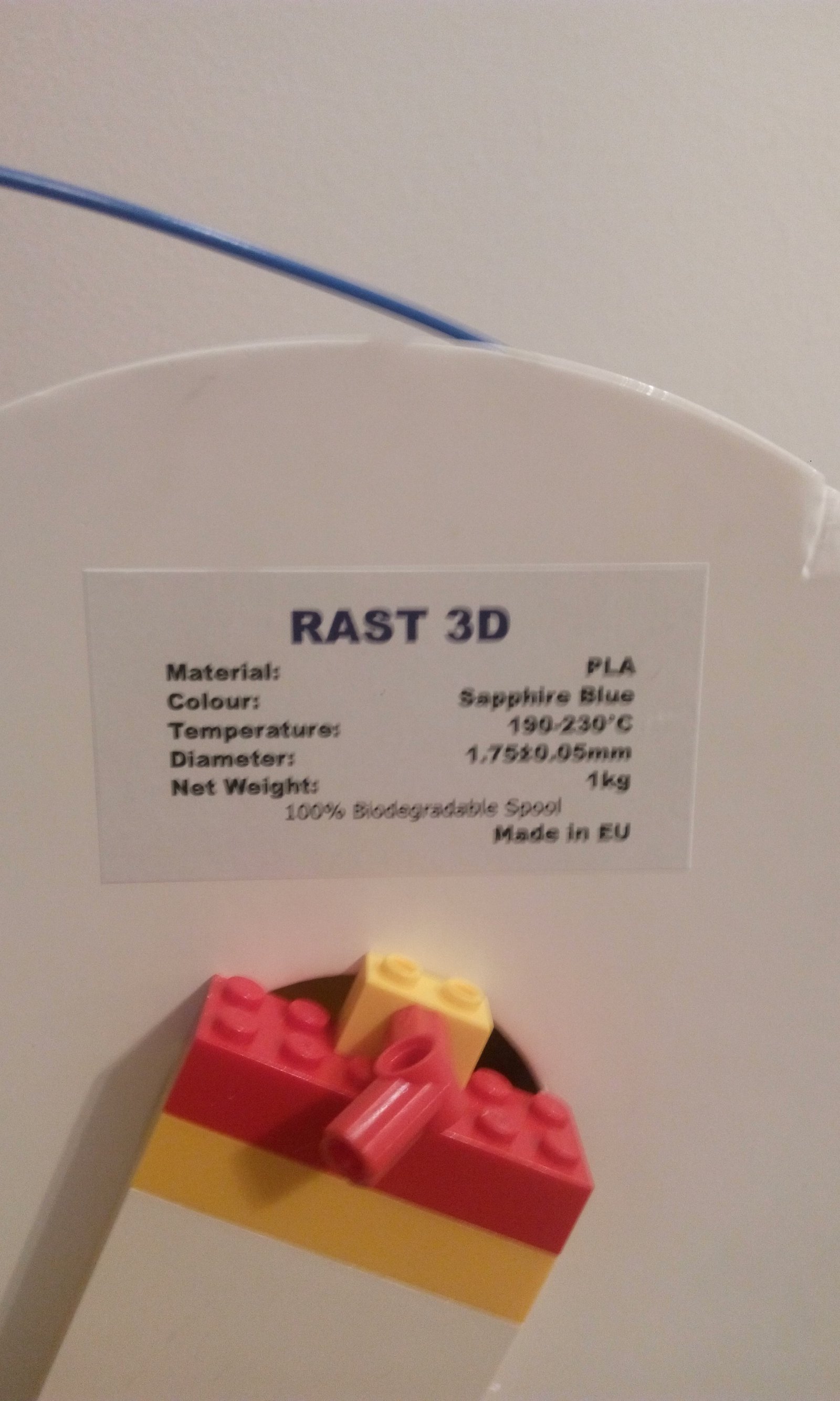

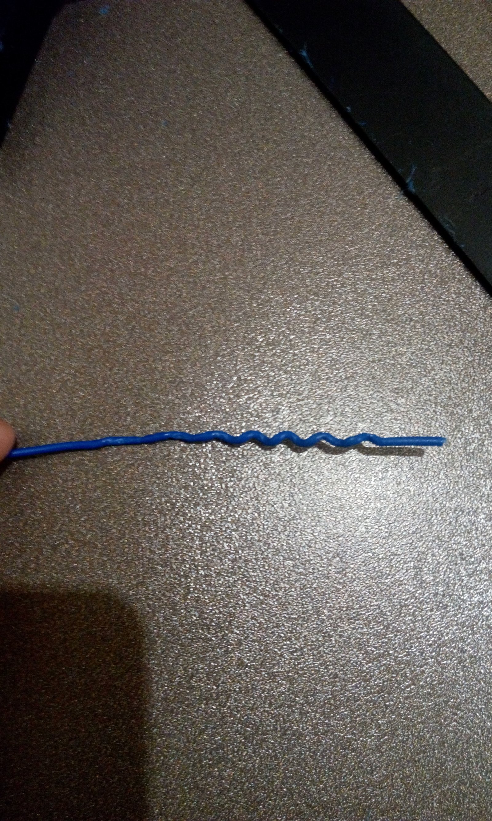

Hello, i have a probkem with my reprap and i can’t print because of it. My PLA filament is curling inside the hotend and not comming out from the nozzle. It is very hard to push it like it is not hot enough. I am extruding at 230 and nothing comes out. Can the filament be ABS not PLA. On the package it says PLA.
Heat is your problem. Heat is rising up in your hotend and melting the filament too early, making it to curl like your first picture shows. That’s also the reason that E3D Hotends (look them up) have a fan blowing at 100% at the hotend all the time. You want to have a hot zone at the bottom, and a cold zone at the top of your hotend.

Looks like the heat is passing the heatbreak up the barrel
I had the same problemin one of mine. Either clean the nozzle with cleaning filament or replace it, then try 205ish for your print temp. Pla usually had a lower print temperature. Check the recommendations for your printer to avoid this happening
The problem was really simple. I have mistaken the type thermistor in the maarlin software. Aand when it shows 200° it actually was 100°. And becuse i pushed the filament it curled.
