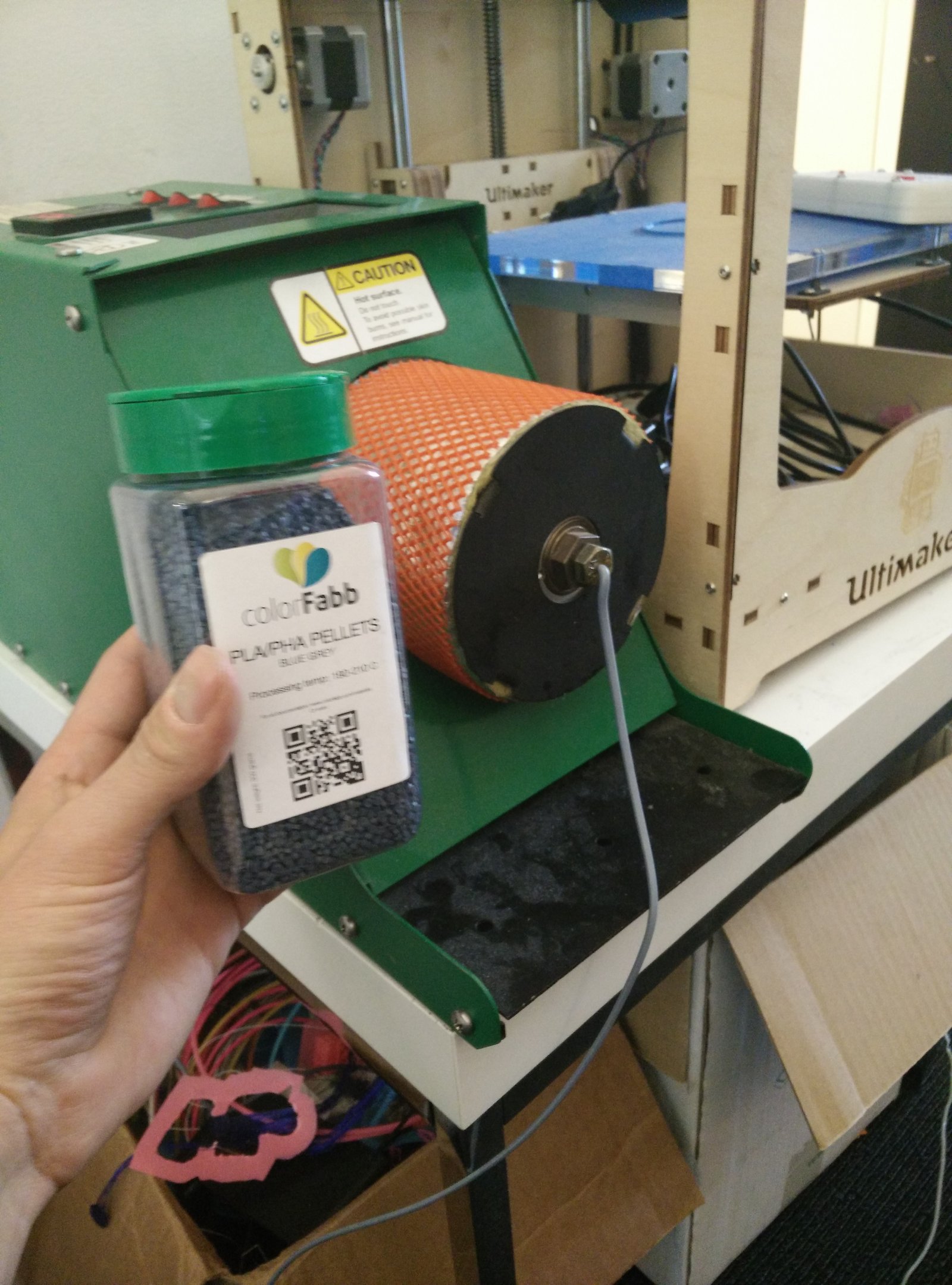

Today I worked on extruding PLA and ABS. The extruder that I will use is a Filabot original and the PLA pellets are from @.
For PLA I found the optimal temperature to be around 140 C. Setting the extruder to a higher temperature caused the filament to stretch out after coming out of the extruder and setting the extruder to lower temperatures caused the filament to curl up after exiting the extruder.
For ABS I got the best results for temperatures between 170 C and 180 C although no clear optimum was apparent. What struck me is that extruding ABS produced much thicker and consistent filament than the PLA.

P.S. You can see the box full of failed prints in the background ready to be recycled!
