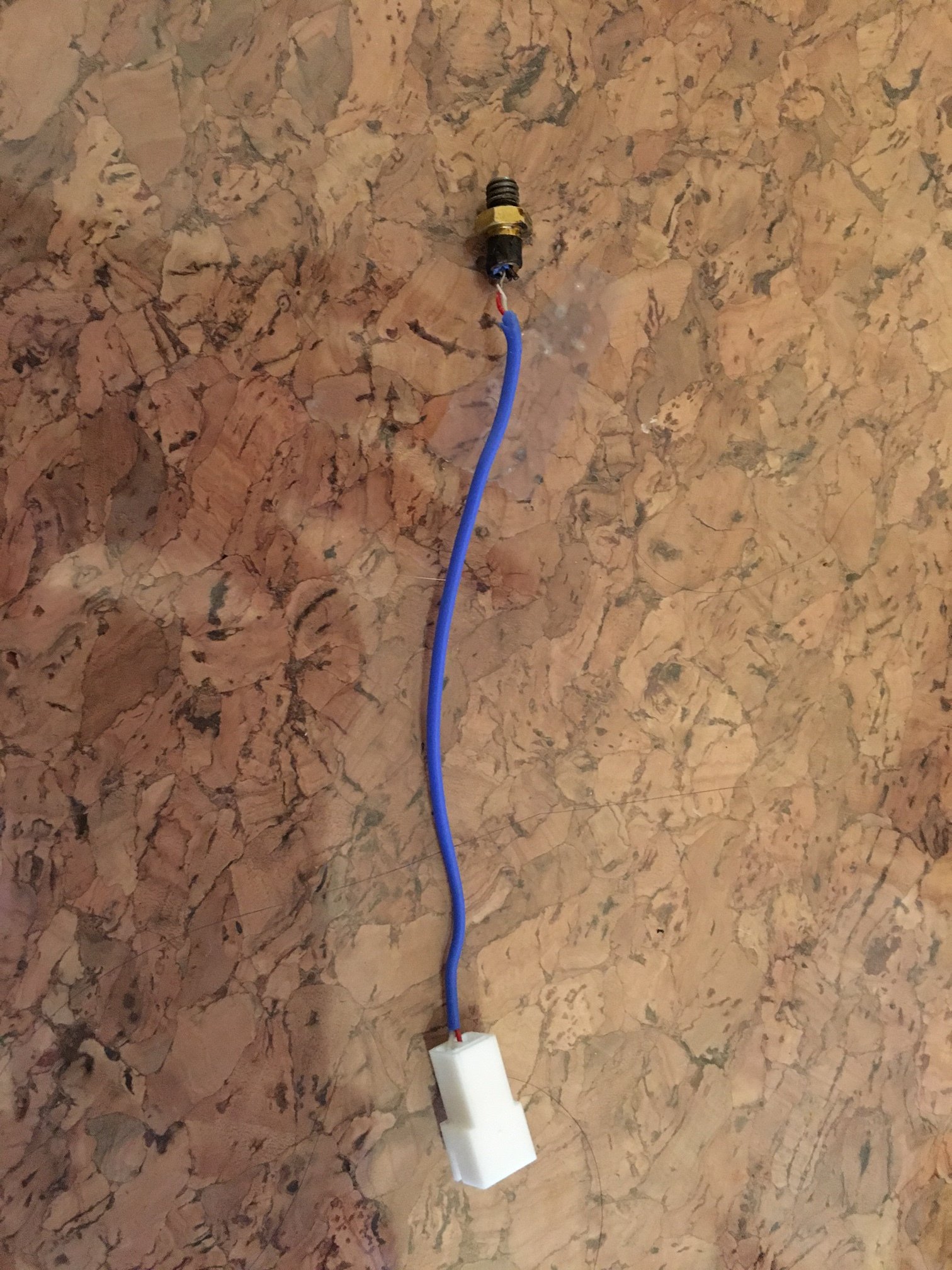

I managed to get everything put back on, but in all the taking apart/putting together of the unit, the thermistor was getting damaged. The rubber casing that covered where the wires attach to the screw was wearing out. With my final attempt to put it back together, I realized that the nozzle needed to be tightened, and when I did this I managed to shift the entire heater block enough to “crunch” the thermistor. It is now out of commission.
This is, of course, the one part that I can’t find any suitable replacement for, and I’m at a loss of how to proceed. I’ve attached a photo of the part. I can find a replacement from the FlashForge Dreamer (which I gather is *very* similar to the Idea Builder), but it lacks the plastic clip at the end: http://www.flashforge-usa.com/shop/thermocouple.html And the wire crimp attachments it has aren’t the same as the crimps on my original, so it’s not as simple as finding a new plastic clip (if I could even figure out how to do this).
Anyone have *any* ideas of how I should proceed?
Again, buying a new printer isn’t an option at this time – and I’ve invested enough time, money, and energy in this that I don’t want to just give up! I just have to figure out how to replace this thermistor and I think I’ll be back in business.
You can order parts from Dremel at 1-844-437-6533.
If the thermistor that you found at flashforge will fit, you can remove the plastic connector from your old thermistor but gently prying the plastic tabs that hold the crimp connector in the plastic housing, while the plastic is up, the crimp connector will pull out. Insert the new connectors into the plastic housing and ready to go. There are no orientation to the wires so it dos not matter which wire go where in the connector.
