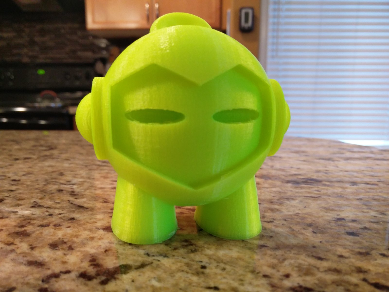

Nice line-up guys, thanks for sharing! Would be curious to see Bibo take the Marvin test
Thanks so much for your messages. One of my customers took the Marvin test. Please kindly check it as below:

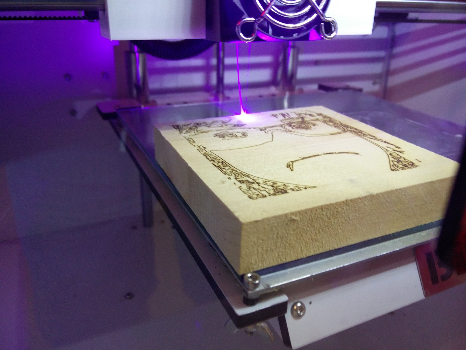

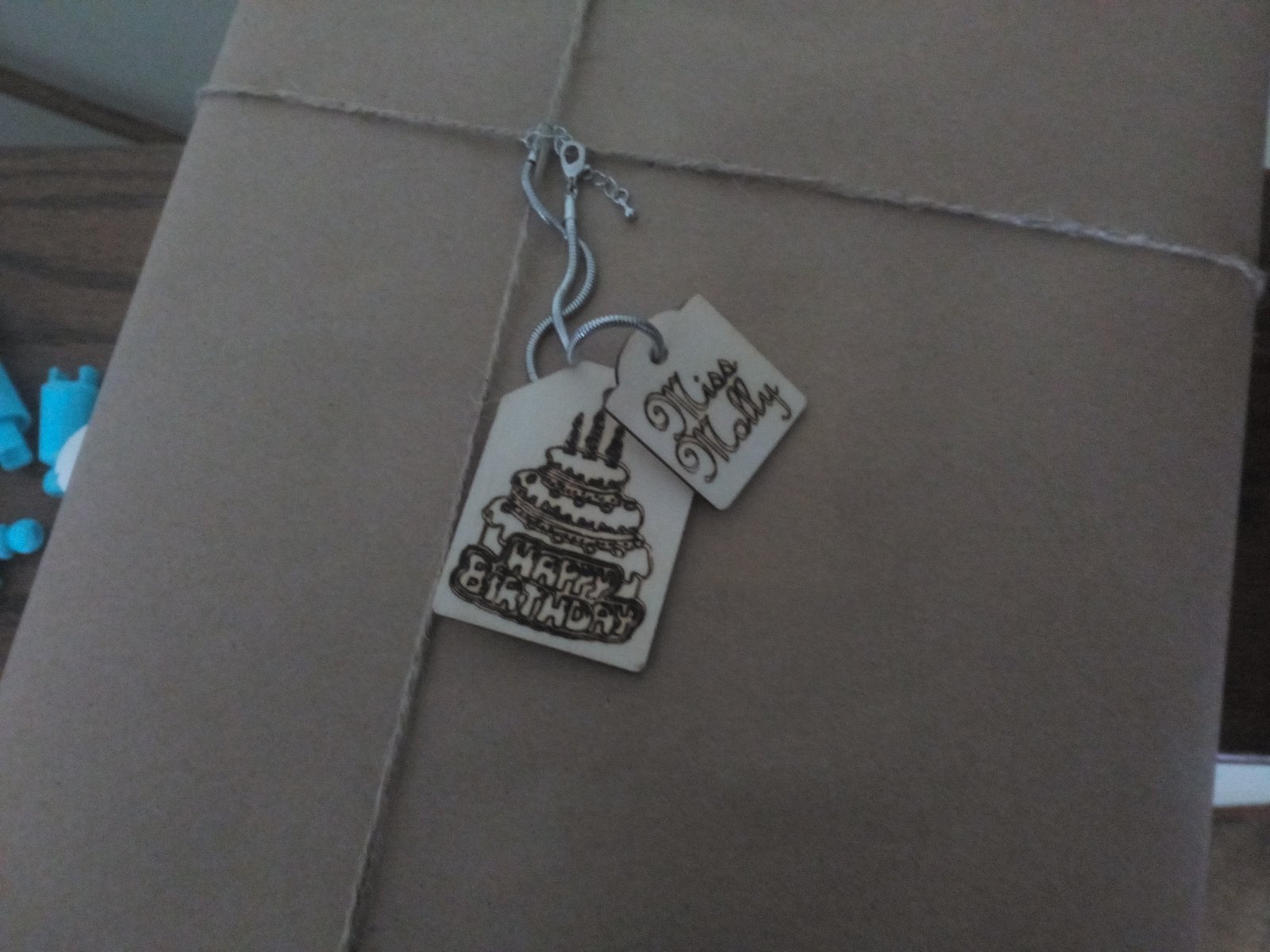

Yes, i bought a BIBO2 touch X laser from BIBO 3D aliexpress online store. It has touch screen, wifi, laser engraving function. The frame is simillar to ultimaker, and the structure is simillar to Makerbot replicator, but much cheaper, from 889USD to 1146.75 USD with free shipping by Fedex International priority service, take about 1-3 days to arrive at your hand. I always print two same objects at the same time with BIBO’s dual extruders, which BIBO names “copy printing” function. This function saves my time at least in half. The laser engraving function is also very interesting. I engraved the photoes on wood to make gifts to my children. It saves a lot of money comparing to buy another laser engraving machine.

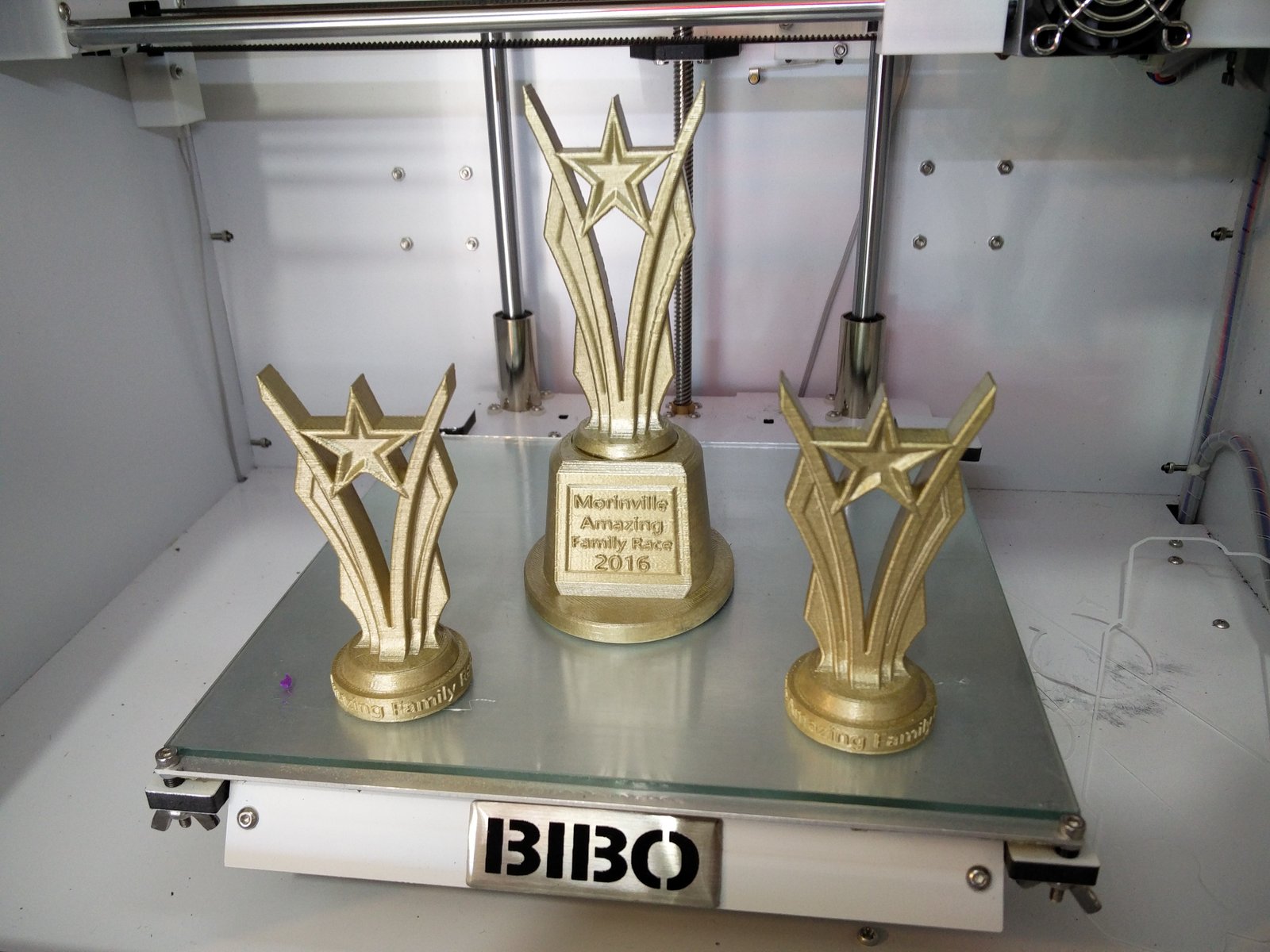

I found the price to be reasonable, the support to be fantastic and printing to be fair for the overall value of the machine. Would love to see more of these out there. I have posted a few pictures from things I have printed on my BIBO2 Touch.

I am using Simplify3D for the laser and for the 3D printer, just for the laser I force the Z axis to the proper focal point and then disable.
