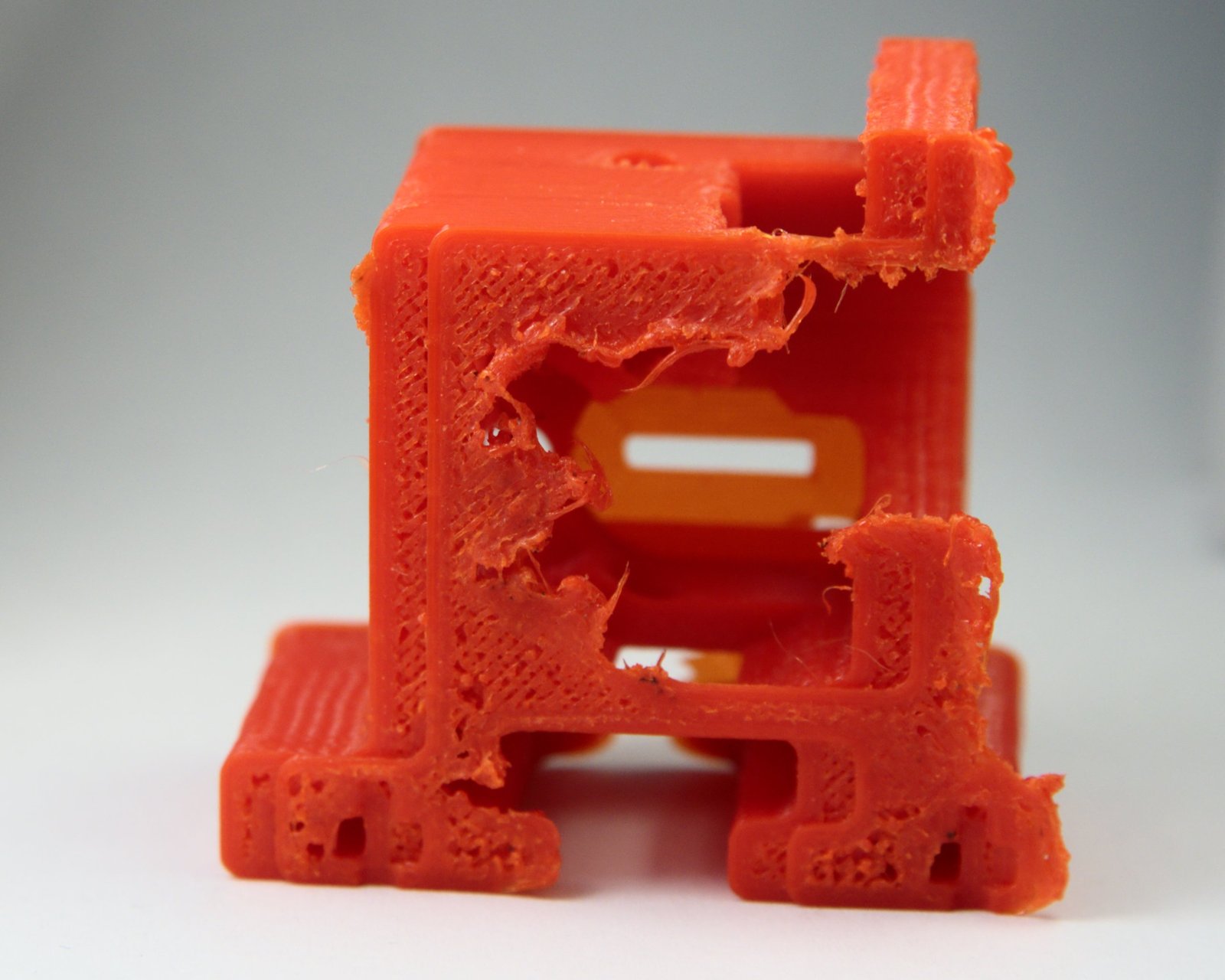

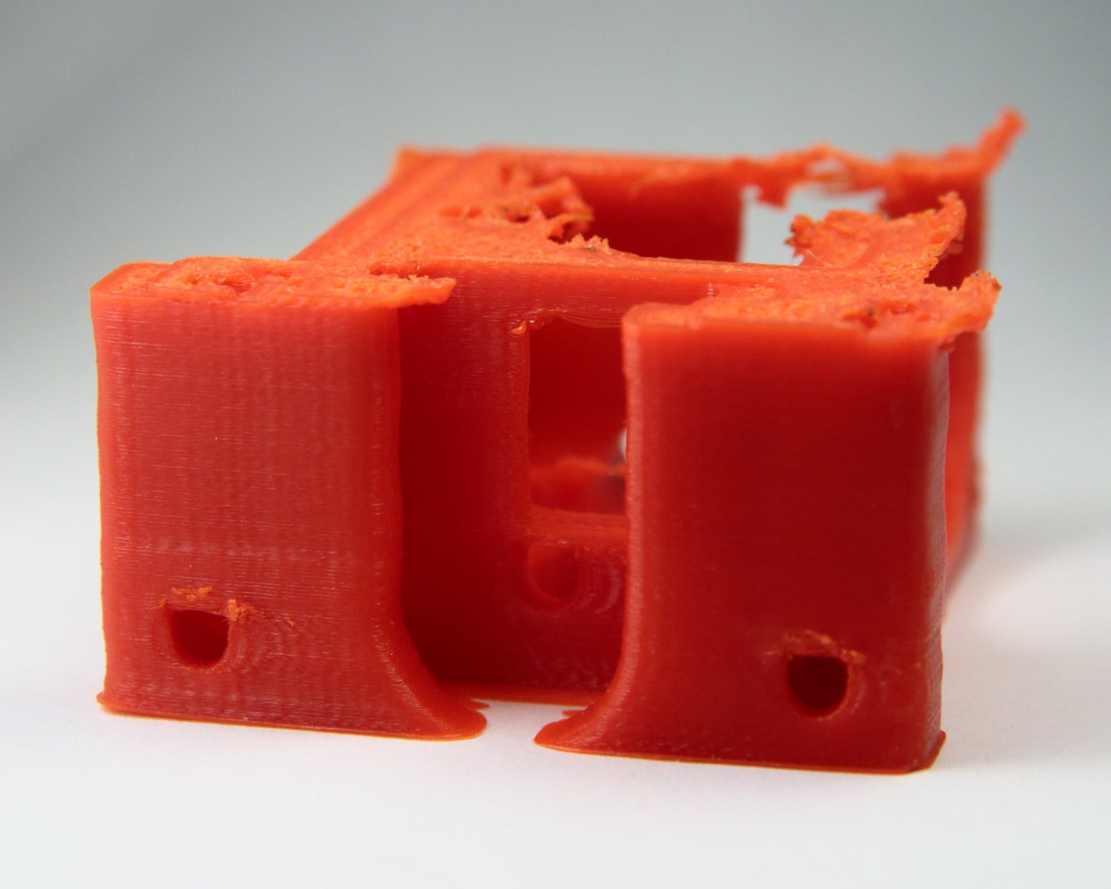

Hi anyone who’s still left on this thing, newbie question: I am getting beautiful results with Colorfabb XT when there are no overhangs / bridges; however, things turn ugly when trying to print something that includes bridges and / or overhangs (say, Marvin’s underside, or an Urchin extruder body).

Meh, I should have included more info, but I was too sleepy… Also attaching a few nice photos of my last failure (it failed due to other reasons, most likely Y driver overheat - it was supposed to look like this: https://github.com/zbysniew/Urchin/blob/master/stls/64\_01\_01\_b01\_urchin\_chassis.stl).

250 deg. C hotend, 70 deg. C bed covered with Kapton, the last one was 0.1mm layers and 40mm/s shells, 60mm/s infill; the infill looks bad, so I guess 60mm/s is too much.
