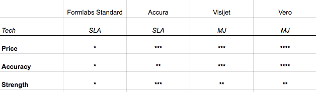

I’m working on a comparison sheet for designers for several SLA and Multi-jetting materials (machines). I’m especially interested in how they differ in terms of specs and what that means for their application. From that I then try to understand which materials are actually competing with each other and how they should be grouped.
I’ve found this to be harder then it sounds as the internet is flooded with promotional material and very few actual comparison data.
For this example, let’s assume we take Desktop SLA (say Formlabs Standard Resin, let’s go for white), industrial SLA (say 3D Systems Accura Xtreme White), Multi-jetting (3D Systems Visijet RW), and Polyjet (Stratasys Vero White).
I’d love to know how a designer would go about differentiating these solutions. Is this even the right grouping or is it already off?
One (highly simplified) way of looking at it is as this:
Not sure if this data is very accurate but I’m mainly interested if this is actually a comparison one can make. Would love to get some expert feedback / input on this.

The object properties are so intrinsically linked to the machine as well as the starting material. I think it would be easier if you instead tried to map the object properties you can achieve with each material/machine combination, for example tensile strength, toughness, hardness, elongation to break etc. This all depend on geometry and build orientation, but you can give an average/maximum/minimum as you choose. Previous posters have already pointed out there is ambiguity in the term “accuracy”. You might also want to include some non-numerical categories, such as what post-processing is necessary.
