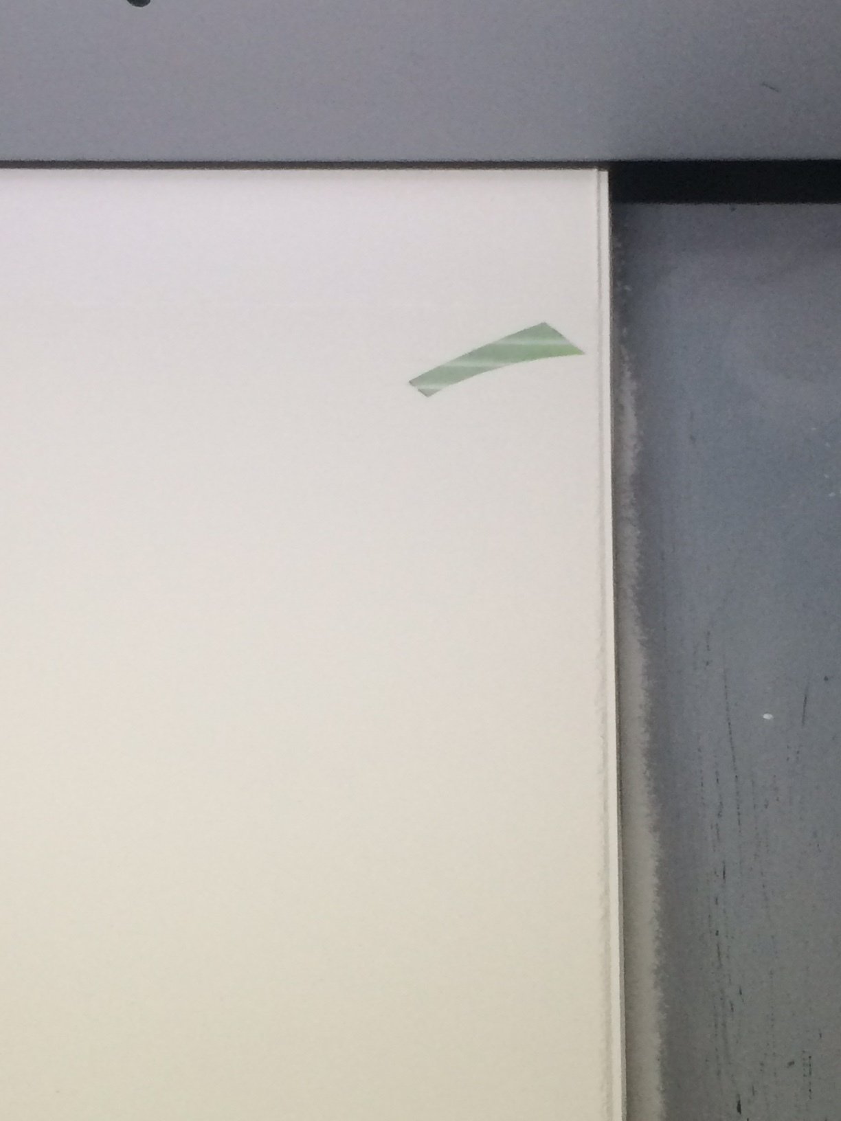

Please see images to give you an idea of the striping problems we have, not the part is supposed to be all green but has yellow/white striping throughout, at equal intervals. (its a small part but essentially this is what happening throughout all of our parts on every layer, for any colour). Would greatly appreciate if you have any more suggestions.
