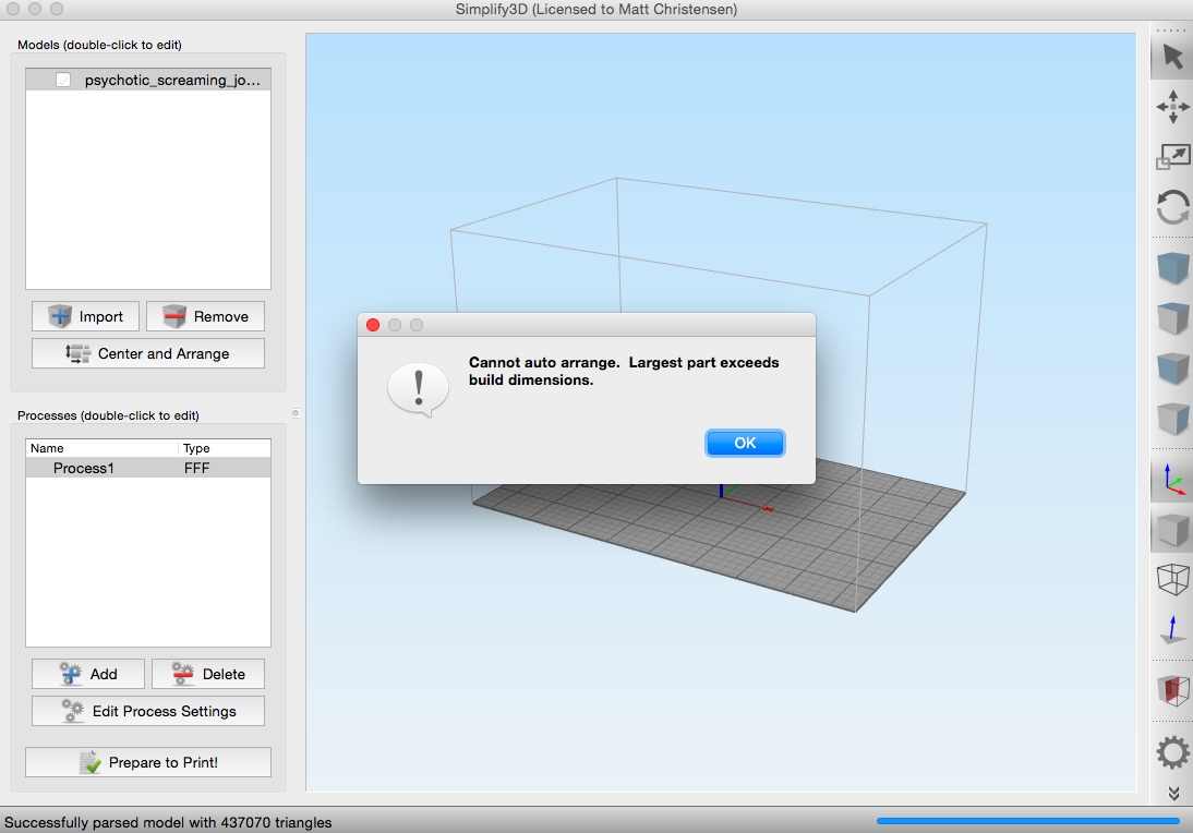

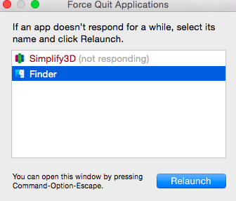

I just purchased the Simplify software less than an hour ago. It’s already crashed on me five times, and I keep getting an error message that says “Cannot auto-arrange. Largest part exceeds build dimensions.” whenever I try to import a model. All of the models I’m trying to import have been printed before on my printer with SLIC3R, and with no problems - the most recent one is only about 3 inches high, and 3 inches wide, and 3 inches deep, if that. I wanted to get Simplify to up my game a little bit, and play around with the vast options. The program crashes when I attempt to “Center and arrange” the models manually. I get the rainbow wheel (I’m on a MAC), and then have to Force Quit. I’d like to know what the problem is.
I’ve attached screengrabs of what I was able to capture regarding these problems. If anyone can offer any help, I’d really appreciate it. This is frustrating.
Have you set the Simplify3D scaling to millimeters or inches? (switch to millimeters). If you select OK on the error message the model should still be imported, then you’d have to scale it to the proper size to make it printable. The rotation tool and other “unprecise” tools can be accessed by clicking with the left or right mouse button while holding down crtl or alt. If you double-click the model there should be a window popping up on the right hand side which enables you to dial in precise coordinates, scaling factors and rotation values.
