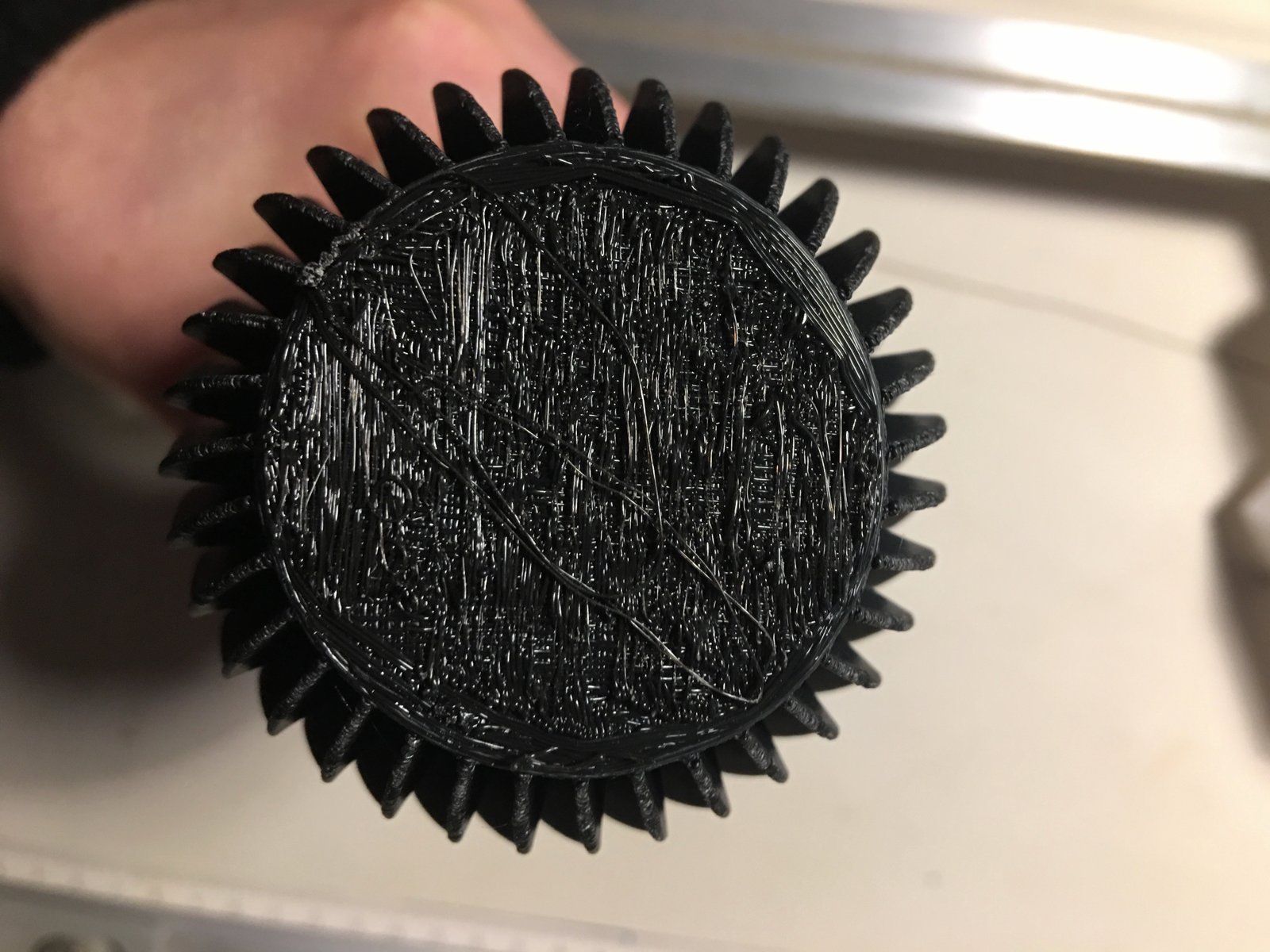

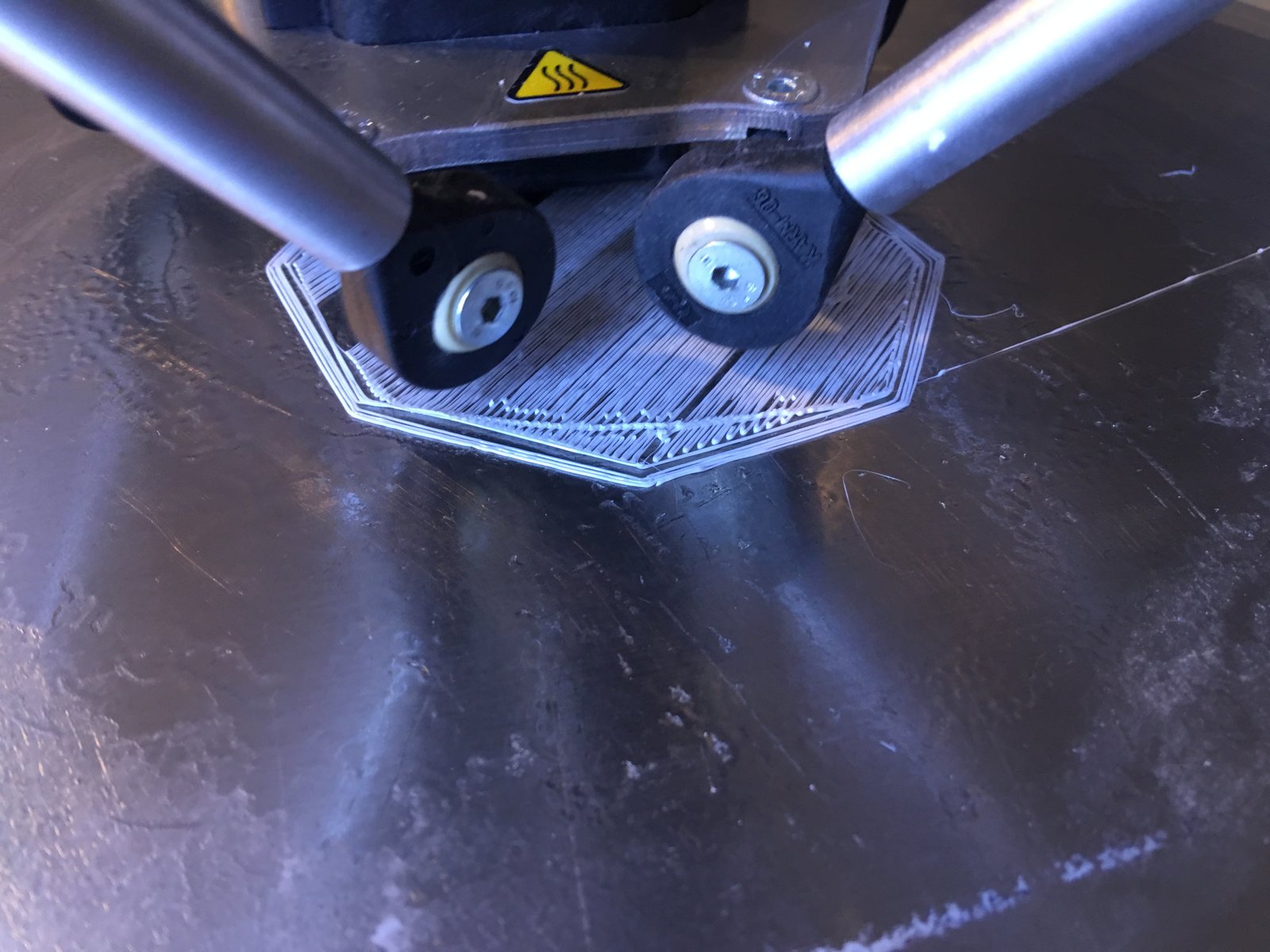

Since I have got my Wasp Delta 2040 Turbo, I cannot seem to sort out a good base of the model with Cura.
I have tried to play/change the speed, initial layer line width, cooling etc.

I don’t have a Delta but my first thought is the first layer height is to much by looking at pic 1. Also what is the adhesion method for the bed? Glue, hairspary?
Your print head is not close enough to your bed. You need some squish there in your first layer.
Or you can mess with the thickness of the first layer in your slicer settings.
That’s what I meant! I guess I needed to word it better!
