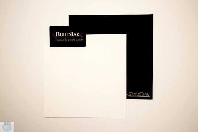

BuildTak
Price: $4.00 to $21.00 depending on size and quality
Specs:
4.5″ x 4.5″ (114*114), 6.5″ x 6.5″ (165*165), 6.5″ Diameter (165Dia), 5.83″ x 7.95″ (202*148), 8″ x 8″ (203*203), 8″ Diameter (203DIA), 6.25″ x 9.25″ (159*235), 6.5″ x 10″ (165*254), 6.5″ x 11.5″ (165*292), 8″ x 10″ (203*254), 9″ x 10″ (228*254), 10″ x 10″ (254*254), 12″ x 12″ (304*304), 12″ Diameter (304Dia), 16″ x 16″ (406*406)

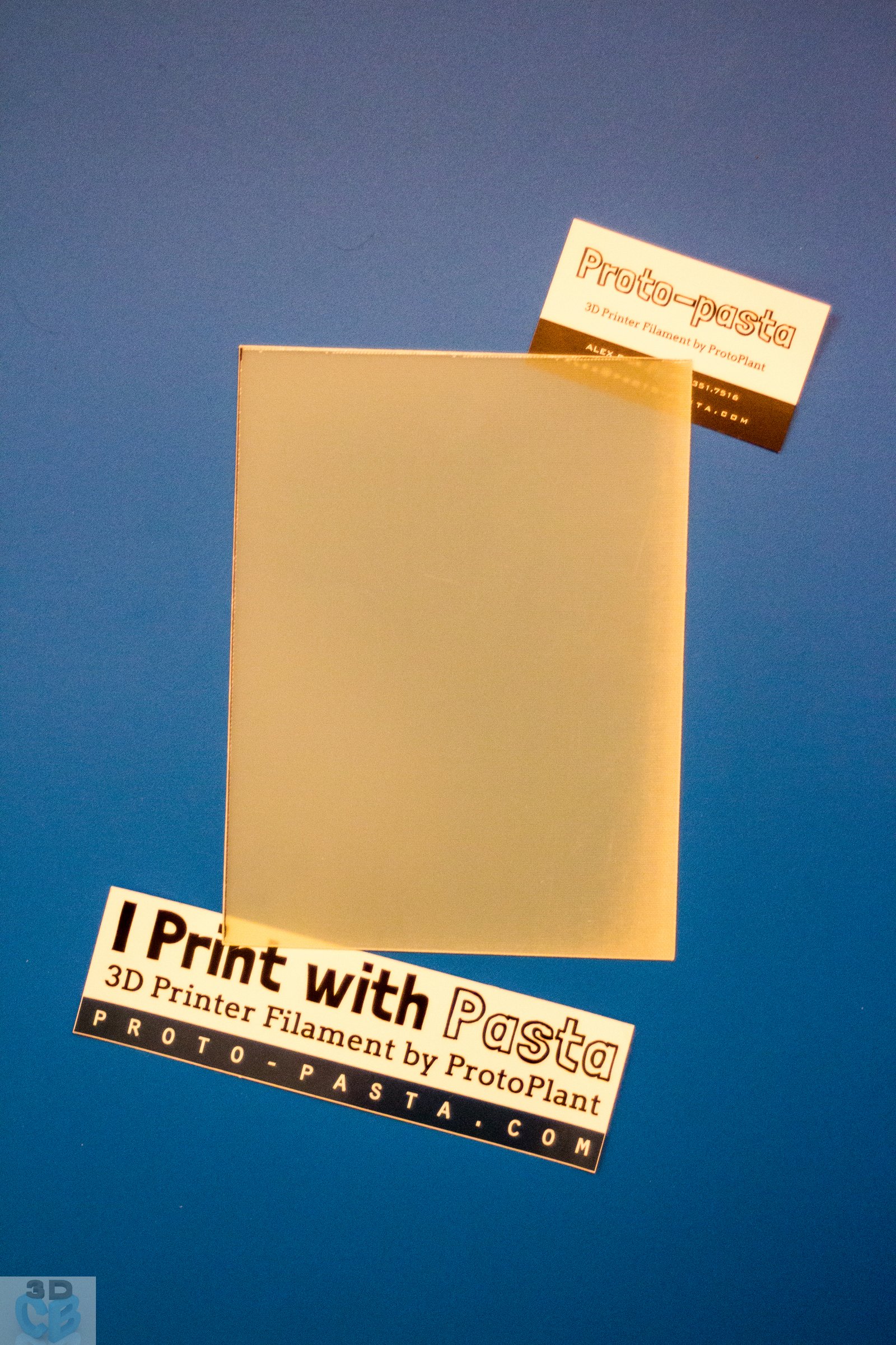

Proto-Pasta
Price: $33.00
Specs: *Cut upon order*
Removal of Print link here: Proto-Pasta's New Build Plate - YouTube
I would like to start by saying even though these 3 products help your print adhere to the bed of your printer I would have to put BuildTak in its own category based off the thickness and use of the product. A characteristic that all 3 products have is that you can use the same build plate for ABS, PLA, and composites without a problem.

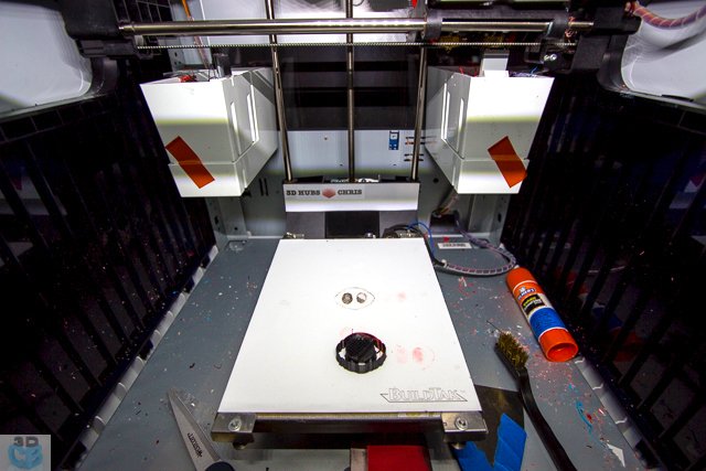

BuildTak is a thin sheet with adhesive on one side to allow it to stick to your bed. BuildTak is also very easily be cut with scissors or an Exacto Knife. BuildTak works very well but can cause an issue if you calibrate you printer to close to the bed. If you do you will have a VERY hard time getting your print off the bed. Unlike the other products BuildTak does not last as long and cannot be removed and reapplied like Proto-Pasta and Fleks3d’s products meaning the money you save on BuildTak you spend resupplying your stock which is also why they sell in packets. No it’s not like Stratasys build plates that are one and done but if you do daily prints you will have to replace every couple weeks. A great feature to this system is it allows you to use heat which is important for ABS prints.

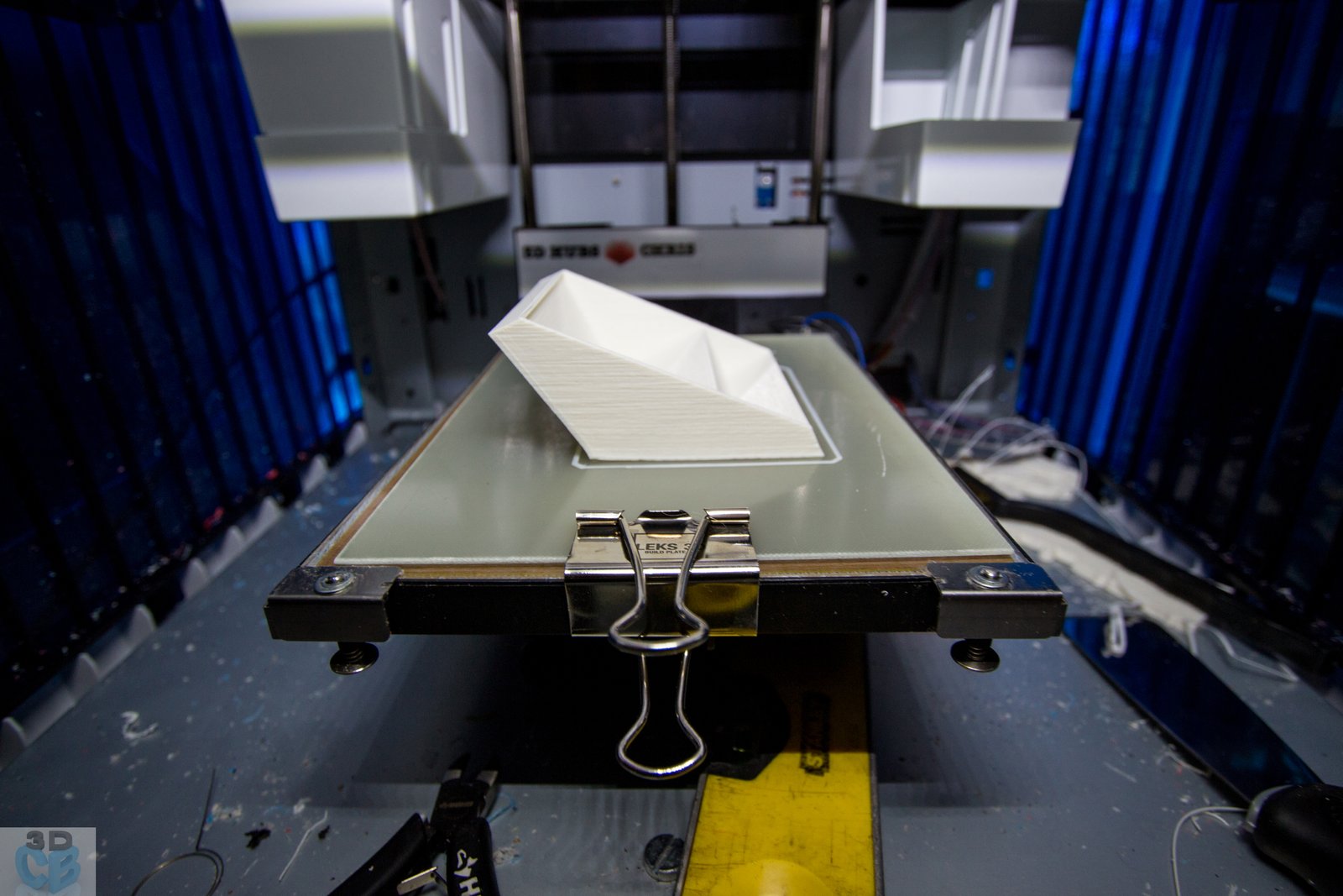

Proto-Pasta’s newly released build plate has many similarities to Fleks3d, both are a thin plastic-like sheets that that are directly applied to your build plate which can be fastened on with binder clips and allow the user to pop the print off with a single bend of the plate but they start to differ from there. Proto-Pasta’s build plate allows you to print with heat applied on your bed, for example if you are using a stock XYZPrinting Da Vinci you cannot turn the heated bed off, Proto-Pasta’s plate will not warp due to the heat like Fleks3d will. Another difference I have noticed is that with Proto-Pasta’s plate they ask that you still use your favorite adhesion method, whether tape, glue stick, or Kapton tape where Fleks3d doesn’t require any extra adhesion. As seen on Proto-Pasta’s site they actually applied BuildTak to their build plate and were able to pop the print off their bed with little effort. Which does make a good combination!
