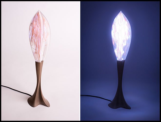

I finished my full size Bronzefill lamp this weekend - 41 cm tall!
Printing details
Printed on an Ultimaker 2
Material: @ColorFabb’s Bronzefill and XT Clear
Layer Height: .1mm
Wall Thickness: 1.2mm
Fill: 20%
Speed: 50mm/s
Print Time: 9 hours
The top is Printed separately in Colorfabb XT Clear
Layer Height: .3mm
Temp: 230c
Wall Thickness: Spiralize the outer contour selected in Cura
Speed: 25mm/s
Print Time: 1.5 Hours
Lights are from here.
See you guys at the NYC workshop tomorrow!

Nice work, Christopher, the lamp looks seriously awesome!
I second that emotion! Very cool design!
Very cool Christopher!
That’s a lovely design Christoper. Not often I like a design enough to want one but this case is an exception!
Cheers!

Great! How has you polished the bronzefill?
This is fantastic!! Beautiful design
