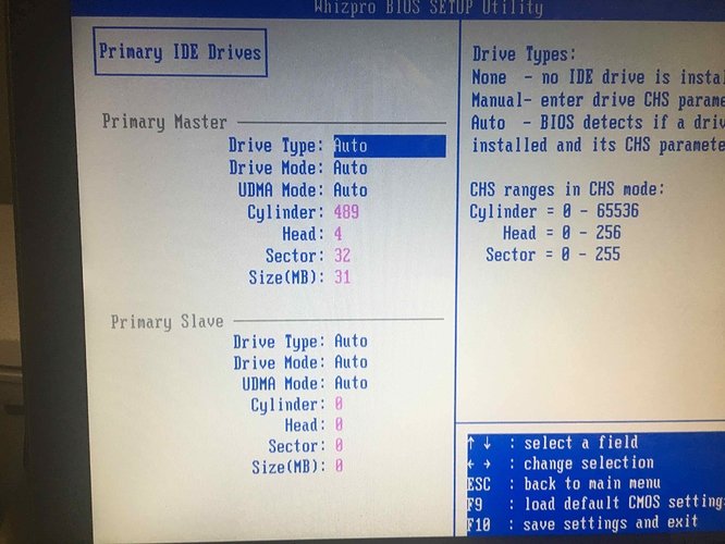

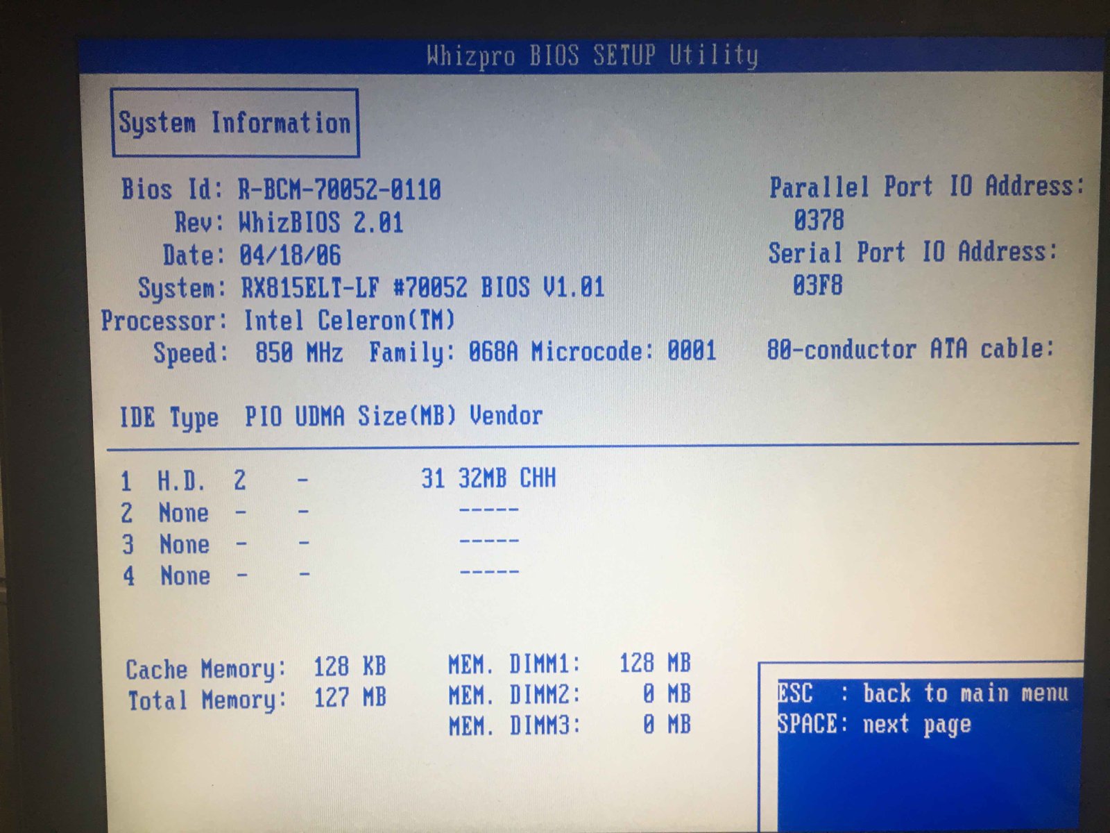

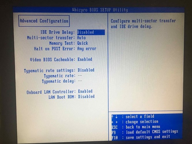

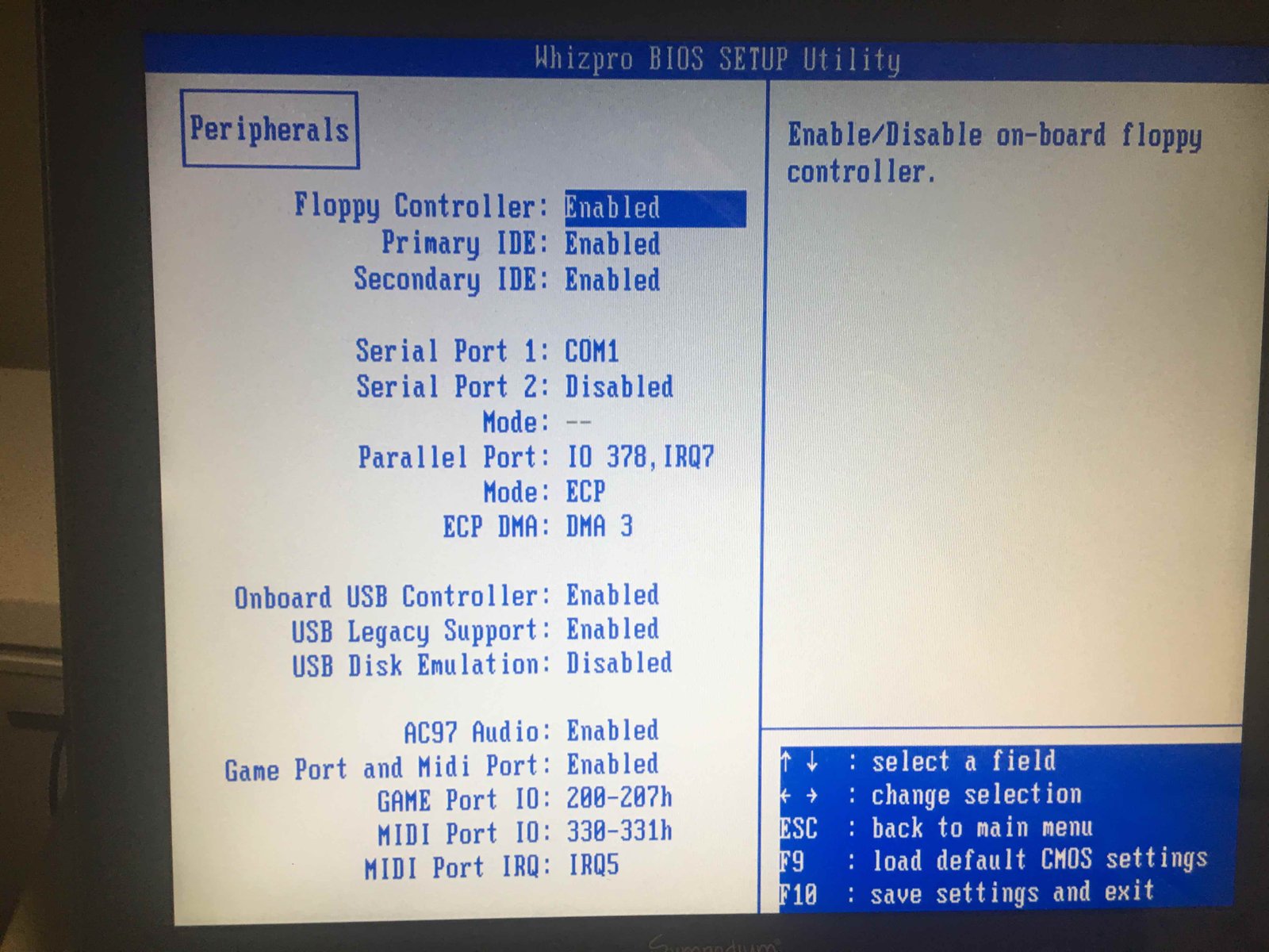

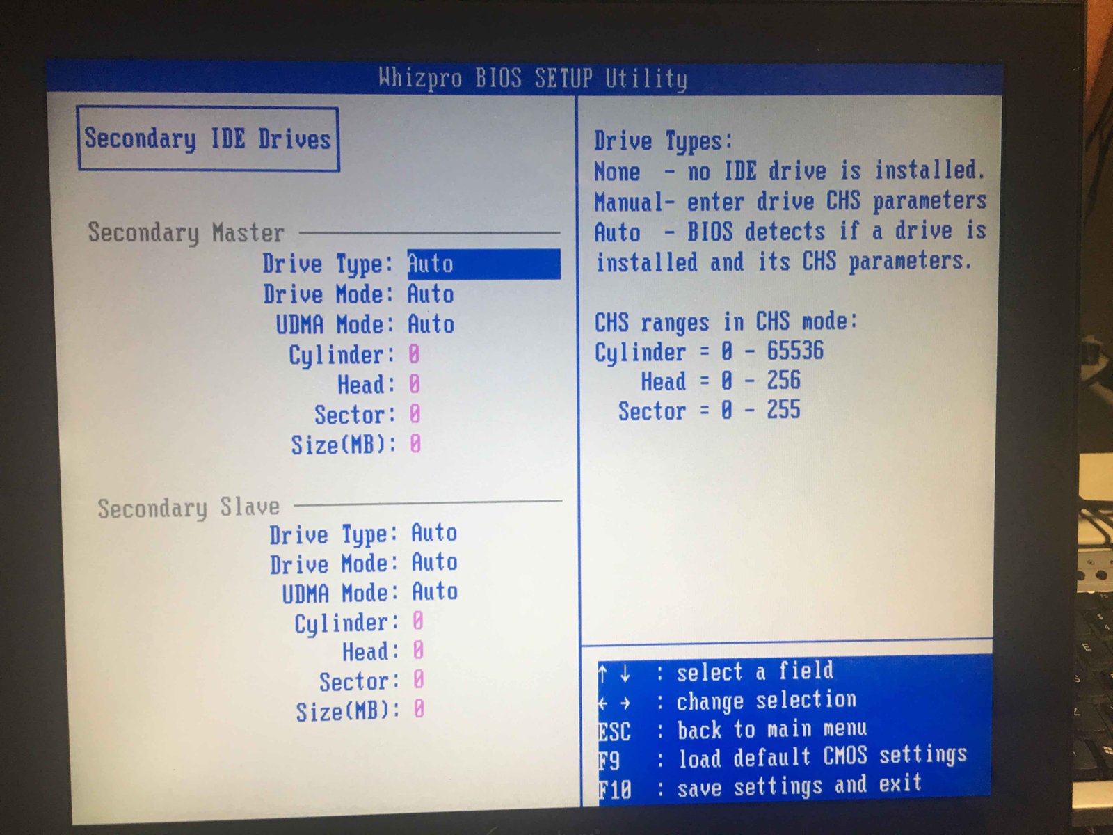

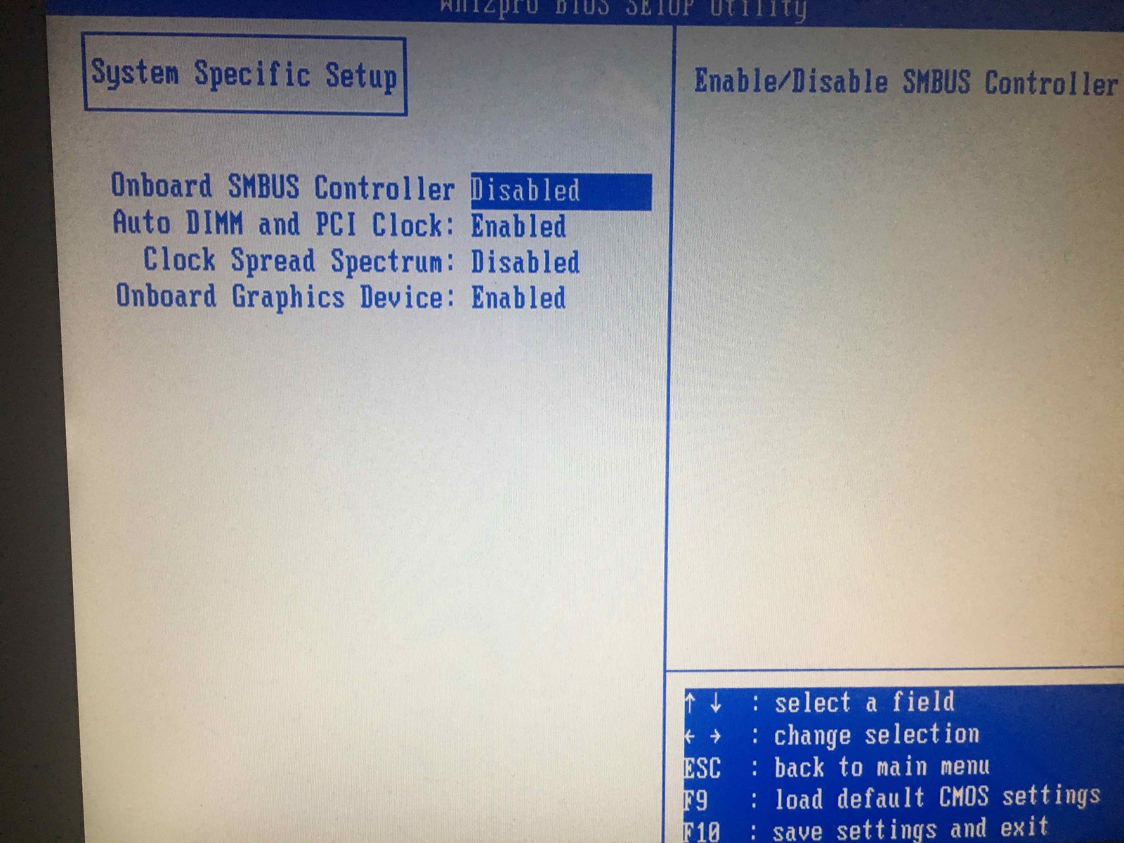

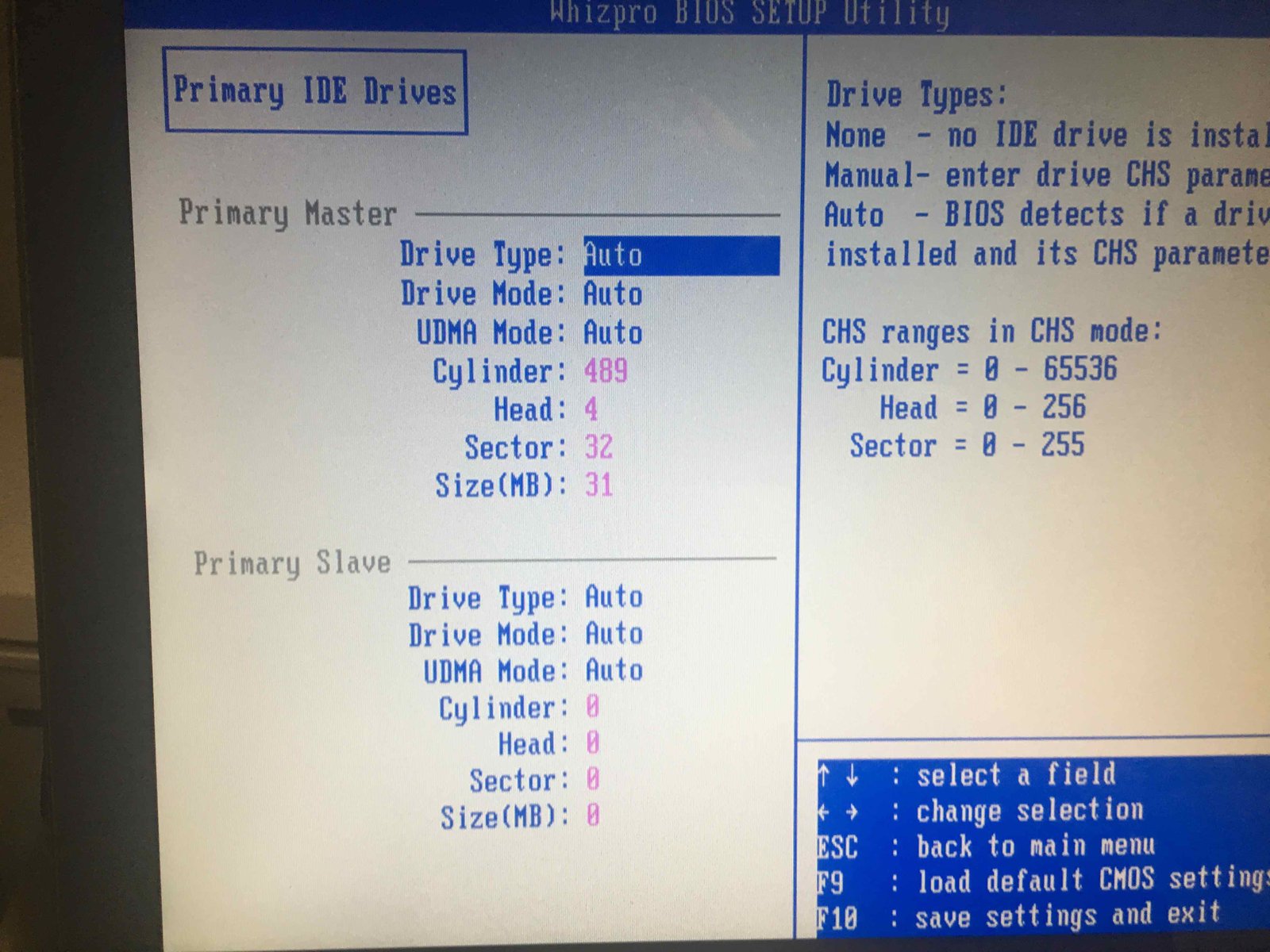

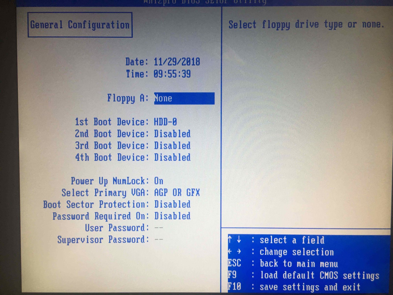

I just replaced the CMOS battery in my 310 Plus printer, It still wont boot, just green power led on start up. I connected a monitor and keyboard and see a Floppy disk error on boot up. Does anyone have BIOS settings for this printer so it boots from the EEPROM flash drive ?
I am having a similar problem with my 310 machine, power getting to it but it won’t boot. Did you find out anything for the BIOS settings?

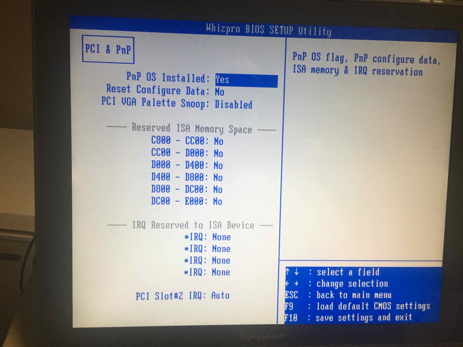

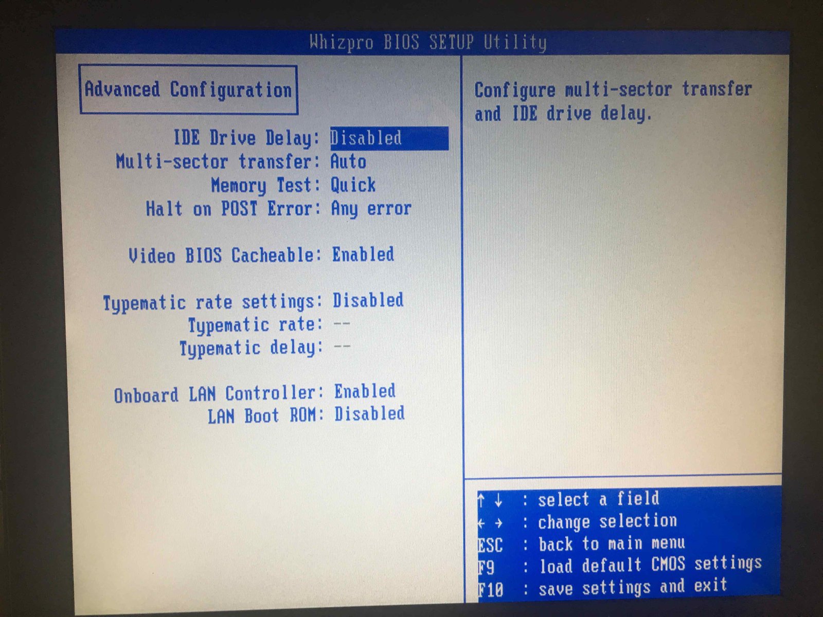

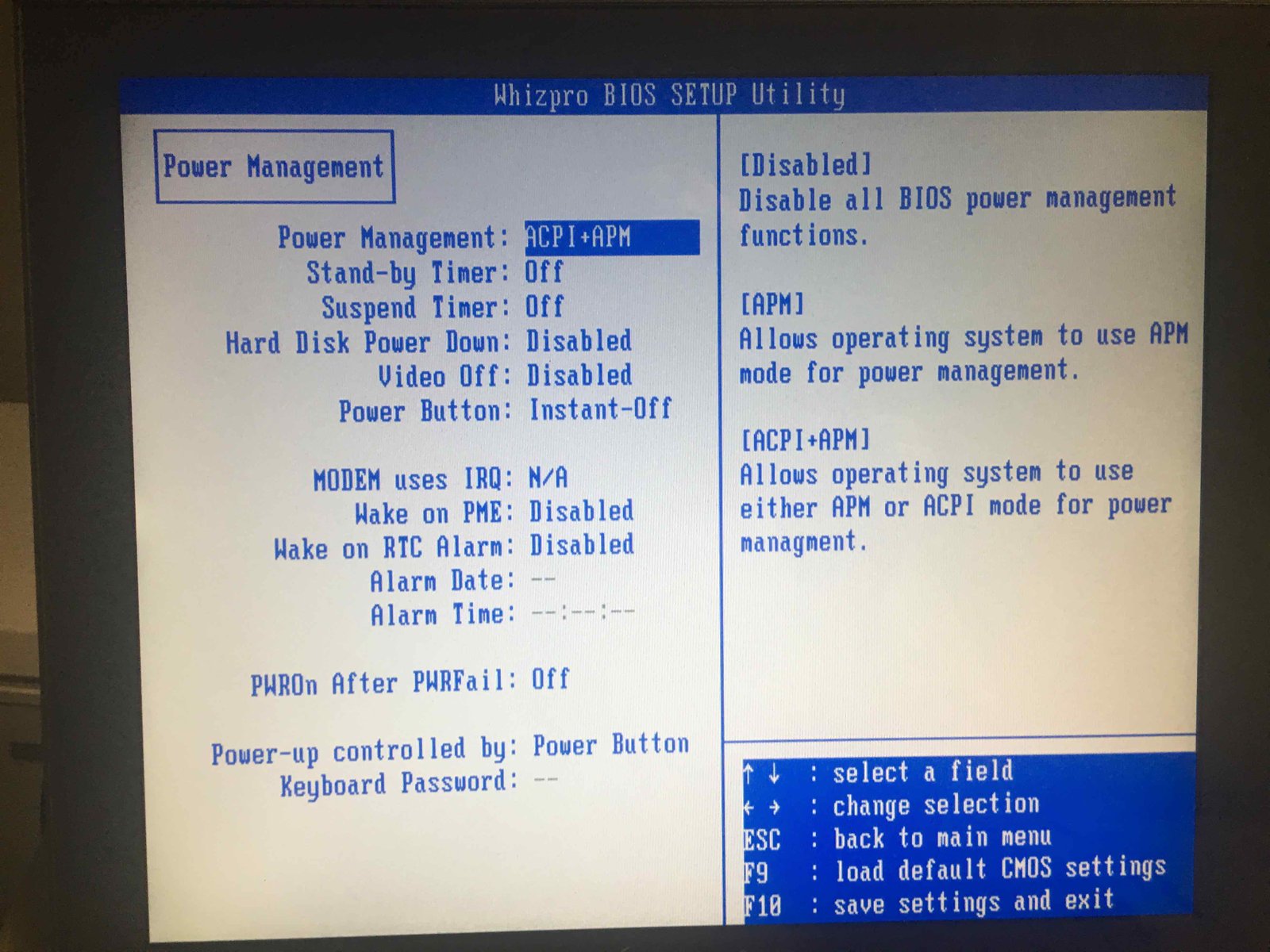

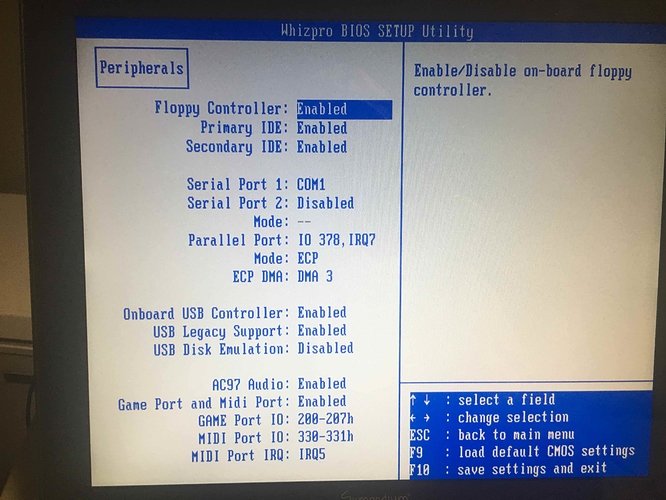

Here are my BIOS Settings. They might not be factory as I purchased a used one and it had a dead CMOS battery. But these work without issue for me.
