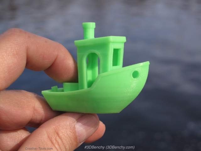

Benchy
http://www.thingiverse.com/thing:763622
What it tests: Surface Features / Resolution , Warping, Overhangs, First Layer Problems
Tips: Creative Tools already posted a Talk thread on Benchy and would be the best person to ask!

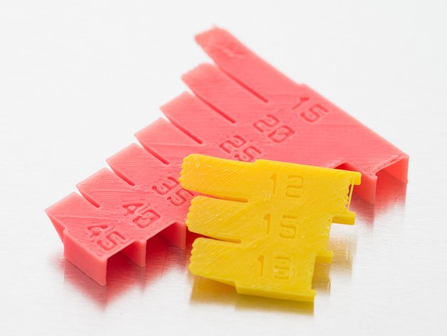

Overhang Test
https://www.thingiverse.com/thing:58218
This object is used to test and calibrate better overhangs with relatively flat angles. It’s designed to test angles from 20° to 70° with increments of 5°. There are angle marks at the top of the object.
What it tests: Overhangs!
Tips: Increase or decrease by 5 degrees to see the difference. Slow down the print speed to let the parts cool between layers.

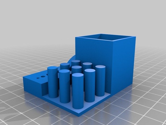

Torture Test
http://www.thingiverse.com/thing:33902
What it tests: Corners, layer alignment, overhangs, holes, and basically everything hard about 3D printing
Tips: A lot of trial and error. 15-20% infill, no supports, and a willingness to experiment

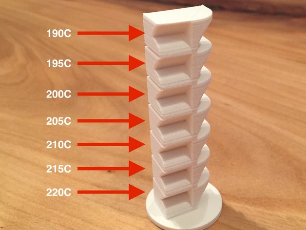

Temperature Test
http://www.thingiverse.com/thing:696093
What it tests: The optimal temperature for that particular filament, Gcode is optimized for Ultimaker
Tips: No real tips here, just pick the one that looks the best to you.

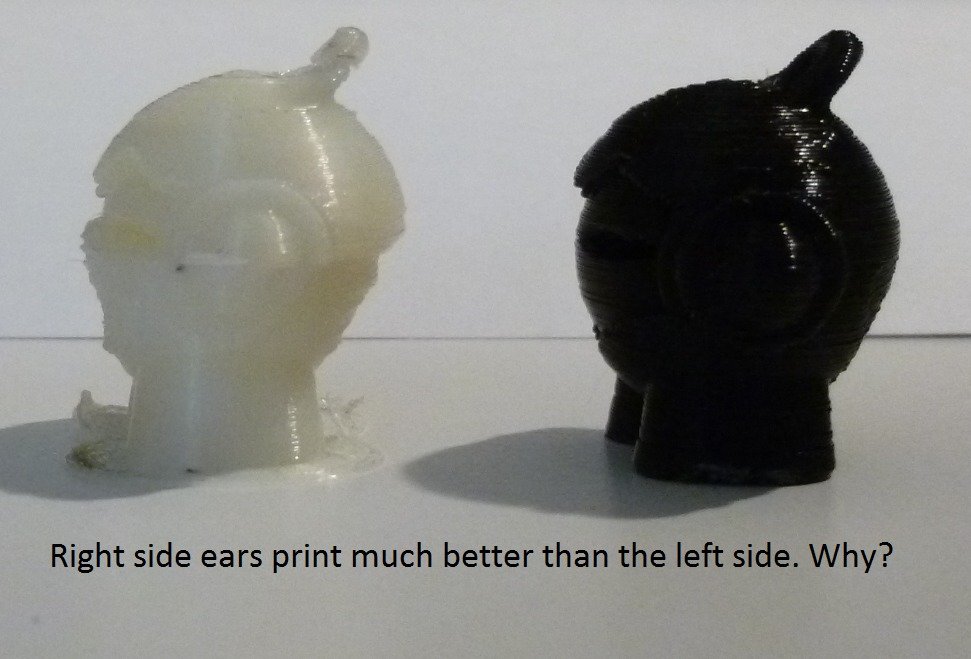

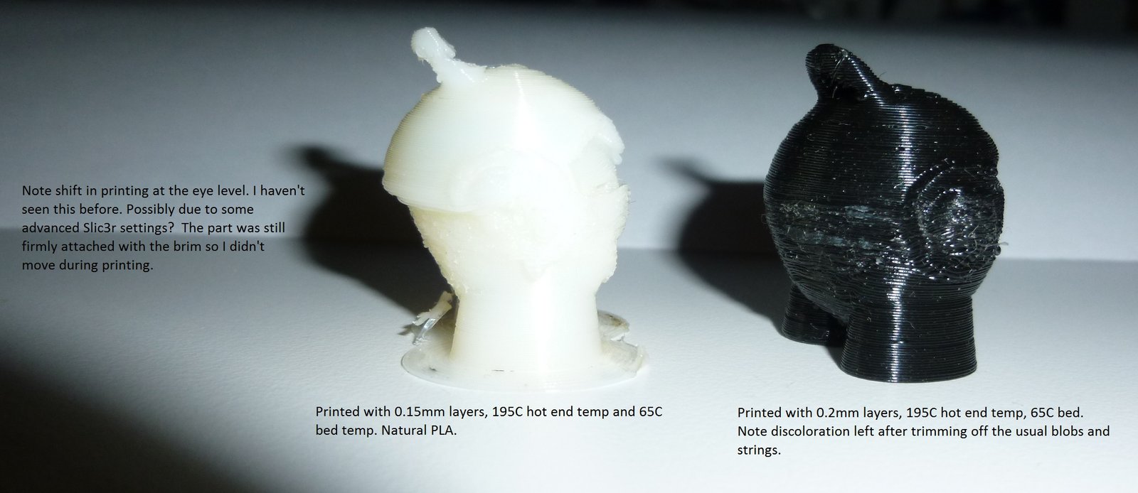

Great test objects. I have a lot of work to do as my Marvin test prints don’t look that well. The new natural PLA filament I have isn’t performing near as good as the black PLA.
