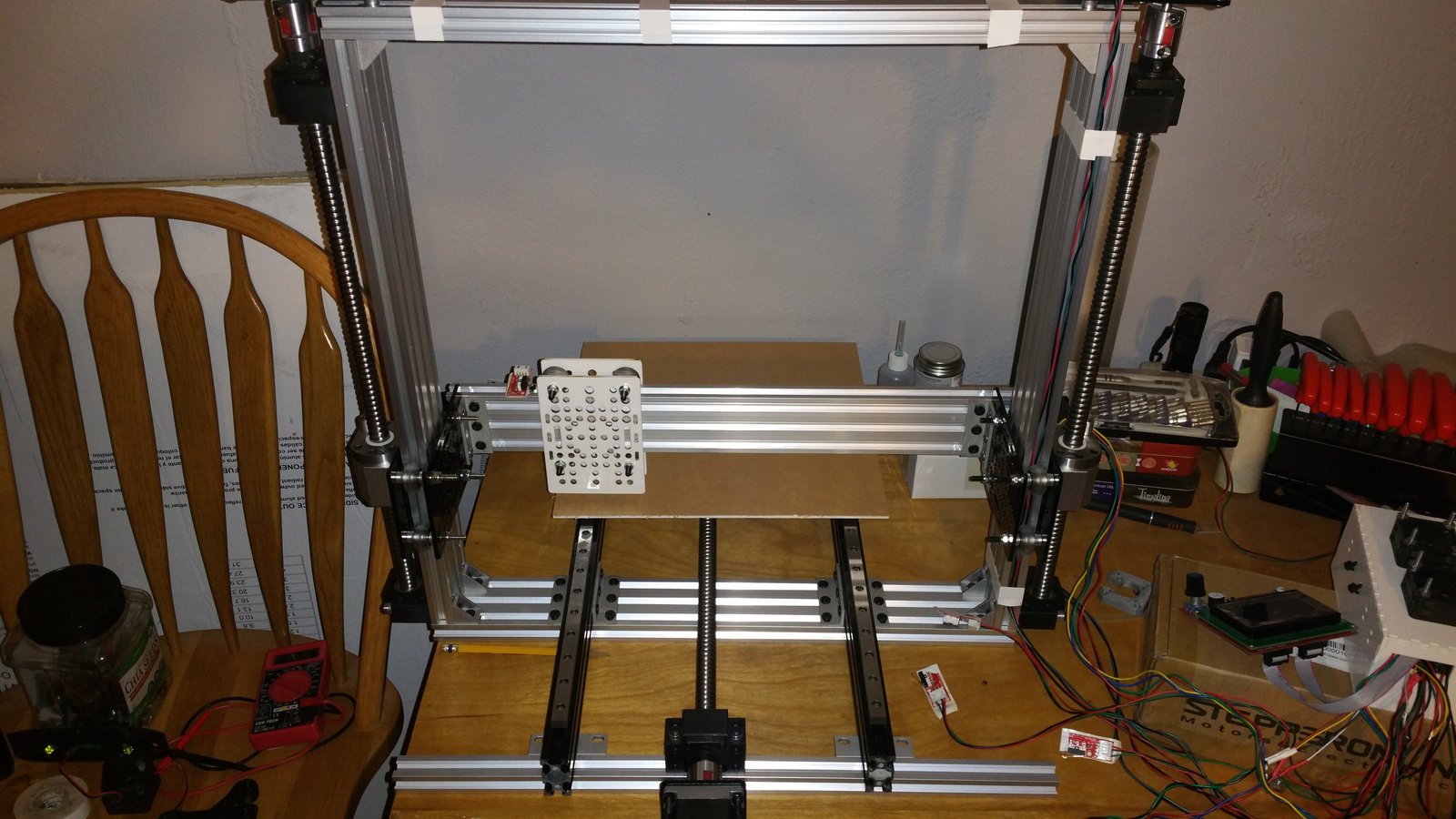

You could always make your own! With $2500 you can have a VERY large printer. I purchased some ballscrews from ebay cheap for the z and y axis of a self designed printer. Along with some 2020 aluminum extrusions from openbuilds and readily available hotends from ebay, you can have a printer with almost invisible layer lines. Of course it helps that i have a laser cutter and cnc available for any kind of custom plates that needed to be cut.
