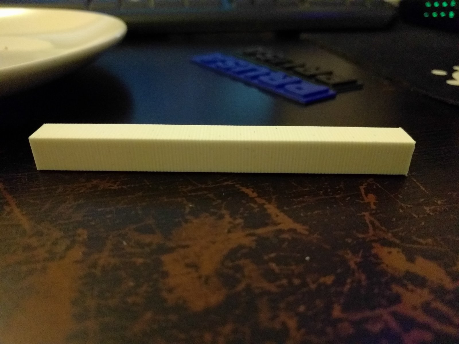

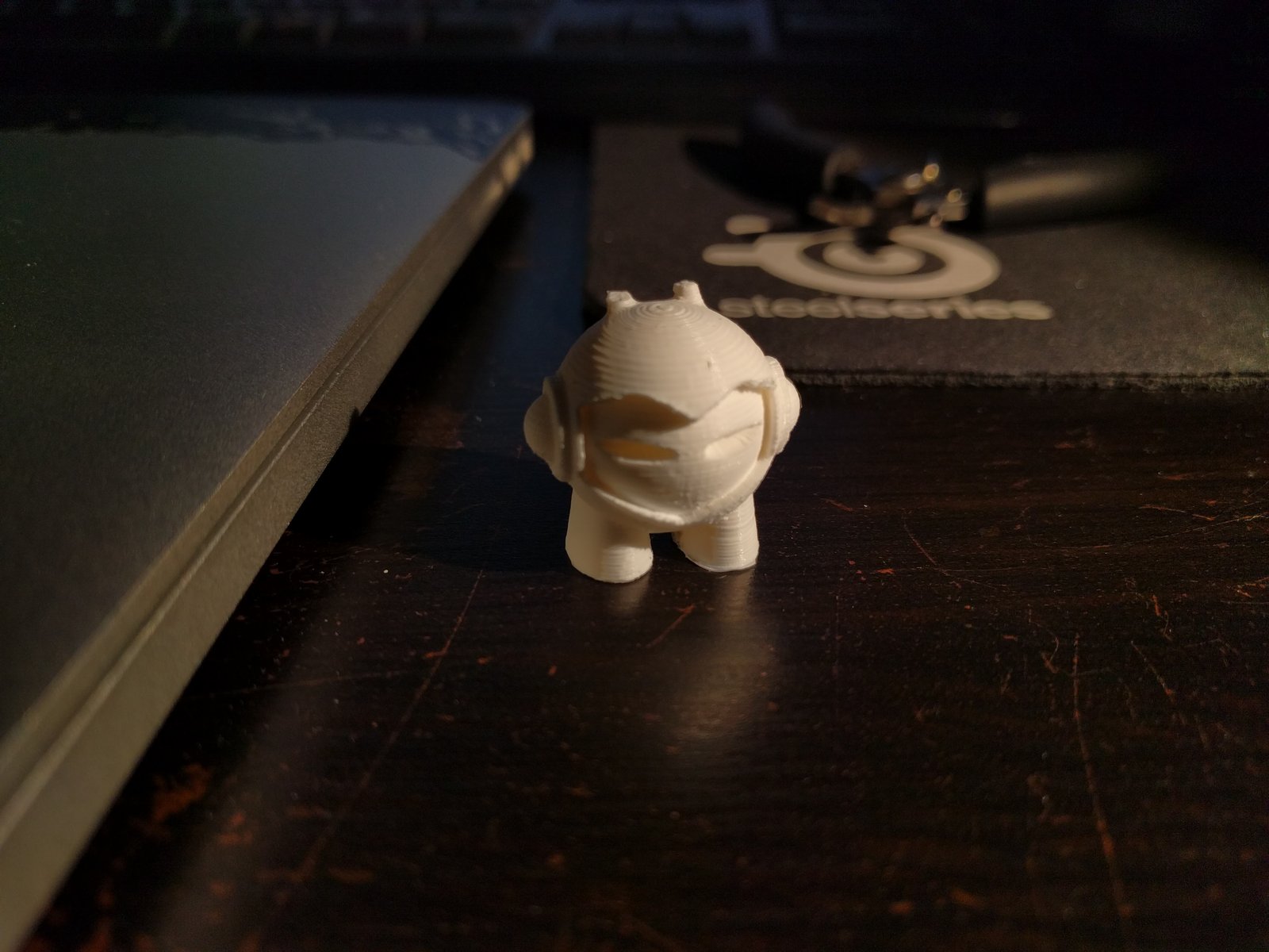

I am having a couple of problems with my Prusa i3 MK2. It appears that most prints have some weird lines. I printed the rectangle at 200 microns, about 15mm/s or less with PLA and 100% fan speed, hot end at 190C. Marvin had the same problem but it has been printed with the file from the included SD card (marvin printed at 100 microns).

I had the exact same problems with the Marvin on the SD card. Also had problems with the dragon supplied on there but that was for the print not finishing.
I attached the image of marvin.

Just to make sure, you have calibrated your printer, and Marvin is printed at 100 microns, right?
From what I can see, I think possibly the z-axis is slightly tilted because the first layer on the left and right feet of Marvin seems different.

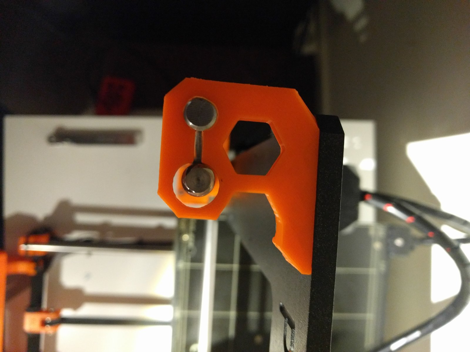

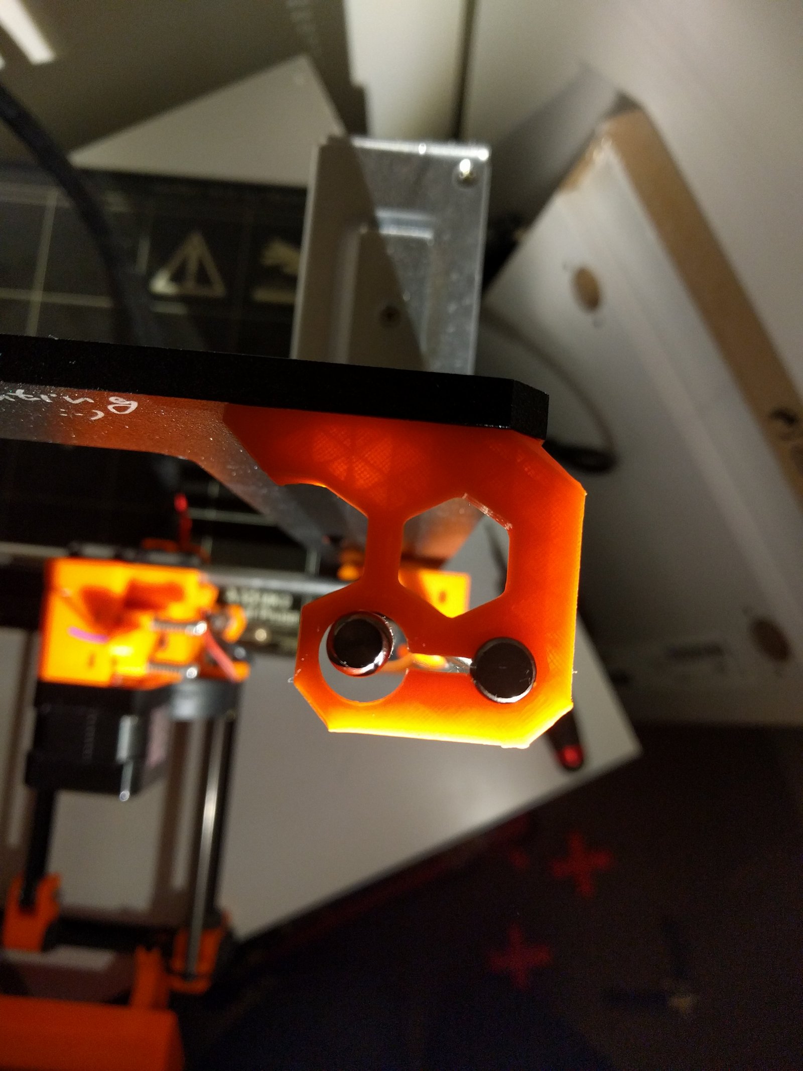

I got it preassembled. I have rechecked the belts and calibrated the extrusion multiplier. But still the same problems. I have checked the z axis lead screws, it does look like they are bent. Here are the pictures
Thats normal! They are not 100% centered in that hole and are meant to be able to move around some.
Try print the Marwin GCode again, but reduce flow to 95 on the LCD and see how that looks.

You do have some surface imperfections that may elude to a mild extrusion issue but the odd lines on the prints are from Z-banding/Z-wobble… Since the long rectangle has the most surface area hold it against your Z screws… You will notice that the lines are exactly the same space as your threads on your Z rods. There are a lot of documents and posts out there covering these issues with some possible fixes… Not all things are fixable the same way and part of it could be resolution vs setup related meaning your layer resolution is even recognized by the printer and falls into your machines particular microstepping capability. I apologize for not having more answers but Search google for those terms and it will show you a ton of results for possible fixes

I printed marvin at the lower flow but I got severe under extrusion… So probably it is not that.
