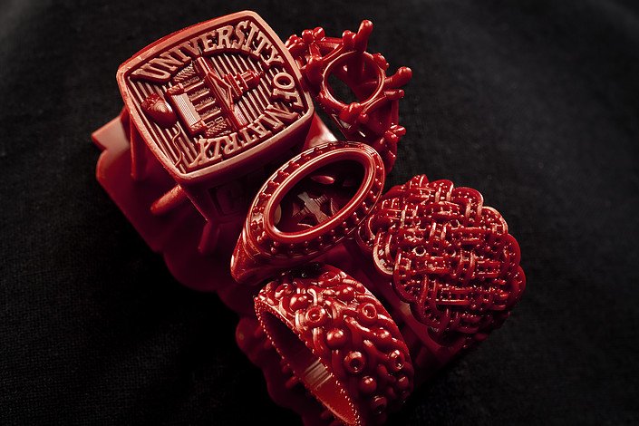

Hi, you received a low resolution piece from B9? B9Creator has a higher resolution than the Titan so I’m not sure of where you received your model but it should have been better than the titan.

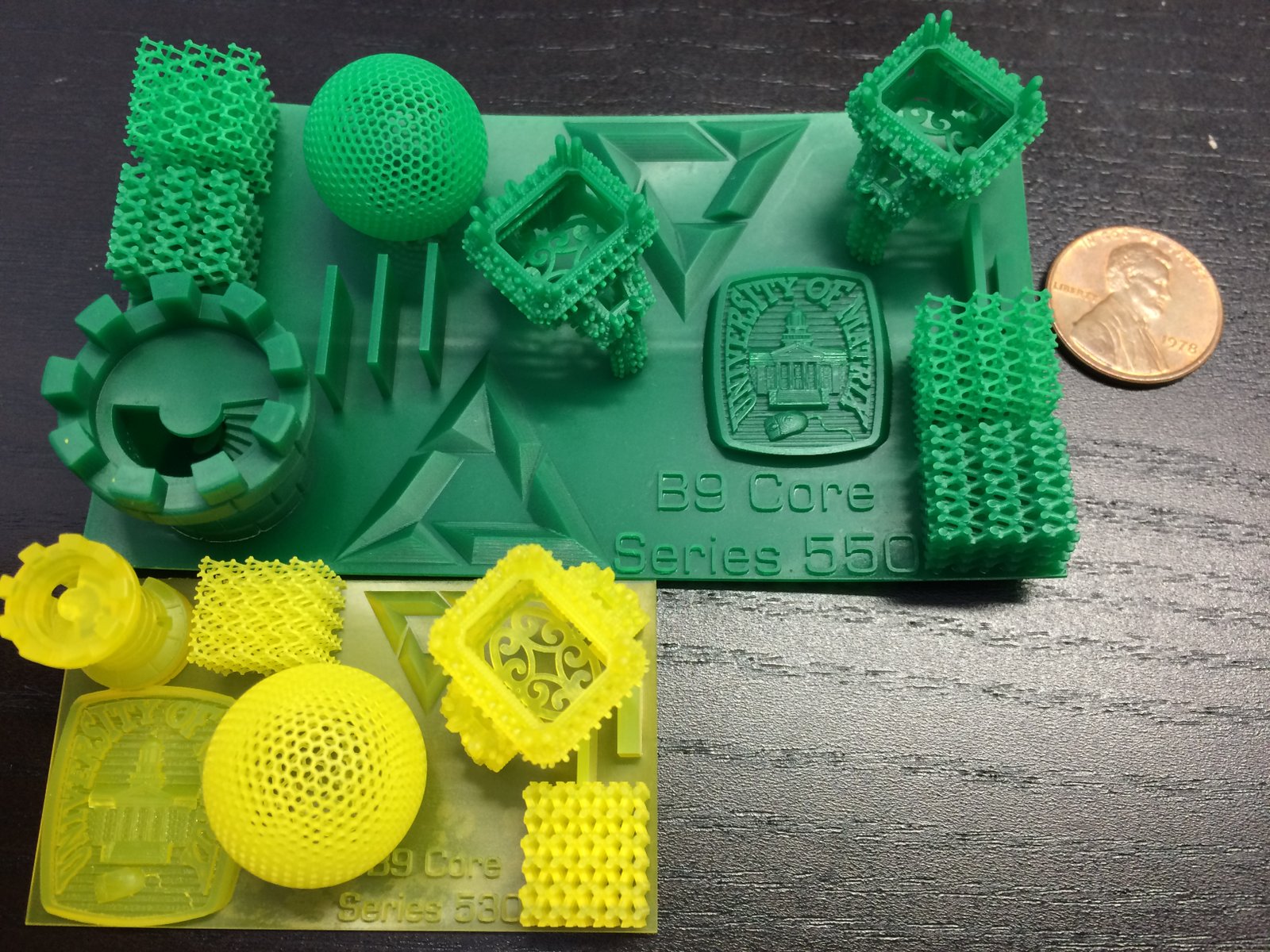

I have attached a picture of a print I did the other day on our B9 Core Series 530 and 550. These are the fastest high-resolution printers currently on the market. Both of these prints were done in 22 and 25 minutes.
wow this looks great enough for the finish, how about the B9 creator? dose it gives the same quality?
thanks in advanced … :slight_smile:
Both of these models were printed on the B9v1.2 at 30 microns sliced at 30 microns.
