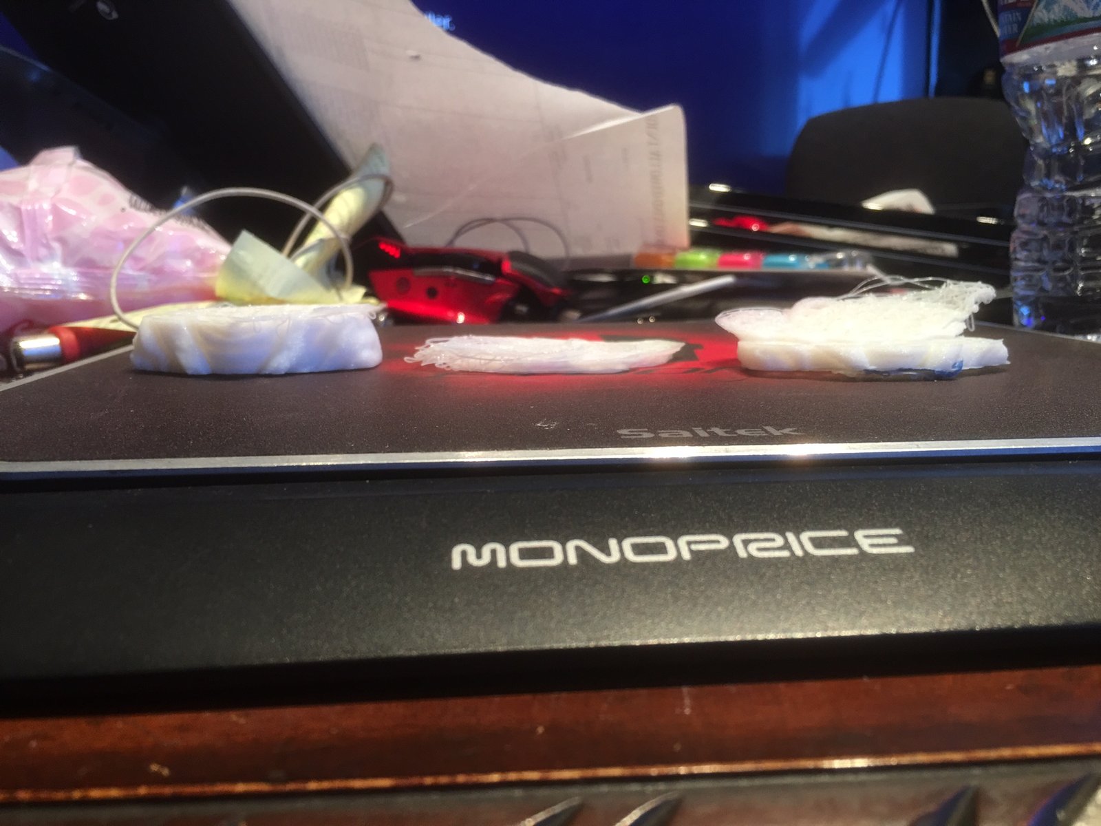

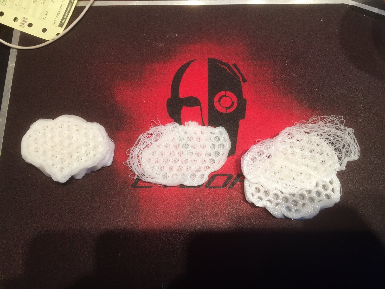

I have been able to do some prints so assembly is correct, the problems I am getting is consistency of print and I keep getting random layer shifts. sometimes on small prints 2" X 2" it does fine but when I get larger it get layer shifts and not always on the same layer, I keep trying the same print and it messes up at different layers every time.

All 3 are of the same object, I have adjusted the stepper voltage to 1 volt and belt tension seems equal and adequate, you can’t seem to use the 1/64 of an inch per inch based on center of pulley to center of pulley that I have always used in my industrial applications for proper tensioning.

Layer shift usually caused by overheating stepper drivers or misconfigured stepper current.

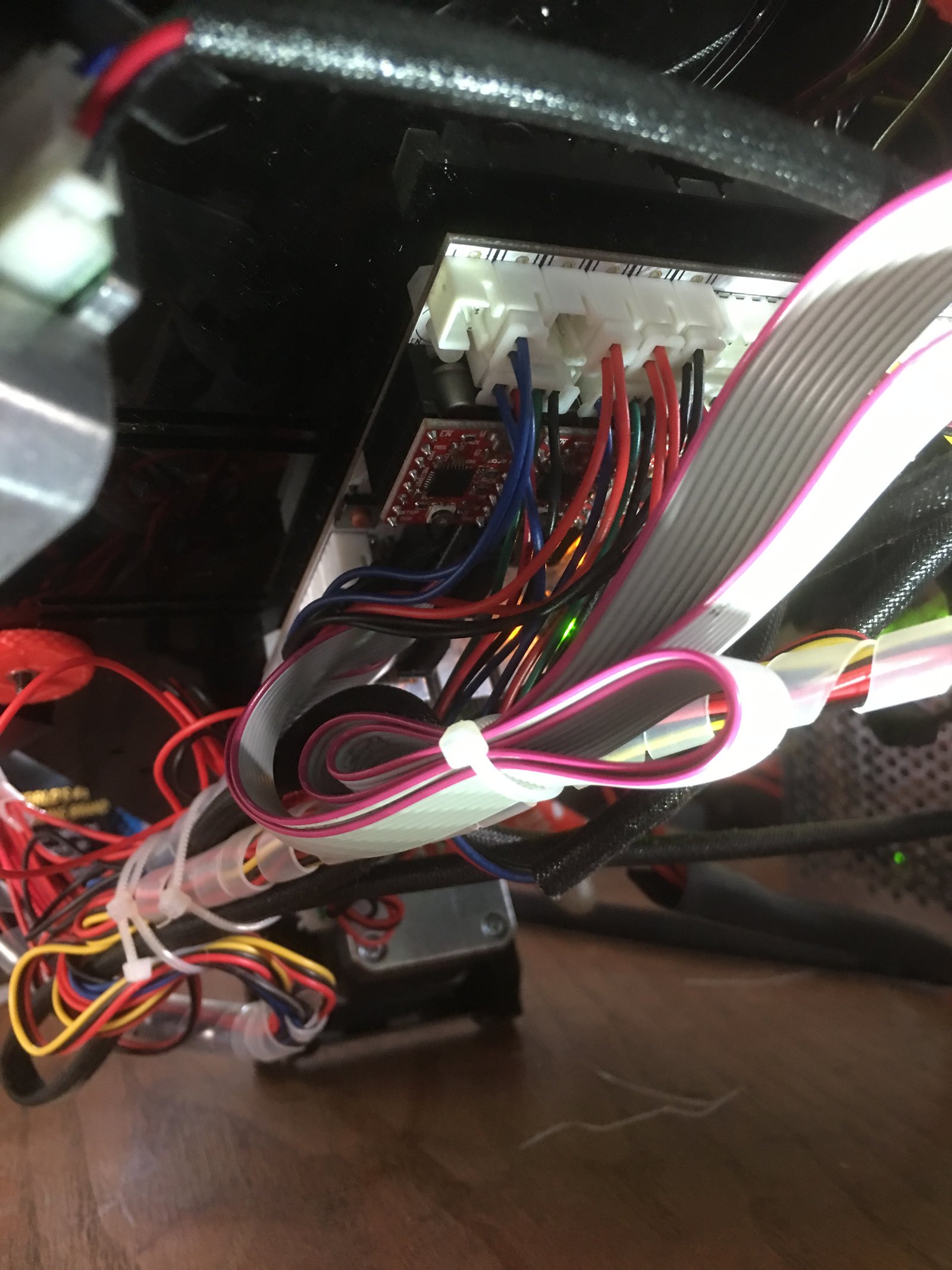

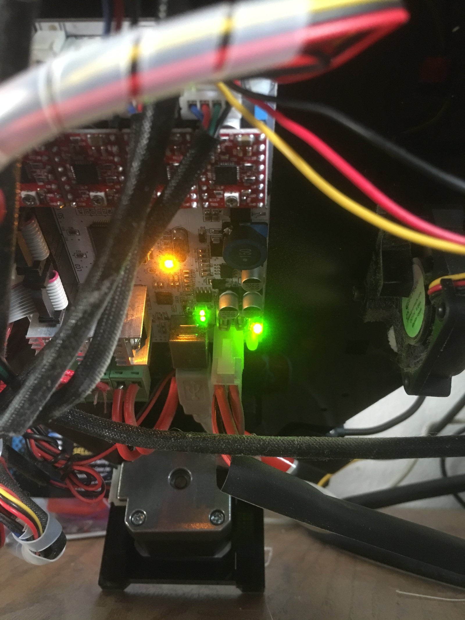

Do you have heat sink on the drivers and also active cooling? Are the or drivers and/or motors hot also?
Witch drivers and motors you have ?
The steppers are staying pretty cool they are barely over ambient.
i don’t remember the number of the stepper but here are pictures
