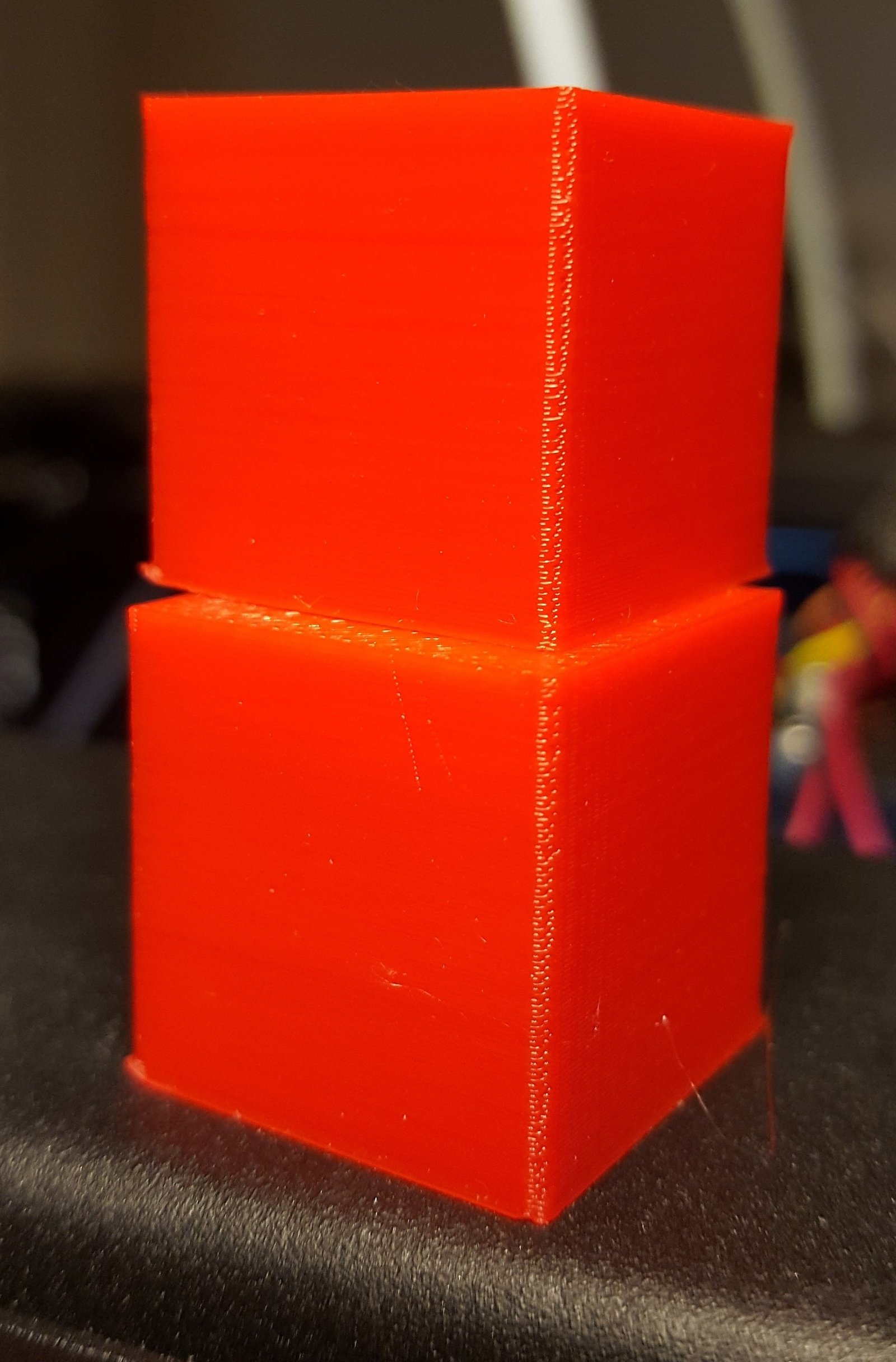

Perry, I do have a new issue since installing the MS hot ends. When doing a calibration cube (PLA) and setting the start point to specified I get what looks like under extrusion right exactly on the corner edge. It isn’t like the usual where it drags part way across the first side but it more looks like the corner was cut off just slightly or the corner looks “pitted”.
I’ll post a picture later when I can.
Thought I would mention it since you use the MS ends!!

Here is a pic. It is a little hard to see but the “cut away” look on the corner is the issue. I am guessing it is a retraction deal.
Thanks for taking a look.
That definetly looks like a starting error. It could be a couple of things.
I think it is not purging your hot end enough before the print, so small amount of plastic gets on there, that gets pulled on the next layer. I am leaning this way, because of the direction of the pull.
I can also see you are either too close to your bed, or overextruding your first layer. This can also leave a blob when the outline meets itself when it completes the outline, again creating a situation where there is a little too much plastic, that gets picked up by the extruder on the next layer.
Definitely add or increase skirt, or raise bed a little, or print less % of first layer. This should make it go away.
This is all guessing based on the picture…
