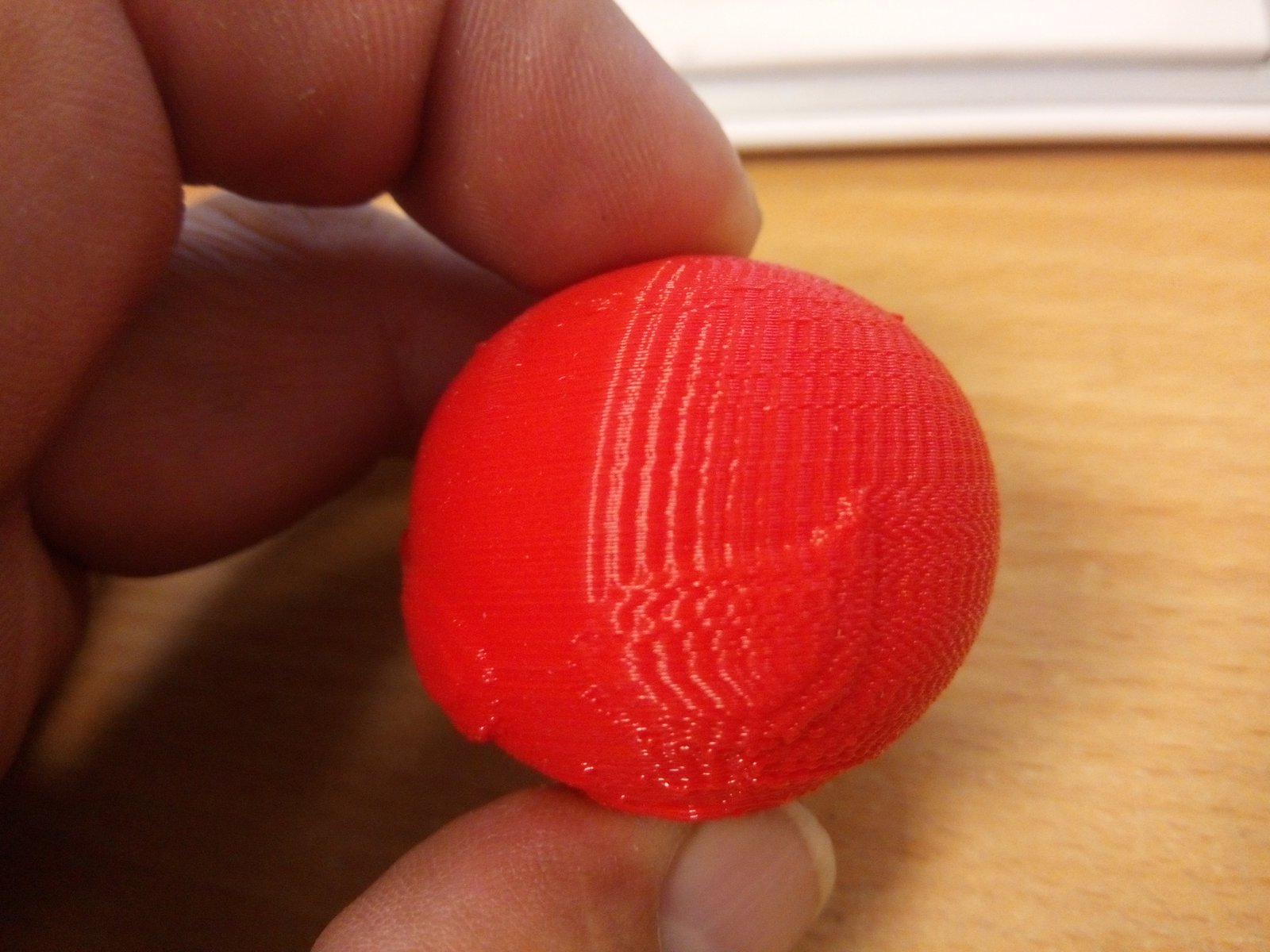

Hi sorry to jump in this as well
Not sure if you manage to find a solution to your issue …
So I have the exact same problem. Printing fine for months. Recently upgraded to a glass bed. First print after the glass bed was pretty decent
Then all of a sudden my bed has a stutter like movement but only on the right of the bed.
I disassembled everything bed related …checked both rods are straight, tried drylin and stock bearings, they glide smoothly over the rods.
Stepper seems fine, everything is aligned. Stepper is not under strain, no weird sounds!
When homing or moving y axis with octoprint or marlin there’s no issues y axis performs normally. This only happens when printing!
Any advice would be appreciated. I doubt it’s software related as I havnt messed with jerk settings etc … tried older gcode files to ensure it’s not gcode/software issue
Im a little confused on this.
You say it is happening only on the right side of the bed.
Im guessing you are seeing the stutter on the right side of the bed?
But everything is aligned…
Do your rods fit perfectly, or do you have space where the rods can move backwards and forwards a little inside the rod holders with the caps over them?
If you move the bed back n forth, can you hear the rods banging inside the caps?
Mine did, I had to put some paper in there to make it quieter.
I also found with mine, that I had to loosen of the bearing holders to the plate, and run the rods back n forth a few times to get them perfectly straight. Using a straight edge did not help me at all. It was easier to loosen them off, and tighten them up to the point where the bearing holder could move, but with a little force. Move the rod back n forth a couple of times after tightening each screw to ensure that the holders arent moving too much from the tightening of the screw.
It was a pain, I also found after all that fiddling that the distance between the rods in the igus bearing (much lower tolerance to error) was off by about 5 mm when the rods were extended. So this meant I had to loosen the whole plate sections together to get it all to line up correct.
Its exhaustive the steps you have to go through, especially with the igus bearings. But totally worth not hearing the original bearings clatter and the quality of the prints jump right up when you do get it sorted.
As a side note, also check that your threaded rods and nuts havent come loose and that the distances over them to the front to rear braces measure the same. Any movement here would cause weird warping and who knows what issues…
Hope this helps, Im only really able to give you answers from my own experiences, and I went through a very tedious time with my anet upgrade to igus, but now it prints fantastic.
