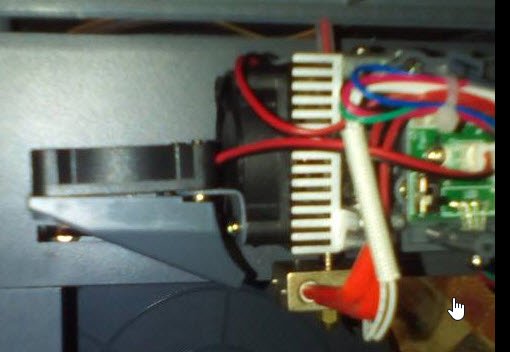

Issue 91 (Free copy) came with the supplied fan and hood to do this, you need to fit so the brackets are pointing upwards to ensure the hood does not fall below the height of the heater block. Once fitted, switch the Switch on the small controller board on the Printer head to the up positions and then your software will do the rest. See the attached photo of the one I fitted to my V3

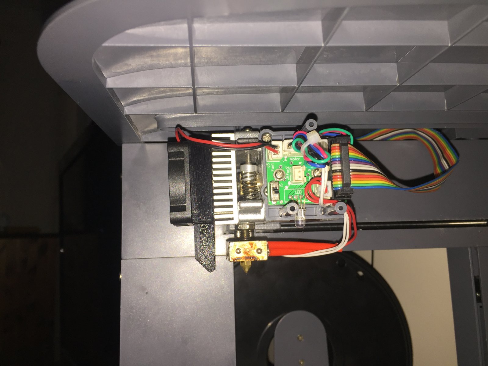

The fan shroud below when printed fits the V3 and deflects just enough air from its existing fan, downwards to cool the plastic as it exits the nozzle while still keeping the extruder cooled enough to prevent extruder malfunctions. I found it on Thingyverse I will come back and credit the designer shortly.
