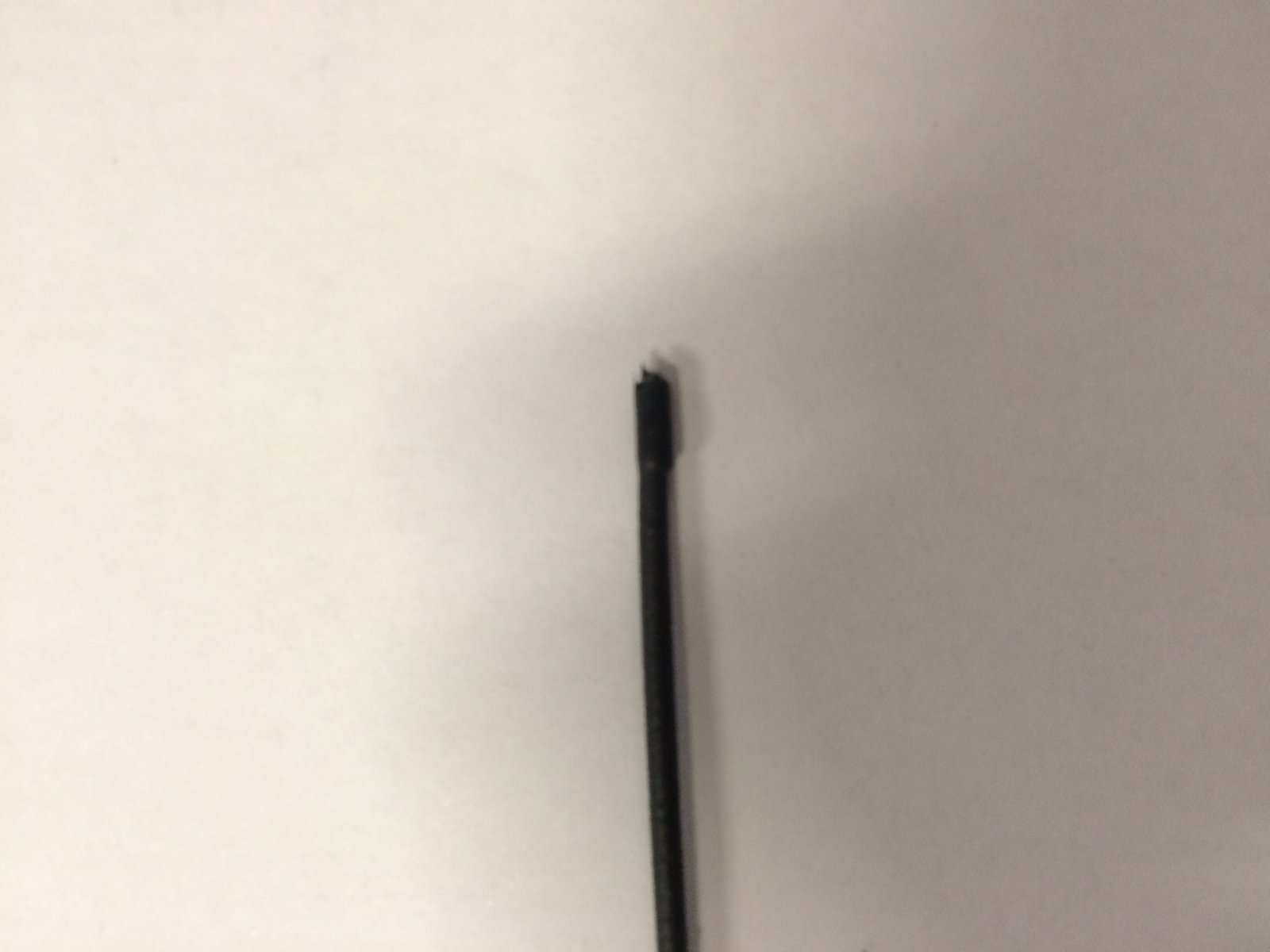

I am working with conductive graphene filament, like blackmagic conductive pla and protopasta conductive pla. The problem with conductive filaments is that if it is left in a heated extruder it expands. It expands in the nozzle and pfte liner that eventualy cause blockage and it clogs . I would like to only active the toolhead that prints the conductive graphene PLA to heat up at a certain layer where the conductive traces start so the risk of an clogged extruder is less. I added a picture of the expande filament. The last 20 hours i had no succes and have taken apart my extruder for so many times.
