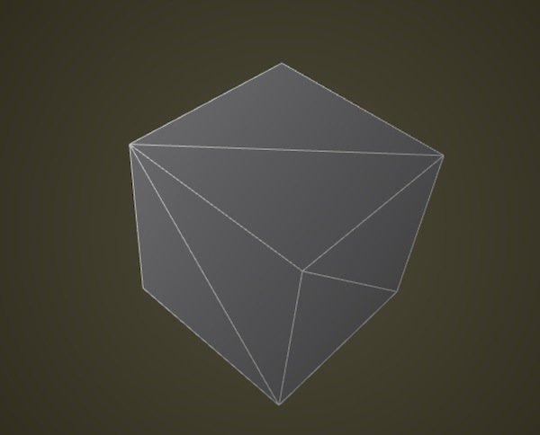

*side note: click the green text, its a picture!*
STL format is generally used as a ‘finished product’ ‘geometry only’ export format. STL is an abbreviation of Stereolithography, but I like to think of STL as “Standard Triangle Language” because when you export as an STL it completely changes the ‘mesh’ of the model into all triangular faces (still preserving the original shape and geometry). This is important to some people when sharing their files on the internet because it is much harder to modify a 3D model after the fact when its coming from an STL, rather than another format that preserves the original mesh that it was created with (more on this later). Not to say its impossible to modify an STL file, but it is SIGNIFICANTLY more difficult than just re-modeling it yourself. Also, with the countless slicers out there used for 3D printing and CNC machining, they all seem to work best with the STL format, in fact some slicers only accept STL. If you just browse www.thingiverse.com for any amount of time, you will notice almost all the models you download will be in the .stl format, this is because one of the two reasons listed above. 1 the creator doesn’t want anyone taking their design and modifying it. Or 2 they are just making it easier for the consumer to drag and drop that file directly into their slicer without any problems.

Here’s another example to better visualize the difference, say you create a basic cube in CAD: Cube.stl and then send it off to someone who you then expect to continue work on it. Imagine getting that file and trying to manipulate it in a simple way, maybe by increasing the height. You would have to select both of the triangles, and most likely due to the other axis being on constraints, you wont get the desired effect. You will end up with hard, diagonal, indented cuts. However, if you sent off Cube.obj you can easily click on the top face and move it up! Also note that these two cube examples are literally the simplest models just to demonstrate the point, if you were doing this with real models there would be way more triangles that wouldn’t behave the way you wanted, even if you tried to manipulate them.
