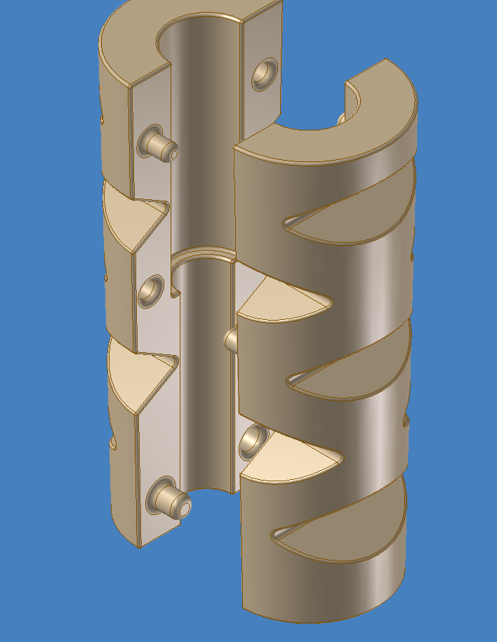

I’m Sagar. I’m would like to get a small part printed out. However, I see that since the part dimensions are too small---- 1.25mmx2mmx0.75mm. . Please advise how can I get the part printed out.
In what material do you need this printed and are the dimension are for the whole (assembled?) part or for the dimensions of these small plugs? Very accurate SLA might be possible but even there you’ll need to add some kind of support structure so it doesn’t get lost.

Are you sure they are the actual dimensions? Sometimes the conversion gets messed up.
You were correct, the dimensions were messed up.
Hi Sagar
We get this happening occasionally with some customers’ stl files and it’s usually out by a scale factor of 10. Should this part be 12.5 x 20 x 7.5mm?
If so, it wouldn’t be a problem for our printer.
