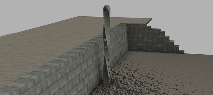

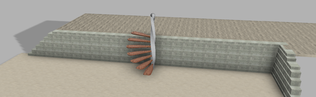

By the end of the week I’ll have some concept drawings and site photos. I think this will help visualize what I am trying to achieve.
Let me add the the forms are not designed to take the structural load of the concrete and they will be heavily braced and reinforced for 28 days until the concrete is cured and I can tension the cables. There will also be quite a bit of standard rebar reinforcement.

Once I have a more refined concept drawing I am going to do a full structural analysis to make sure that if I get the completed structure in place that it will stand. I think that post tension cables are going to be the only way that I can get the required strength out of the size of formwork I can realistically print.
