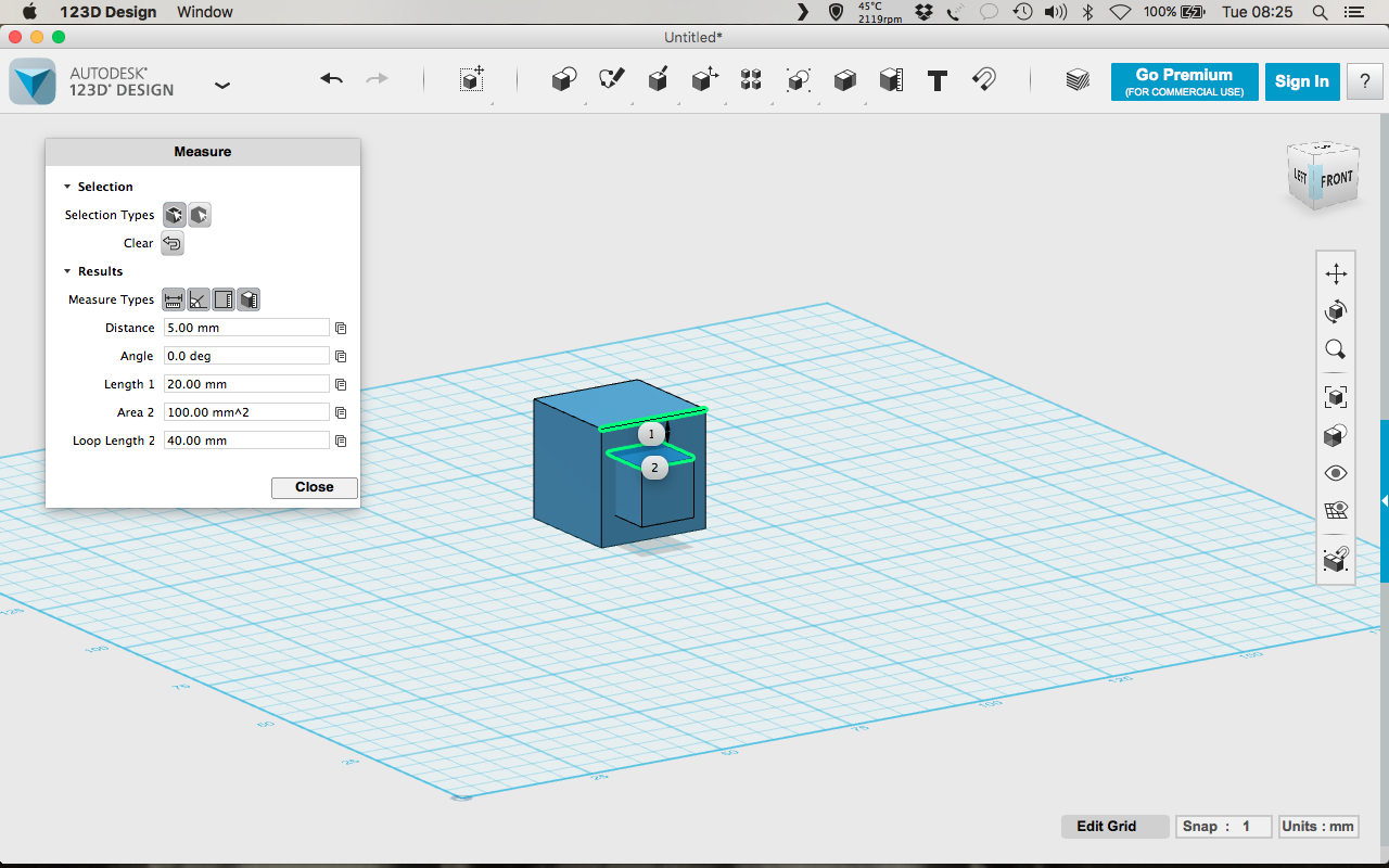

I did not explain well so screen shot added.
Imagine two primitives that I wish to combine together. Lets say a big cube and a smaller cube.
The big cube has been fixed into position and I wish to move the smaller cube so it is 3mm below the top edge of the bigger cube.
My screenshot shows the current measurement of 5mm distance. I would like to be able to move the smaller cube while seeing this distance update as I move it up by 2mm. I can’t find a way of doing this.
I seem to have see the current distance (5mm) and work out manually how far I need to move the smaller cube (2mm), move it that distance, and then check the measurement again to make sure OK.
So I am asking if there is a way to see that distance change as I move the smaller cube.
Thanks!

Thanks for that and I get all that, but it still doesn’t give me what I want.
So yes I could align the small cube to the top of the larger, and then move down -10mm. But that still not a single step and I would probably still check it with the measure tool afterwards just to be sure. So three steps, rather than one.
So I don’t NEED what I am asking for, but it would be a good feature which would remove steps and speed things up - not massively but a little.
And annoyingly (on a Mac), the software sometimes forgets I am trying to snap to 1mm and uses a snap of 5mm on the move. I have to change the snap and then set it back to 1mm for move to start behaving again.

You can click around on the measurement, then edit the measurement to move the item. I’ve done this a couple of times. I agree that it’s far from intuitive, and the software doesn’t seem to be geared towards working this way. But it is possible.
