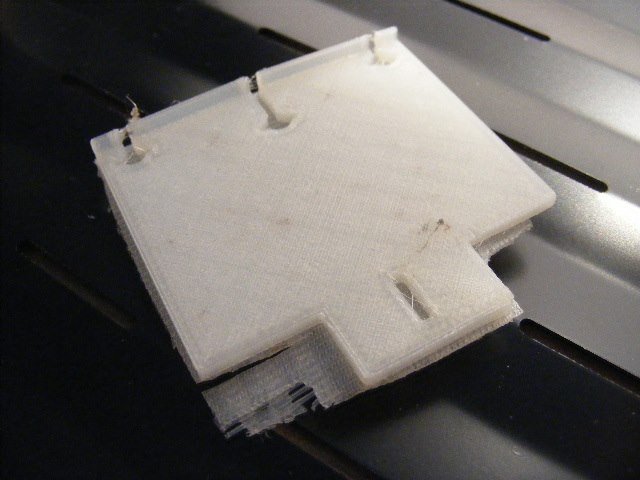

A bit of modding can be done to the machine like putting a resistor between the thermocouple of the extruder. It really would not be too difficult to do and will work with normal filaments. I have used some super cheesy filament for $20 at my local microcenter (the unbranded stuff) and have been able to get great results. The raft and supports came off just as easily as the regular material but was a bit too hot causing bridging to droop and did smoke just a hint when printing. If this was lowered any abs would work perfectly with the zortrax, and the prints that I was able to do came out great.

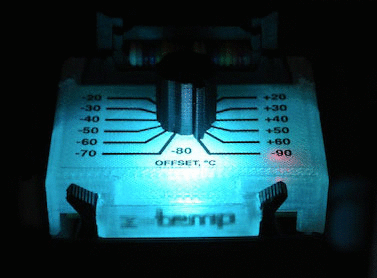

The Z-Temp™ is now available, providing Zortrax M200 users with extensive control of extruder temperature, visual display of actual extruder temperature, and output for measuring extruder temperature accurately, and the ability to disable bed heating.

Great idea for the m200. Have it my self and it works great easy to install!
Nice work Julia! This takes away the single imperfection of the M200.
