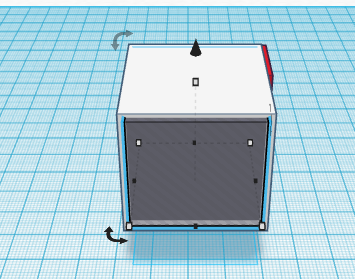

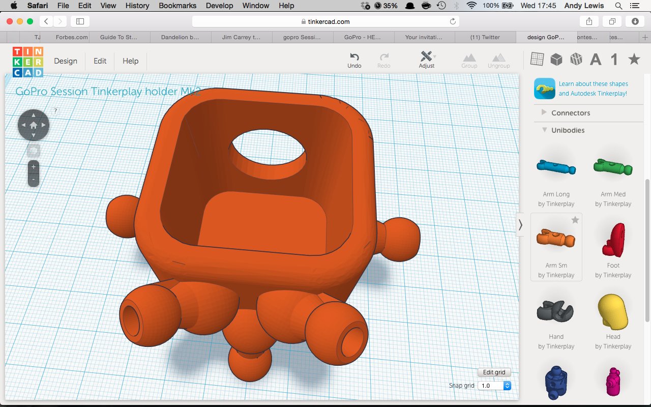

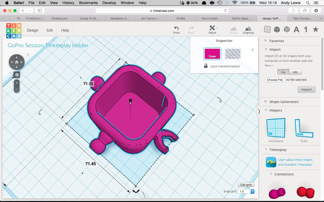

OK! Here we go! Admittedly, Iâm not the greatest CAD designer on Earth. Probably not in my street but, hey! Hereâs my entry. Itâs a holder for the new GoPro that can be used as a Tinkerplay component. I designed the case in Fusion360 ( 45x45x40mm with mainly 12mm fillets minus 35x35x35mm with 7.5mm fillets on 4 sides ) ,exported it to STL, then imported that to Tinkercad and attached some Tinkerplay ends from the library. AaaaaaandâŠVoila!!
The original idea was to make it a Tinkerplay head, with big ears, a hipster haircut and a single-lens RayBan Wayfarer. Maybe a nice beard and moustache too, but I couldnât make it to the Fusion 360 training and would have ended up throwing my Mac out of the window before the design was finished. Iâm not sure quite how practical it is, as you probably canât get to the controls and once itâs fitted, you might have problems getting the GoPro out but I think itâs a kinda interesting concept and it could be a stepping-off point for all kinds of cool âX-podâ designs for the GoPro. Just goes to show how easy it is too. If I can do it, anyone can!

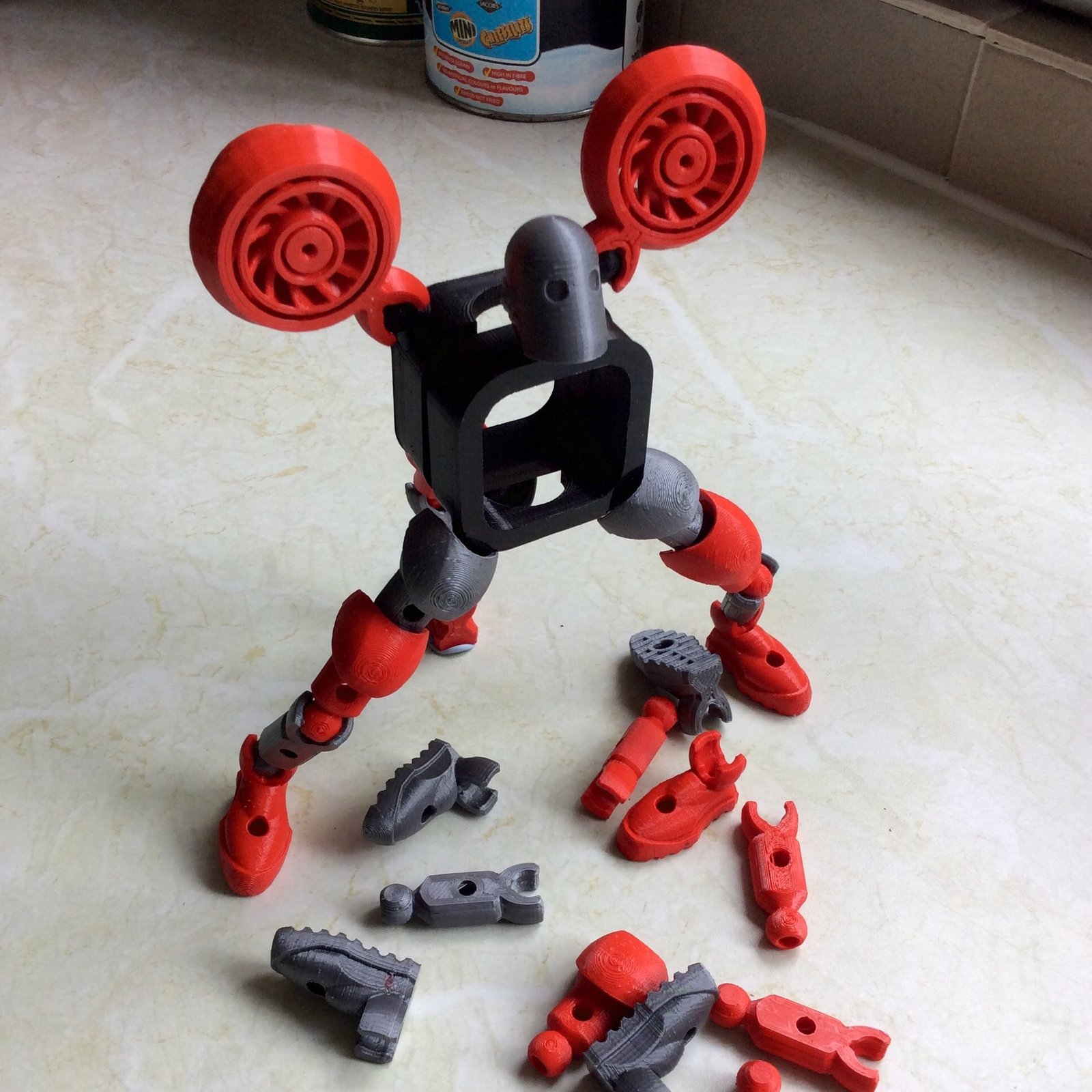

Thought Iâd try a rather more practical version. This time with provision for 3 legs and access to the button! Not practical. Just more practical! And no more easy to print!

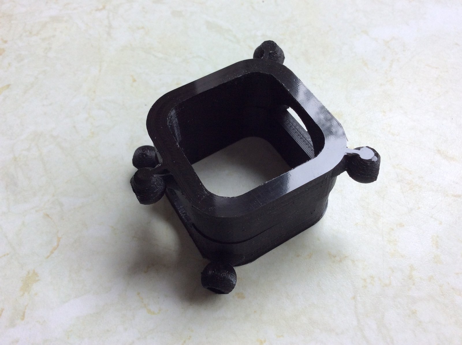

Thanks guys. Youâve encouraged me to try to address the limitations of my previous designs and I came up with thisâŠ
Itâs a single component that can be printed twice without support. If the two rings are fitted to the GoPro, they allow access to the button, and allow 3 or 4 Tinkerplay legs to be added. If you want to take close-up vertical videos, you can aim the camera down between the legs, or even wrap the legs around something for a secure mount. Iâm still not 100% happy with it but I feel like Iâm getting close.

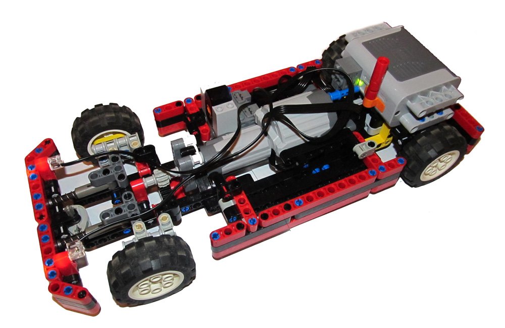

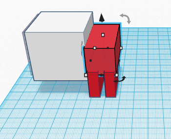

Alright! Here is my entry:
Lego Mount-GoPro Session 4
Pretty cool right?

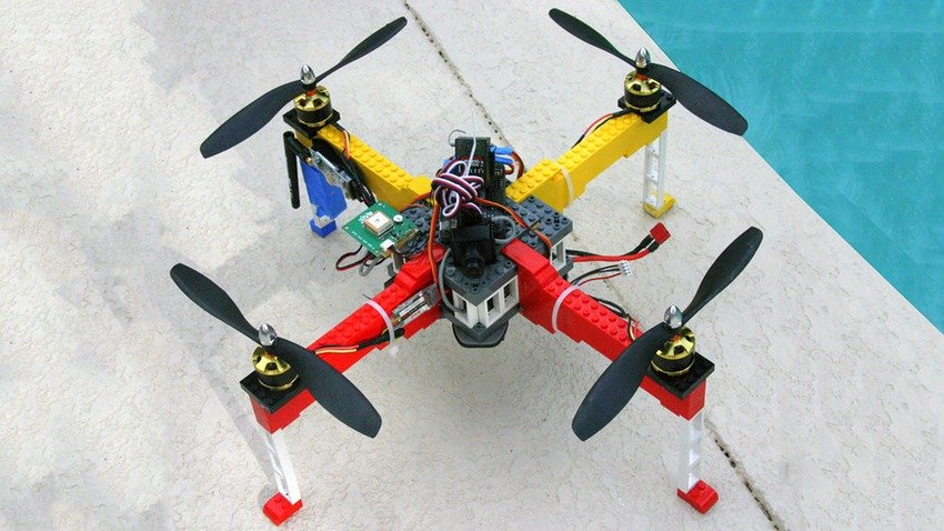

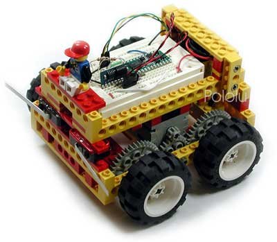

The best part about this mount is its versatility. You can mount it to:
- Lego Robots: lego robot.jpg
- Lego Drones: lego drone.jpg
- Lego RC cars: lego RC car.jpg
- And anything else you come up with!
-Brad Beeson, 11
P.S. Please tell me what you think and donât hesitate to tell me if you see some flaws I may have missed!

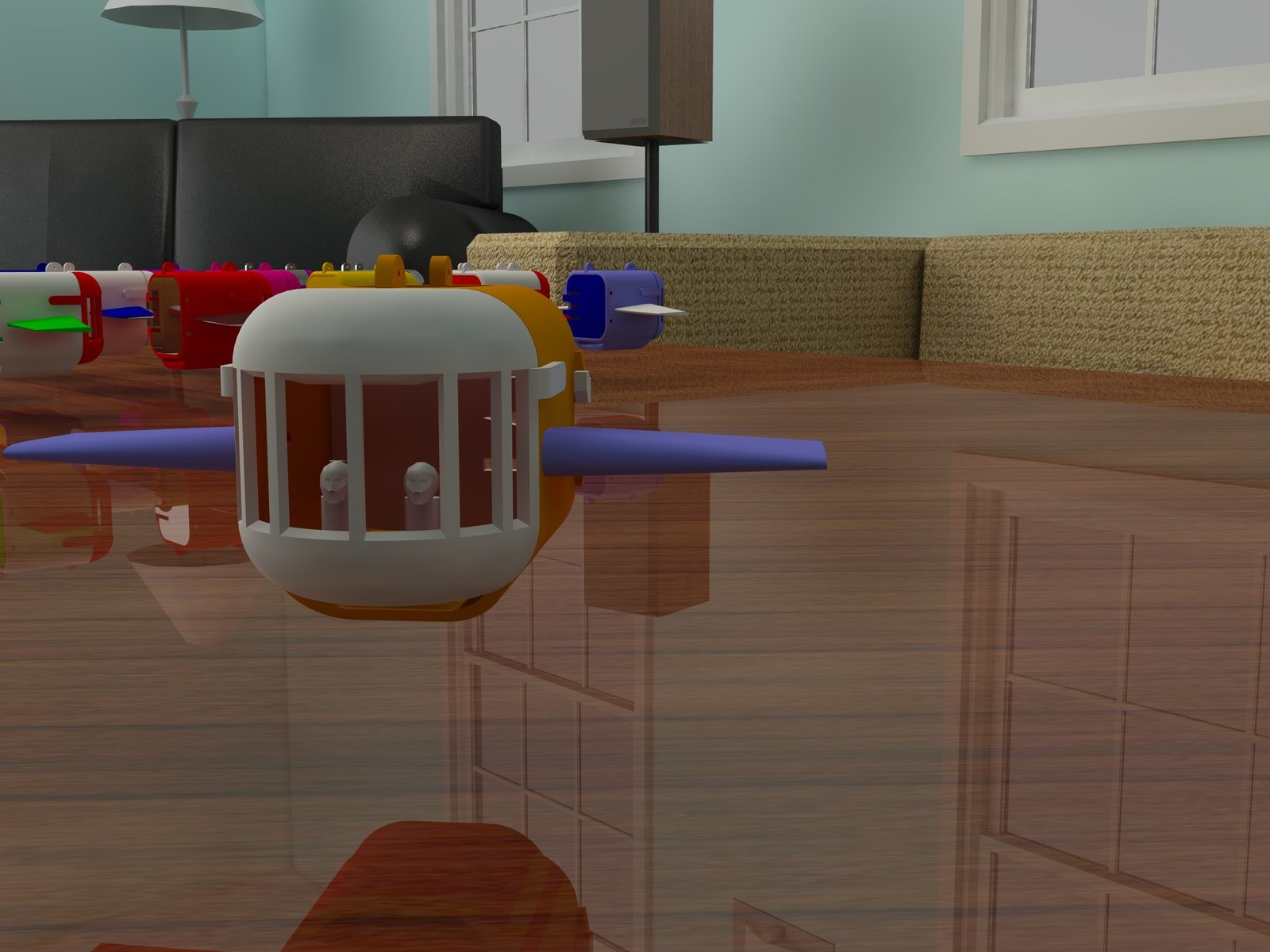

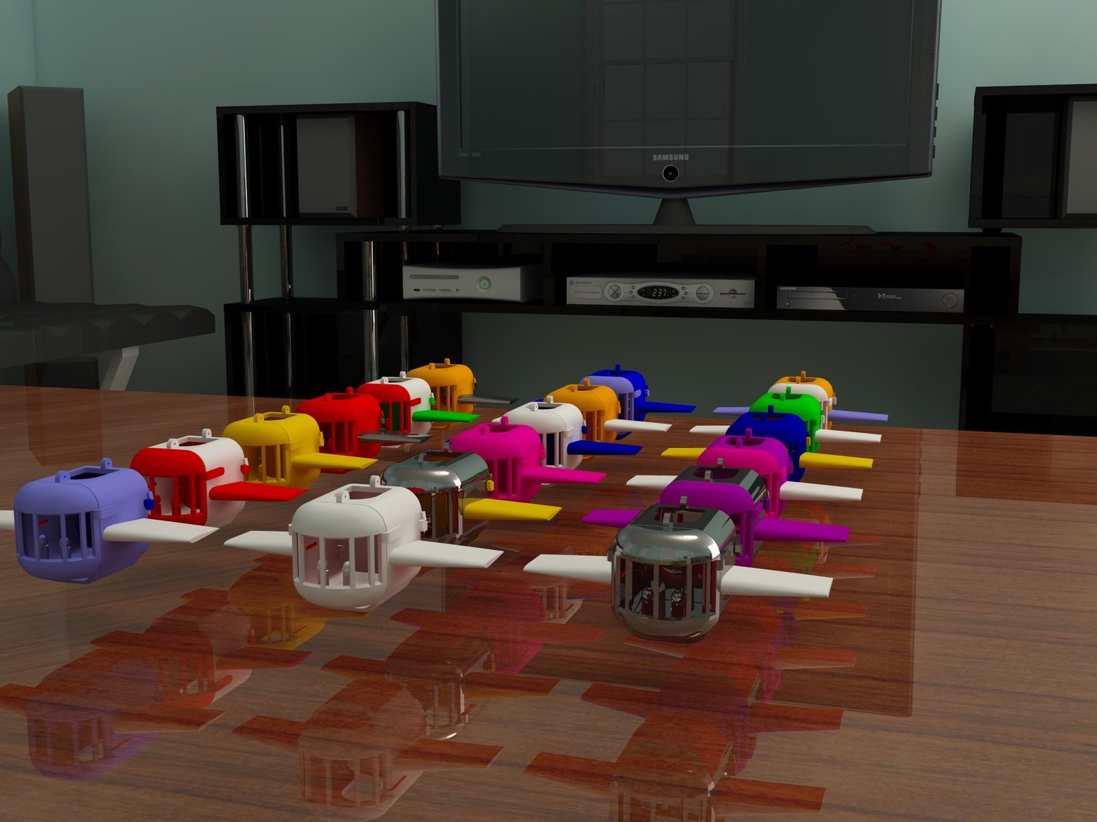

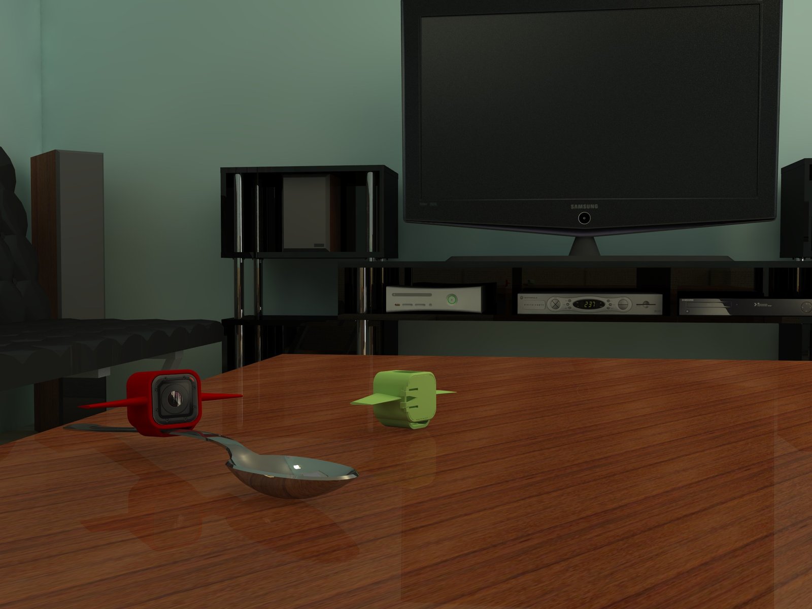

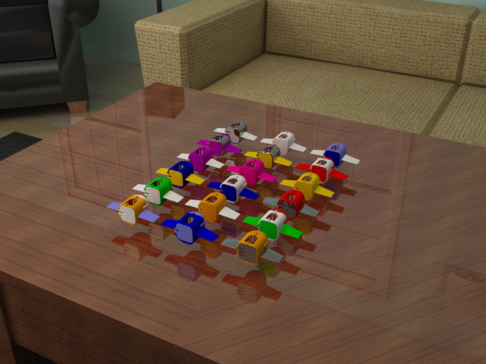

Well, just as many others in this contest (For what I believe), Iâm not a great designer (yet) in 3D modelling. The following idea I had many years ago, but in comparison with the ânormalâ GoProâs, they where a bit clumsy to become that the 4 Session could become ; The GoPro 4 Baby Sessions.
This case provides a hole for a spoon or fork (dimensions for the lemmet max. 20mm by 2,3mm) to attach your Gopro 4 on top of the spoon or fork for funny and cute sessions with your Mini-Me. While your Mini-Me is sleeping and you want to film that, there are two holes on the top of the case for a wire, easily hang up your GoPro for a few hours to make a sleep-timelapse of your child.
At the front, is the Cockpit-cap. A rare and bizar 'nose-cone for a plane, but through the eye of the camera itâs a unique viewing point/angle youâve never experienced before with a Gopro camera. Place it in front of your case and film it like little creatures discovering a giant baby. Like making your own Toy Story !!
And for your older kids⊠You can change and share other wings, cockpits and caps to create your own unique âBaby Boeingâ-cam.
This is GoPro 4 Baby Sessions.
*one of the renders are from my first model, without the detachable wings and cockpit cap, but shows perfectly for what I had in mind. Take a spoon, or take a fork and goâŠ
GoPro 4 Baby Sessions_0.stl (3.26 MB)
Love the renders looks great!
Hey Meike, at the end of the day itâs your design so feel free to distribute and share how you see fit.
Thank you⊠Yes, thanks to a friend Iâve Podium V2 as Rendering software. Easy to use !

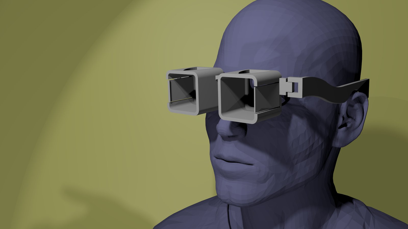

Having a bit more fun with the base model, we can now present⊠GoVision!
Now you can shoot 1st person perspective 3D video without all the hassle of having to physically hold 2 cameras in front of your face
! Caution !
Vision may be impaired during use

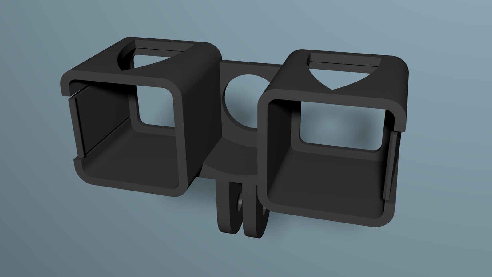

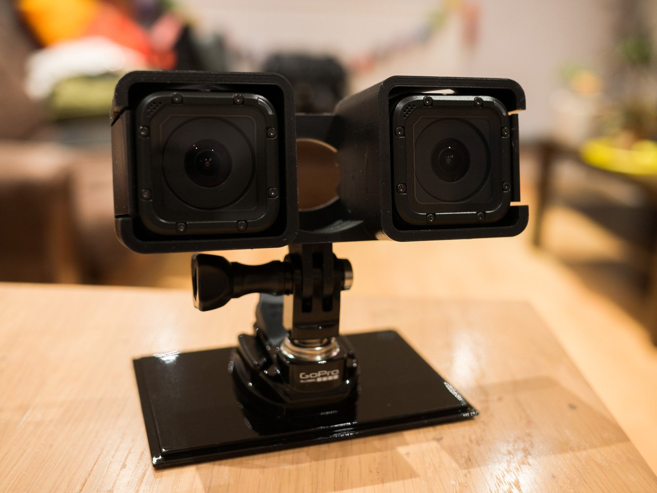

Why just Go Pro, when you can Go Stereo? The small size of the GoPro Session 4 makes it perfect for 3D recording, just clip both GoPro Sessions in, attach to a tripod or GoPro mount and press record simultaneously on both cameras for great stereoscopic HD video.
Designed to be printed without supports on both FDM and SLA printers. To use the tripod version youâll also need a 1/4" nut.
Edit: Having tried the printed version on a real camera some of the dimensions were off so Iâve created version 2 with correct dimensions. Iâve also added versions optimised for bottom-up SLA printers like the Form 1 by creating channels for the resin to flow through to prevent delayering on the base.
PS. Unfortunately we donât actually have 2 GoPros to make any 3D films, the action shot is just a bit of Photoshop magic
