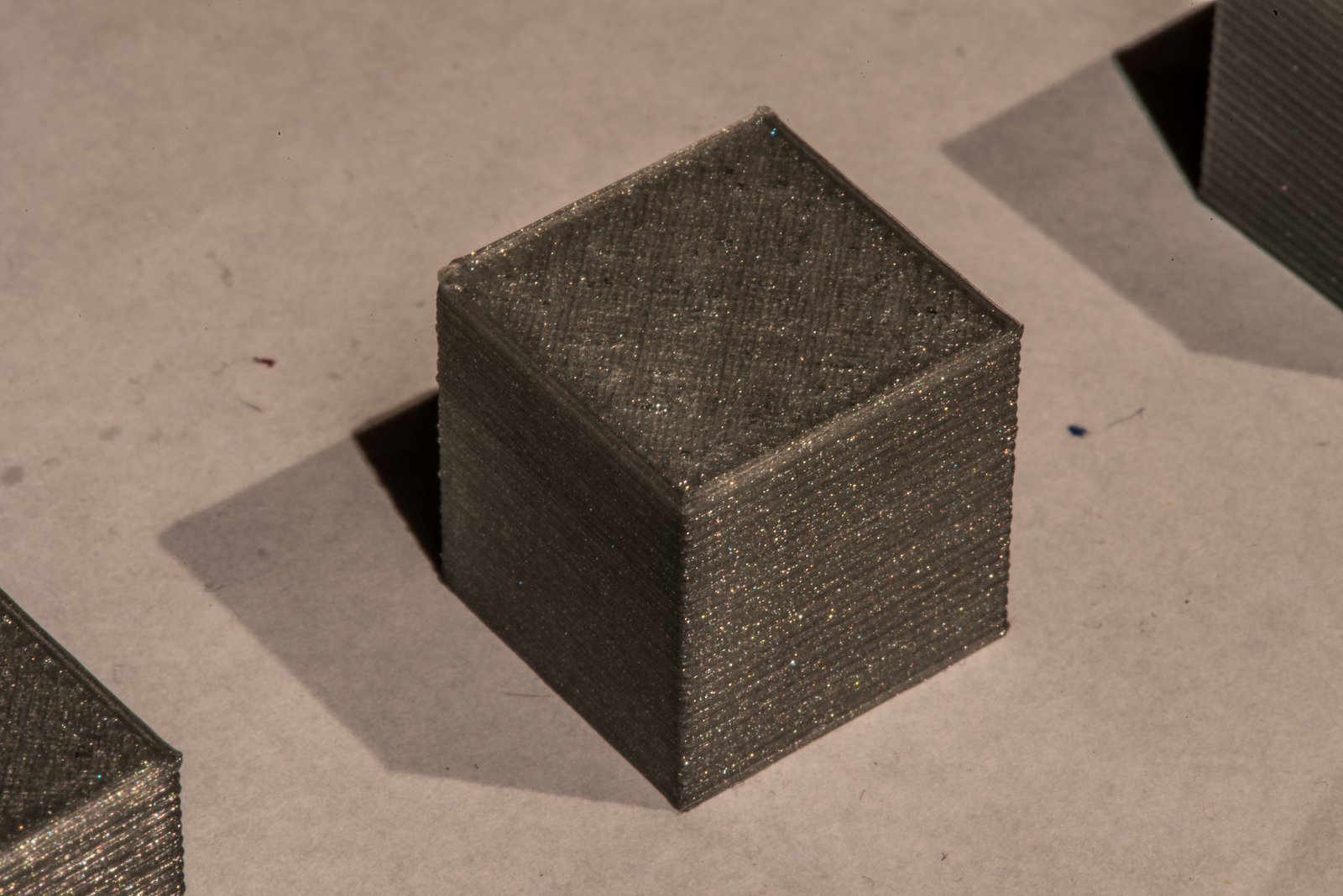

ok…as supposed this lead to z axis wobble…did you print the test cube? How it is? The problem is visible only in some faces or in every face? Pitch of your z screws? (m5, m6, m8?) did you measure the distance between wave tops?(or bottoms) Double check the z-x joints and observe it while the machine is printing
Hi, i’m 90% sure that the problem is with the z axis. i’ve seen this before and it’s can be caused by a few different things.
i looked at the printer in the photo and it appears the z rod is constrained at the top, the first thing i would try is removing that.

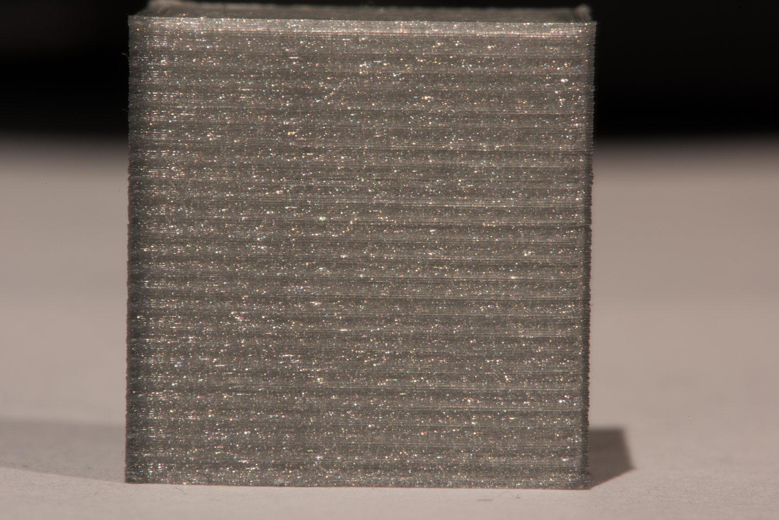

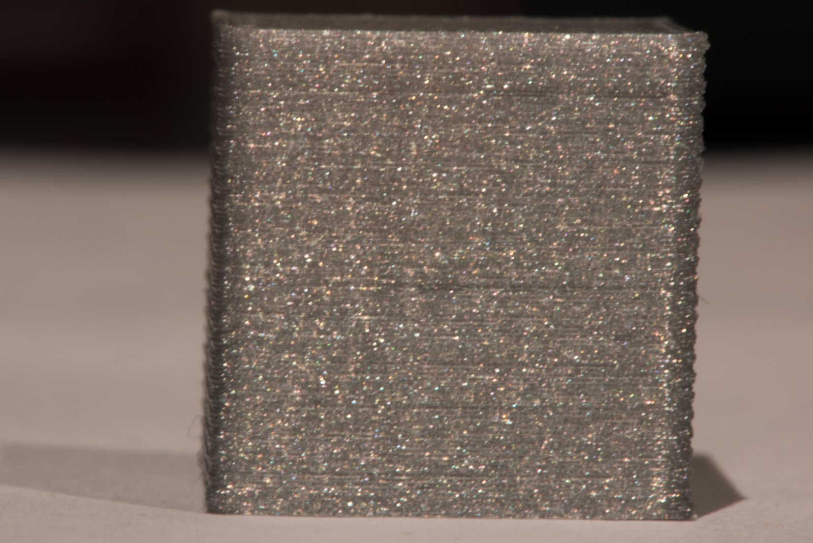

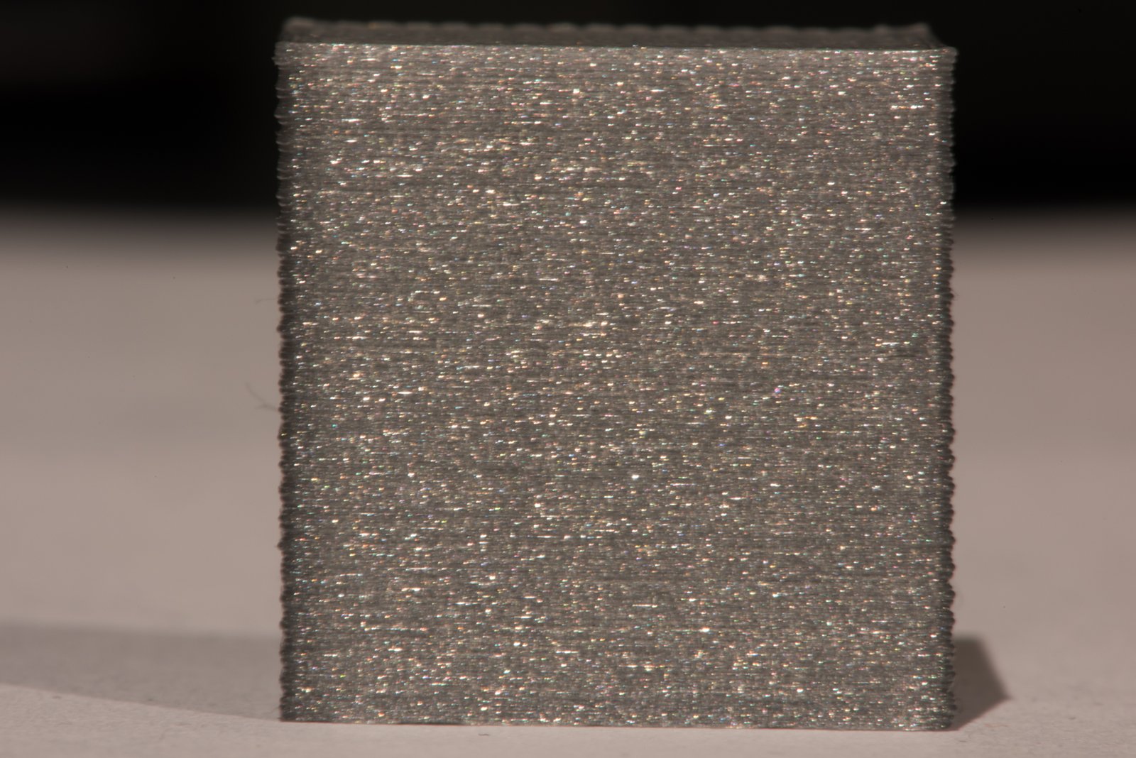

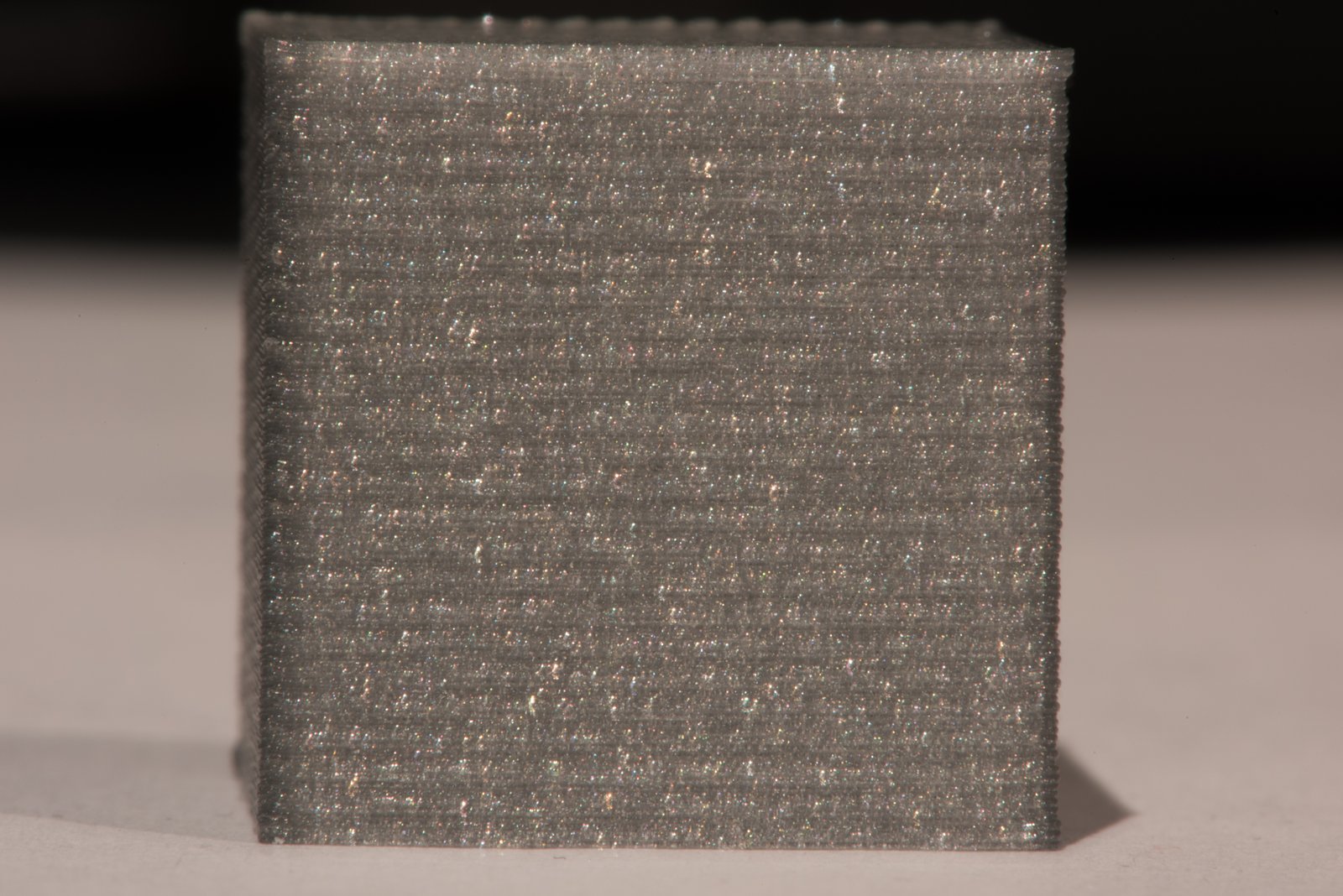

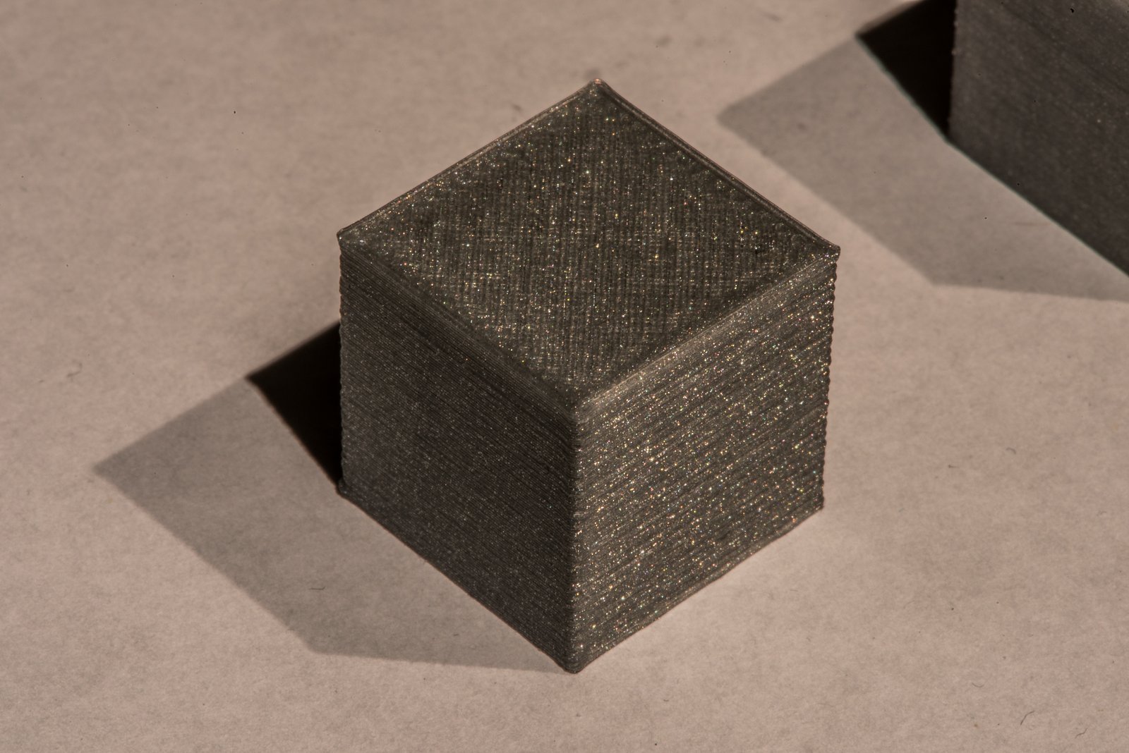

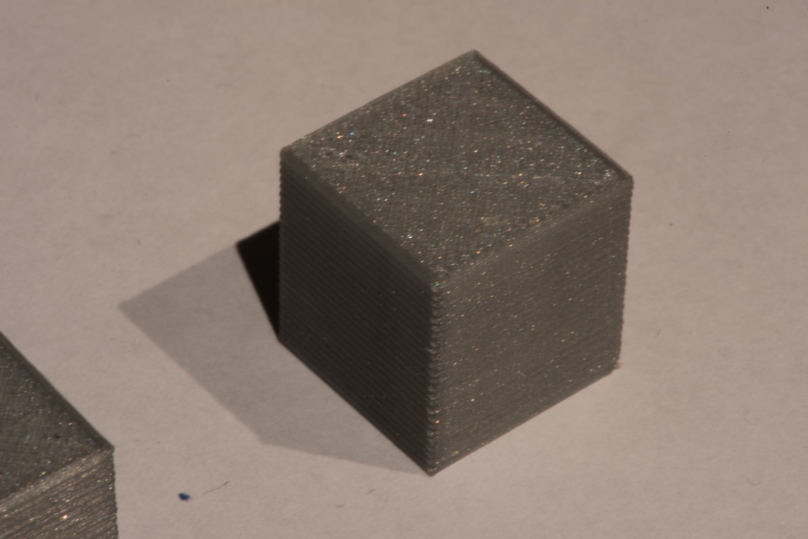

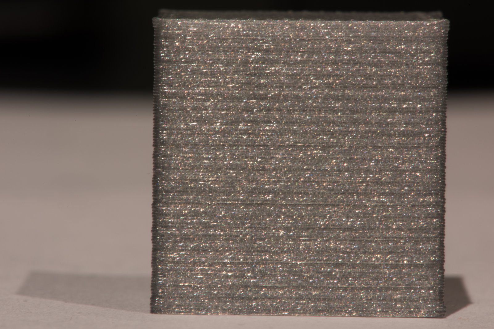

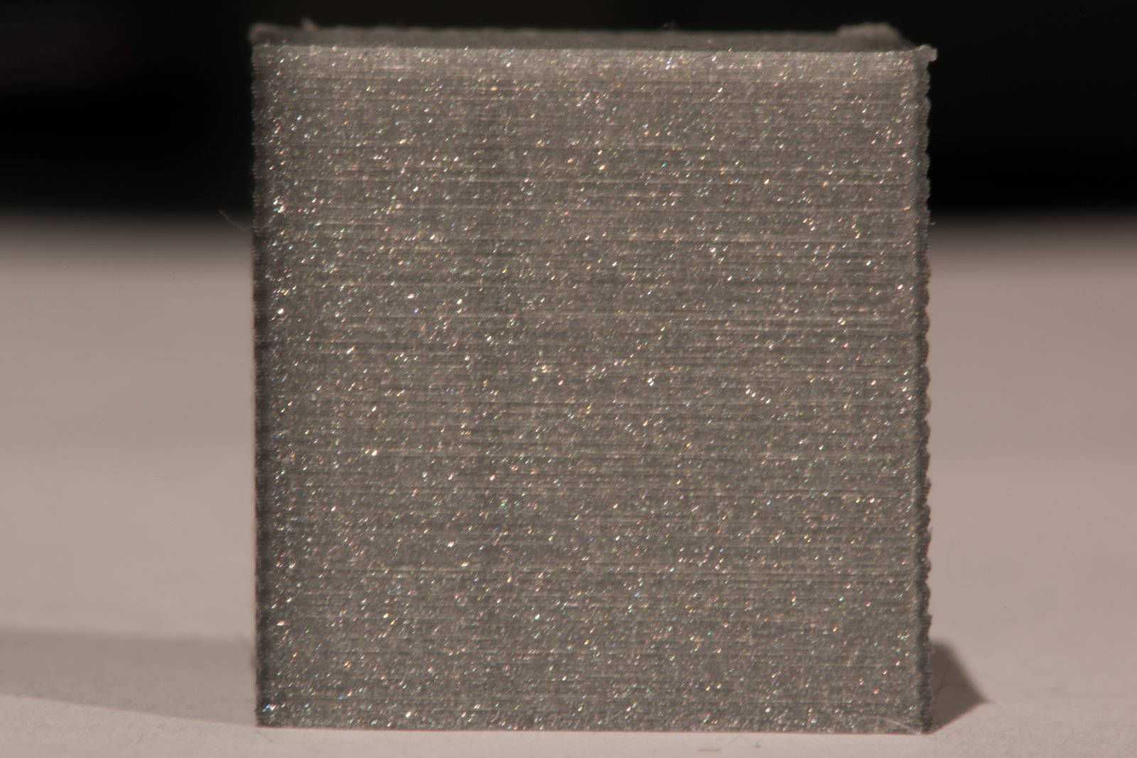

there the photos of the cubes, the first is 0,2, second 0,1, and 0,05 for third, the photo of these fisrst are take on the logical sense print ( y are front, rear, x are lef, right, and z up)
for second serie is front and letf and rear of 0.2 mm cubes and third is for the 0.1mm one

Not to be negative here, but given all the pics, it really seems toi be a hardware issue. On the other hand, it’s always safe to test leads before discarding them

Hi! I agree with Dubbo_3d, and from the pictures it is z-wobble, i haven’t seen the picture of Your printer yesterday…remove z-tops contraints and, depending in your x-ends, apply antiwobble pieces like this http://www.thingiverse.com/thing:141479
