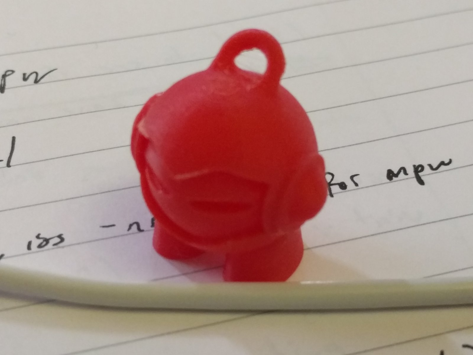

My second printer is a combination between a D-Bot and a Triple C-Bot and because I can’t leave anything alone I have my own modifications as well. The print bed only moves vertically in small increments (your layer height). At speeds that would cause significantly reduced print quality on my gMax, I am getting very smooth prints on the new printer. Plus it has a heated bed. My biggest problem so far has been stringing from using a Bowden setup, but I’ll get that ironed out. Picture attached of a Marvin printed at 80mm/s with 0% infill at 0.1mm layer height printed on the new printer.
Edit: grr, my phone camera won’t focus on the Marvin very well so it’s hard to see just how good the quality is. Plus it’d be nice to see a comparison with one printed on my gMax with similar settings (minus the speed). I’ll see if I can remember to take those photos tonight with a better camera when I get home.
