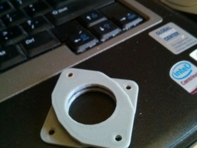

Well i mean out of either the nylon or the carbon fiber HTPLA, because i saw this design on thingiverse and the guy had a point, the astrosyn ones are made of aluminum so they are hard which is what makes them work and i can print the o-ring in the middle with the flex filament. Do you think the nylon or carbon fiber HTPLA would last in there and which one would you choose?
I have not tried any HTPLA nor Nylons so far. Can’t help you with that. Sorry
If you were to try one, which one would you do? I’m thinking the HTPLA because it’s rigid while the nylon is bendable

I bought both
and i do oil my axis i’m at 30mm/sec now and 10mm/s on Z-axis which seems to help some but still vibrating a little. I’m going to see if the dampers i make work. I’ll try with Carbon Fiber HTPLA first

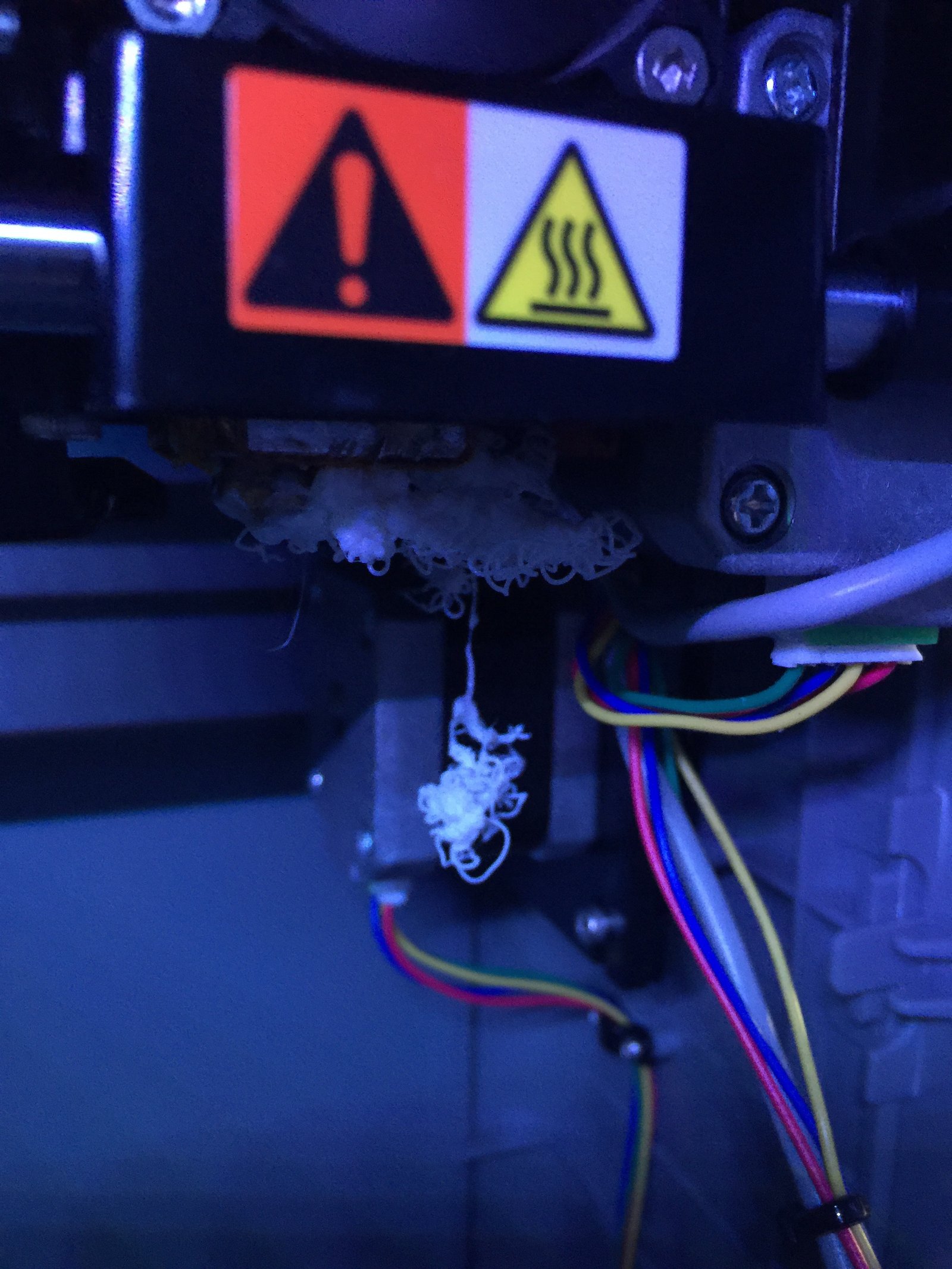

Why does this keep happening? I went from 45 mm/sec to 30 and i’ve gotten this 3 times now on 3d benchy boat model
I guess it was because it was printing too slow and clogged. i went up to 60mm/s and prints are working so far

too late but here is my solution with a headed plate ![]()
